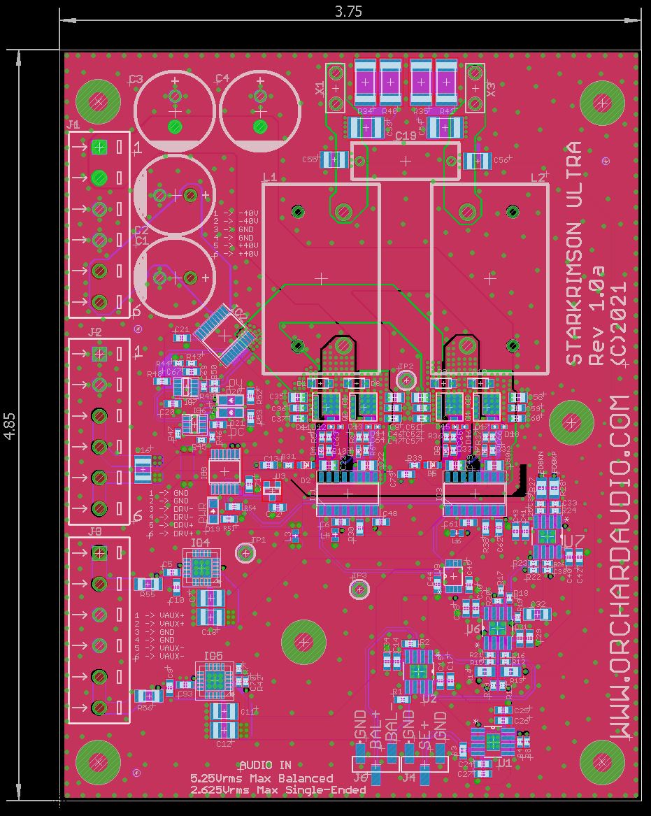

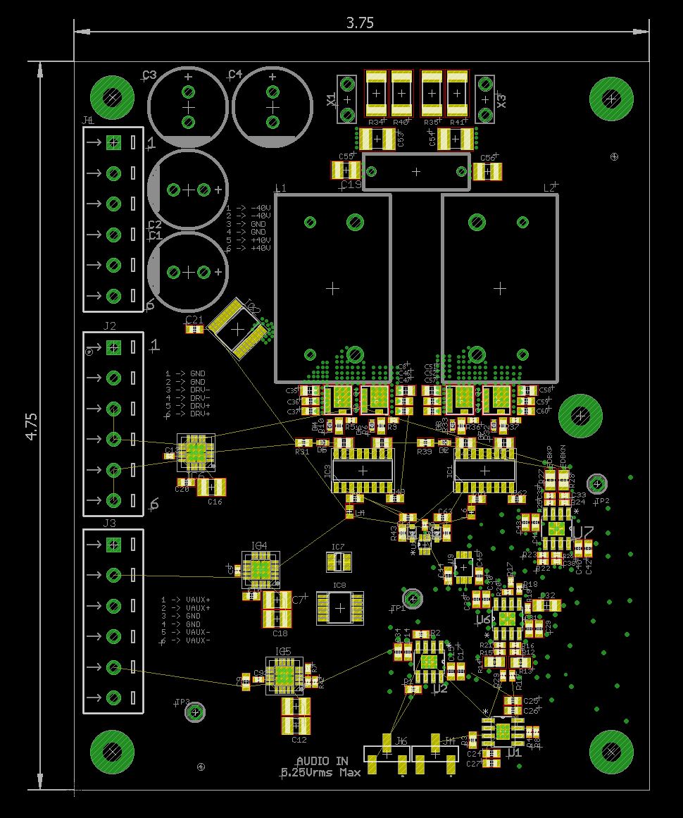

I am currently developing a GaN Class-D module which will do 250W into 8ohms and 500W into 4 ohms.
The module will be 4.75" (120.65mm) by 3.75" (95.25mm). See the attached image.

Update 12/29/2020
The layout is finished...
I had to make the board 4.85 by 3.75 inches to add some additional circuity, due to feedback that I received for the other board.
Added LED to indicate over current
Added LED to indicate overvoltage
Added LED to indicate that board is powered up
Still need to do final checks before manufacturing the boards. However, the layout is at a good point to start getting quotes. So please let me know if you would be interested in getting one or two of these.

906006d1609280179-500w-4ohm-gan-class-modules-starkrimson-ultra-capture-jpg
  • Added LED to indicate over current
  • Added LED to indicate overvoltage
  • Added LED to indicate that board is powered up
