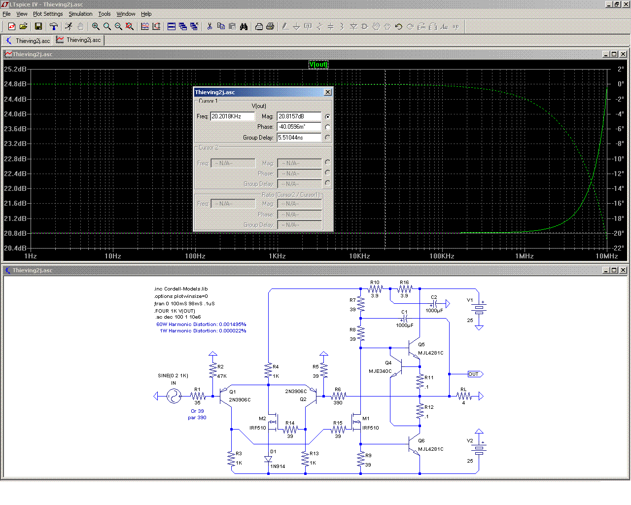

Psycho-acoustic data tend to show that the ear is completely insensitive to phase shift at higher frequencies; in fact, phase shifts needs to reach multiples of 360° to begin to be audible.
In addition, amplifiers utilizing GNFB have very small phase shifts at audio frequencies.
As an example, here is the latest incarnation of Kenpeter's JLH:
At 20KHz, the phase shift is 40 millidegree.
For an airborne sound, this equates to 1.87µm. Could a tweeter be positionned with that accuracy?
