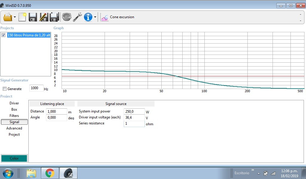

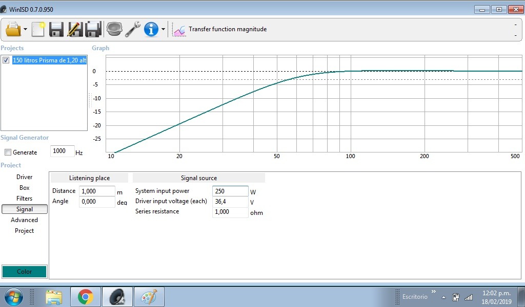

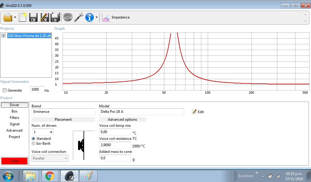

The following graph corresponds to the sealed cabinet ( prism ) that I built, they are
150 litres.
Speaker: Eminence Delta Pro 18A
You can see how the generated Spl (at 1M) drops off sharply from 80hz even though we are applying 250 Watts.
The Dayton Ultimax will have less drop (slightly more SPL in low frequencies), but if you want to "flatten" the curve there are only two solutions (with considerable powers, minimum half the RMS power that the speaker admits to obtain good results) :

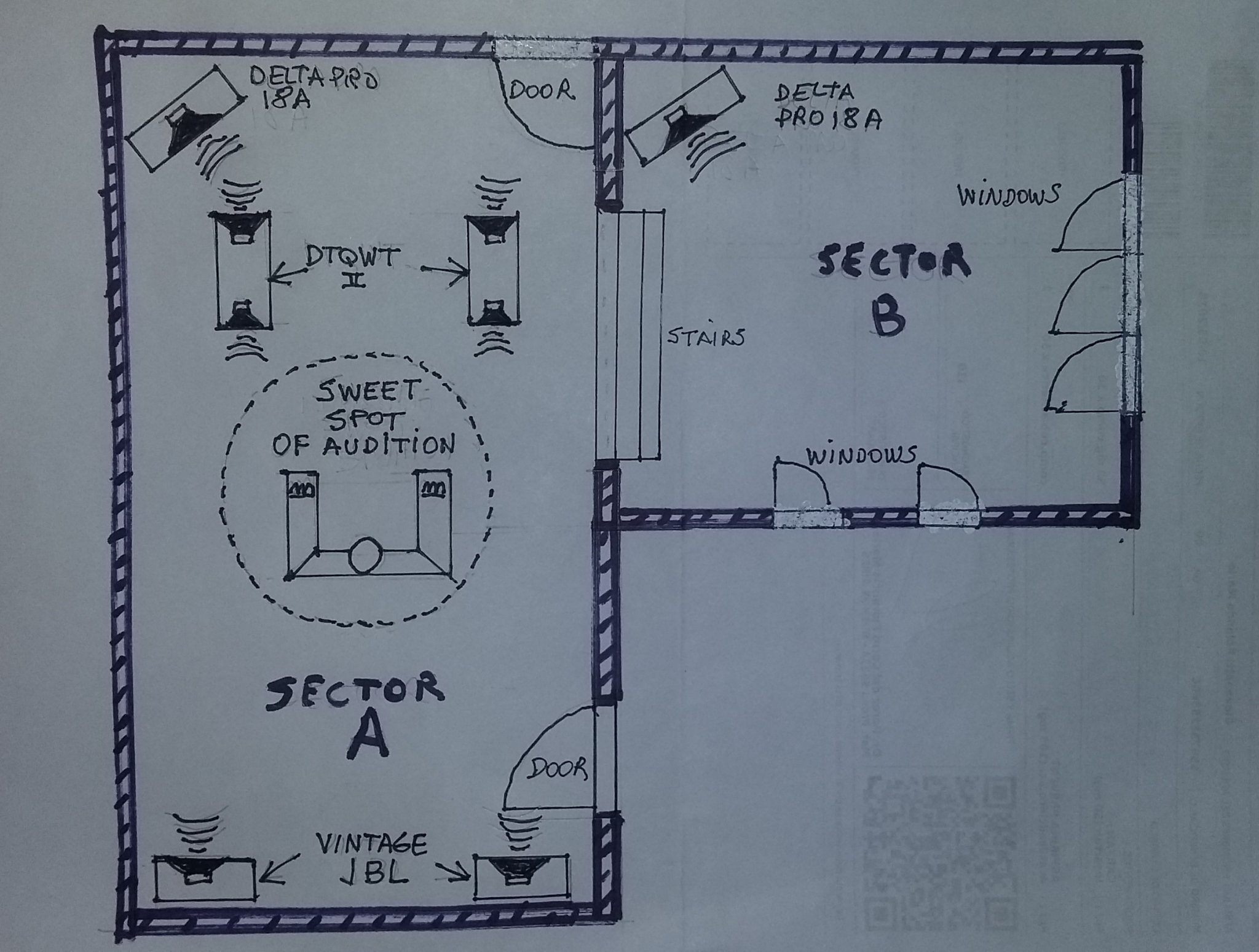

The OP has not mentioned the size of the room, in my case, I have a medium room and open in its longest dimension to another adjoining room, I found 70 watts in two BR cabinets insufficient. I did not do too many tests with the location, due to the impossibility of moving the furniture, etc. So I opted for two sealed in two separate corners of each room. Null points disappeared.
But, at high SPL, the speaker bottomed out (an old JBL) so I went for the sealed ones I mentioned and a Dayton without DSP. 250 Watt mono. But I was not satisfied and went for the stereo, 450 Watts per channel....
But, it's my personal experience, I don't think it's the same as anyone else's because of the atypical room.

Understanding what you say and in general I agree, I will only make a few observations. I already said that I do not intend to evangelize here.
8 to 10 cubic feet is 226/283 liters, doesn't seem ideal for a home cabinet, at least in a cube shape. (that's why I chose a prism design)
Regarding the impedance curve, the Bheringher NX3000D incorporates an impedance compensation circuit. Likewise, with the 250 Watts class AB Dayton and linear source, I did not notice any distortion or clipping either, it comfortably handled the Delta Pro A impedance curve.
With DSP, I apply a boost below F3 (there are several types of curves available, I stayed with Bessel 18 DB/octave) I have tested with a pure tone of 20hz, and also connecting and disconnecting the subwoofers while playing music, ( not necessarily with deep bass ) and well, Bach's Tocatta and Fugue doesn't shake or shake the chest - it depends on the volume - but my ears are happy with what they perceive at normal listening levels as the OP clarifies.
6.7 mm of Xmax is enough, because I don't get to exceed that limit, I have two speakers, it's 3 DB extra without calculating the room gain, and if it did, Xmech is 15 mm.
So, in my case, with my speakers, my amplifier and my room, the two missing octaves are amply covered, I don't need to see the cones move or air blowing, it's not necessary because the music we can hear starts from of 20 Hz. This is a widespread visual illusion, "Hey, look how it moves", a fad for the HT or car audio world.
500 Watts is not a lot of power, I don't see what the problem would be, on the contrary, it is welcome, the Ultimax has a sensitivity of 88.6 SPL/M, and these days class D is powerful, light and cheap. To use 100 Watts, it is not necessary to purchase a speaker designed to handle 1000 Watts RMS.

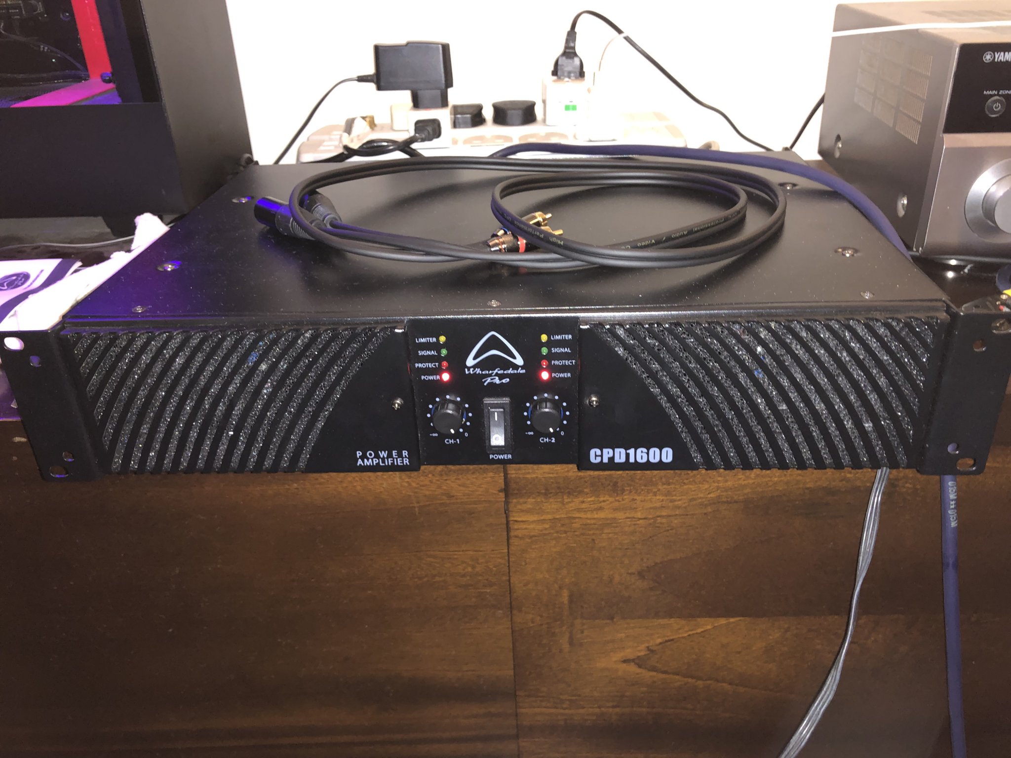

Here's an update for all of you helpful gentlemen! Firstly, many thanks are in order to every single one of you so thank you!
I got one of these, a Wharfedale CPD Pro 1600 brand new! Runs cool and quiet! The used Crown amp was sold the next day so I missed on that opportunity.

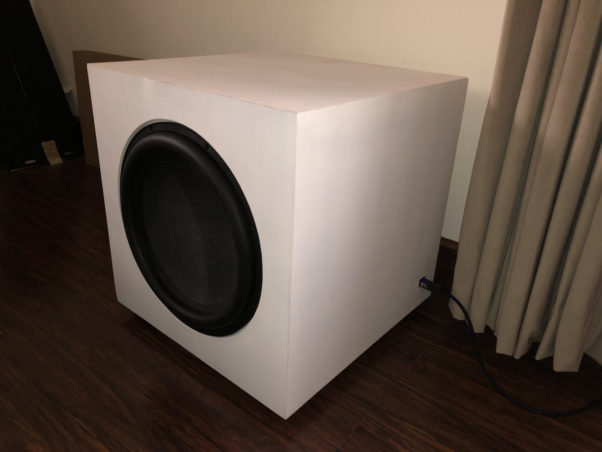

And here's my sub, all completed, a sealed cabinet with about 5.5 cu ft. net internal volume. Went with speakon connectors, which btw are great!
I have a few questions!
(1) Which mounting screws (cap head ones) from parts express are the correct one for these? I just used some wood screws and they work ok but not great.
(2) My room response is all over the place from 30-70 hz. Goes down and then back up by 10-15 dB every 7-12 hz. What can I do to remedy this, room treatment?
(3) There is no audible response below 30 hz, is that a given with a sealed design? Or have I messed something up? Above 30 the response is unbelievably strong and since this is my first sub I can't believe how some of you listen at 100+ decibels lol.
edit: Room is 18x14x10, sub is in the middle of one of the long walls if that helps.
