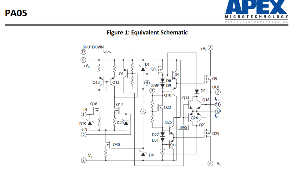

speaker said:Has anyone tried them on audio applications?
Haven't tried the high power modes like the PA-05 but I've been using the PA-02 and the PA-16 for quite a few years. I love 'em. They are a bit pricey though.

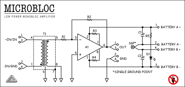

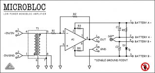

They're a power opamp so they can be used in most any of the various chip amp/Gainclone circuits. The only additional parts would be the two current sense resistors.
The amps I currently have built are just a simple inverting amp with a gain of 10 (input resistor of 10k and feedback resistor of 100k), 0.12 ohm current sense resistors and a Jensen JT-11P-1 input transformer on the front.
Don't worry about the extra pins I have labled for the intput and output. I use four pin Redel connectors on my stuff so that's why I drew the schematic that way.

jasonc said:Steve, could you please post a design?
se
