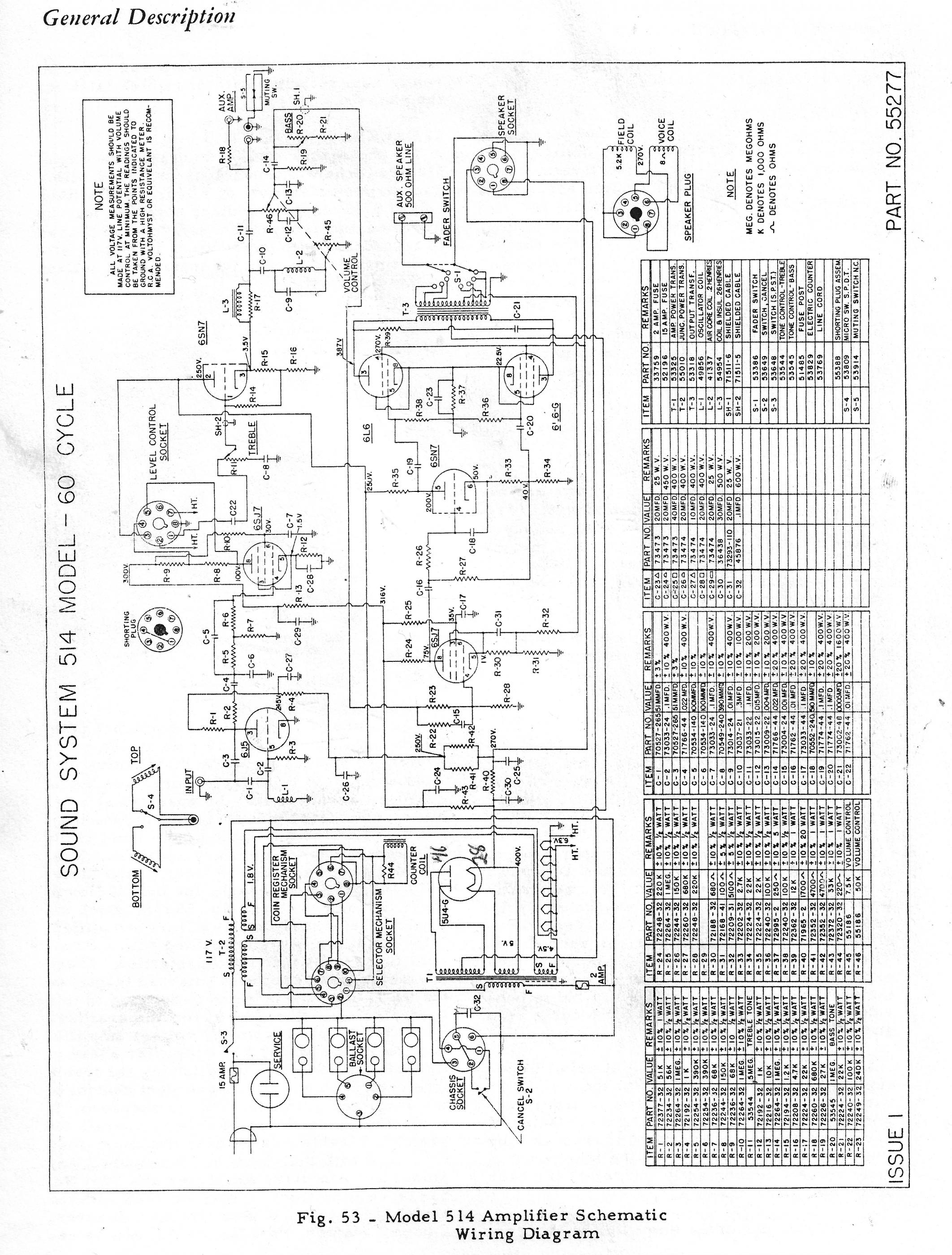

Hi! I have a Wurlitzer 1400 Jukebox which uses a 514 tube amplifier. In addition to driving the internal 8ohm speaker, there is also a two-screw terminal strip to allow connection of external speakers. This output is labeled “Aux Speakers 500 ohm Line”. There is also a “fader” rotary switch that the manual explains allows the output to be balanced between the internal and aux speakers. The manual explains that the aux speakers should use line transformers to convert from the 500ohms to the individual speaker impedance.
I know that there are constant voltage speakers that are typically rated at 25, 70.7, or 100 volts. But there is no reference in the manual to constant voltage or any of these voltage levels. Does the 500 ohms imply one of these voltages, or is the 500 ohm output something completely different? I can find a lot of info about constant voltage speakers, but no references to 500 ohm outputs.

Thanks - yup, I appreciate how the constant voltage system works and understand that there are various standards that have been used (100v, 70v, 25v), but I was wondering if my "500 ohm line" output necessarily corresponded to one of these standards (or perhaps some other pre-standard value).
I guess I could input a sine wave and crank the amp up to max and measure the Vrms output at these terminals with the fader set to different settings, but I was hoping that it would be obvious (to someone else!).
Oh, and I attached the schematic for the amp.

Ah ! now that schematic explains it all this is "old school " working by that I mean early 1930,s tube radio working of which I have repaired 100,s of that type .
I have even now an original 1930,s extension house speaker using this method .
As the internal jukebox speaker is standard operation the external ones are FIELD-COIL speakers that means they are energized by a high voltage coil instead of a permanent magnet speaker while still retaining a low impedance voice coil.

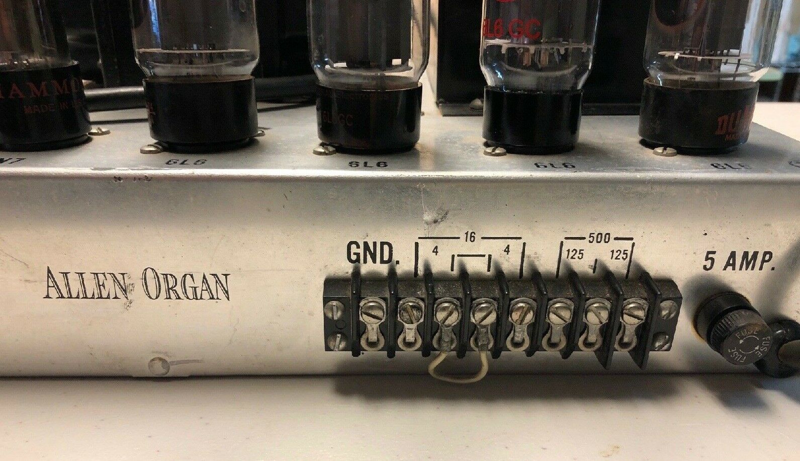

Thanks Brice for the info on 500 ohm speaker winding's of organ amplifiers.

Thanks Burnedfingers - yeah, for this amp it uses a fader switch to select how much power goes to the internal 8ohm speaker and how much goes to the 500ohm out. The schematic is attached a few posts back. It's still not clear to me how all this is really supposed to work (see my post #12). The manual for this jukebox provides part numbers for line transformers that enable either 8 or 4 ohm external speakers, but doesn't provide any specs on them nor can I find any references to these part numbers on line (it's a 1952 jukebox). So, I don't really know what type of transformers they are.
It looks to me like its probably 70 volt transformers. Generally 25 volt are used in something like a school intercom system. So it lists several transformers one for a speaker with a 4 ohm voice coil and a different one for a speaker with a 8 ohm voice coil.
