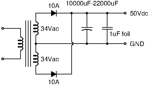

A 34V-0-34V transformer can be used with a single diode from each 34V terminal to form a power supply giving close to 50V. Make sure that the voltage does not exceed the maximum voltage of the amplifier board even when idle and with a maximum transformer input voltage. If the power of the transformer is sufficient I cannot tell you without knowing the "VA" of the transformer.
The amplifier is asking for single (vcc and gnd). So what ever I'm getting after adding capacitor (x1.41) that is not real voltage? And should not harm to my system? Thanks you for your's reply guys.
As long as the supply voltage at no moment exceeds the maximum supply voltage the amplifier board can handle, the amplifier board will not be harmed by the supply voltage. The question that remains is how stable the supply voltage will be and that depends on the power capacity of the transformer ("VA"). Could you eventually post a photo of the transformer label giving the specifications?
I propose this coupling of the transformer.
It is effectively full-wave rectification but for a single output voltage from symmetrical secondary windings. The windings are conducting alternately such that you have less than 400VA at your disposal. Each winding has 200VA and that coupling will leave a power in-between 200VA and 400VA.
It is still enough for your amplifier as long as you use 8 Ohm speakers.

If you only use 8 Ohm loads, it is likely to really deliver 2x120W, and a 270VA transformer will be fine, especially for UN-clipped speech/music.
