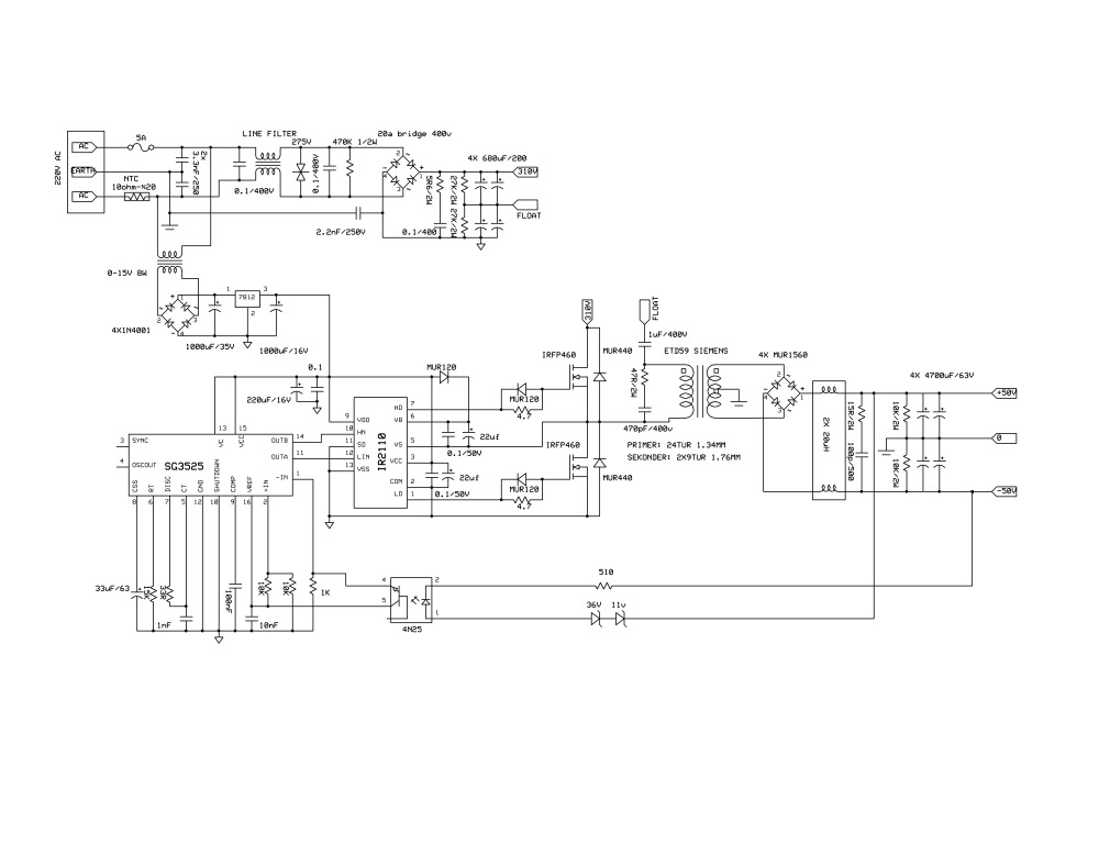

hi guys...can i put instead of etd59 3 ei33 or more?...if yes...what power can i get with those?
well yes, I guess you can, if each transformer can be made to work with your specs.
the power would be in the area of power of one core times how many core you would have

2x35V/5A SMPS supply !?
Hi all ! 🙂
Very interesting topic, so please help me!?
I need a SMPS supply 2x35V/5A (project) for the audio amplifier with TDA7294/4om.

may be you can try this, it works great. I have modified this design for +-70 and tested on a 400watts amp whihout much heating. You may be required to decrease the no. turns and gauge according to your requirement

Why modified this design for + /-70V, i need + /-35V for an amplifier with TDA7294!?may be you can try this, it works great. I have modified this design for +-70 and tested on a 400watts amp whihout much heating. You may be required to decrease the no. turns and gauge according to your requirement

SMPS should be submitted well-known amplifier with TDA7294 (stereo 2x100W/4om!?), No problem!

so, that means you need a readymade one with all calculations already done, right?
further, do you require a 220vac to +-35v or 12vdc to +-35v.
It takes mixing 220....230Vac/2x35Vdc SMPS with Stereo Hi-Fi Amplifier with TDA7294/4om!😕🙄so, that means you need a readymade one with all calculations already done, right?
thanks and cheers !!
let me explain what I wanted to say:
all it takes, bare minimum to do is, to change feedback resistors on SAME design. Now I know of several here that can be used and change to any specs you want, including my own

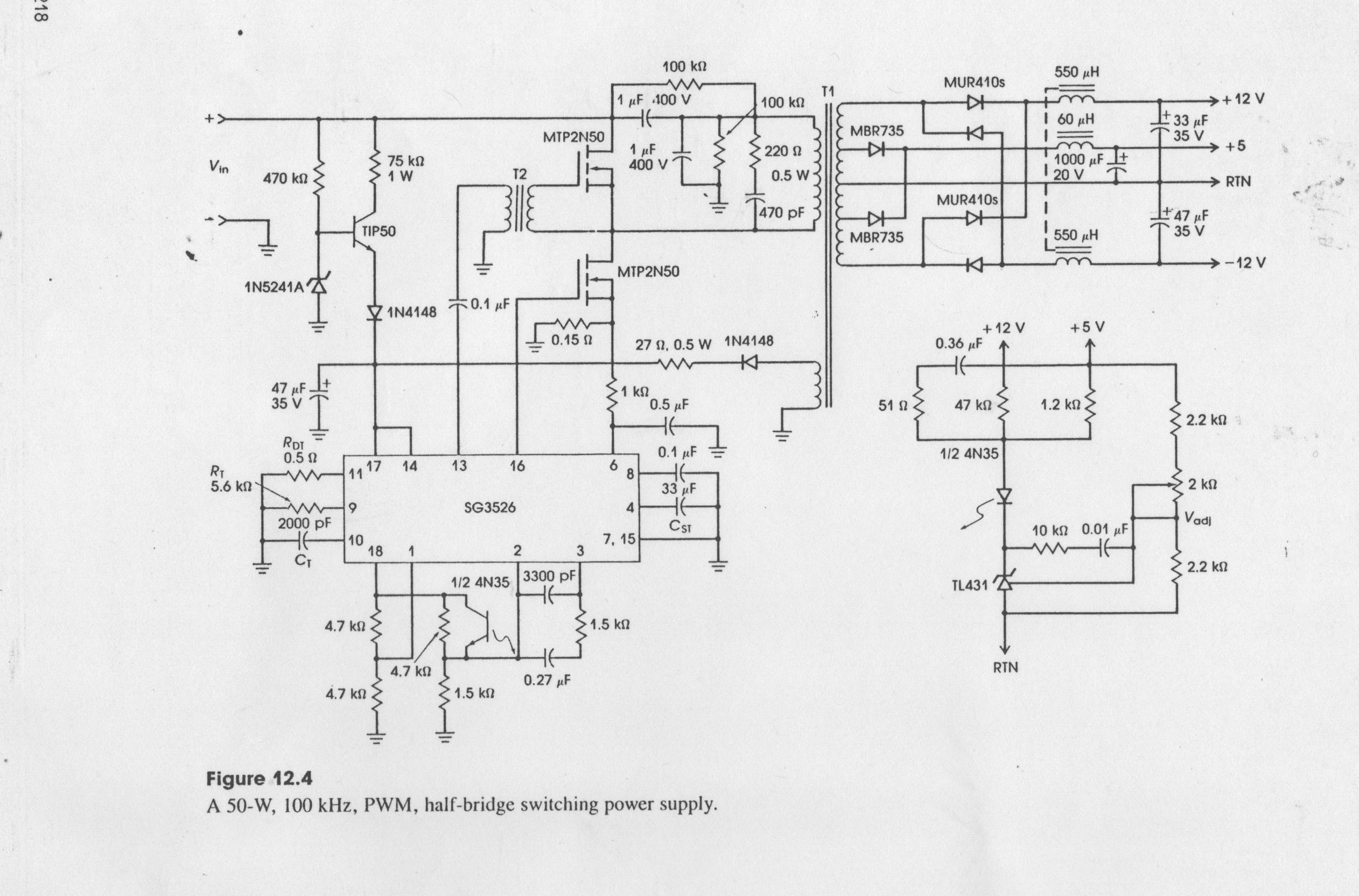

Using Bootstrap Start-Up saves one transformer
SMPS supplies often used to employ a large power resistor and a zener to provide the (eg 12V) for the electronics during start-up. Once the PSU was running, the 12V was supplied by an auxilliary winding on the output transformer. As the resistor only had to provide power for a few cycles it never really got hot.
Good effort. Keep it up.
Next time try to avoid linear transformer in smps circuit.
Feed back process is good.
