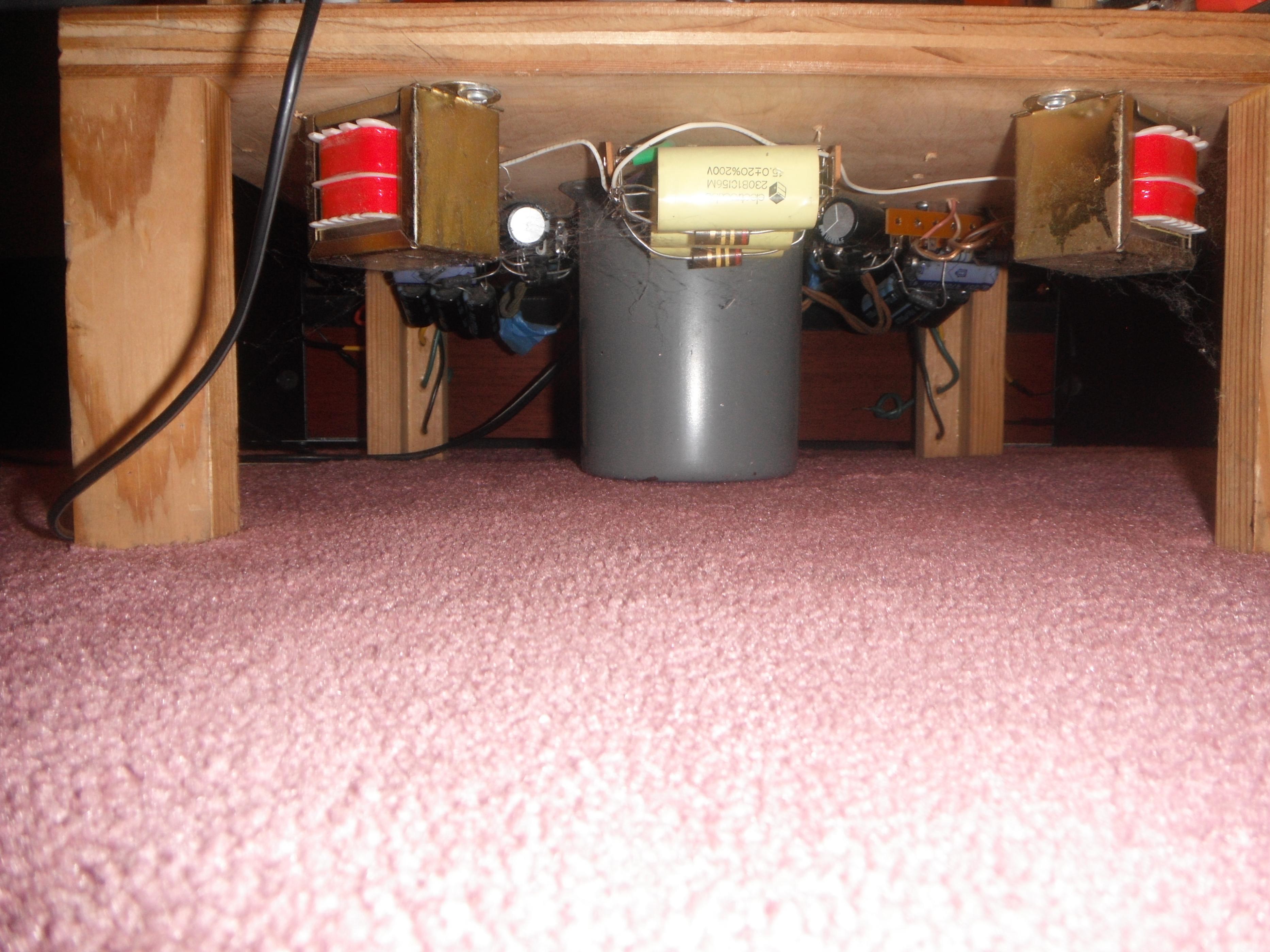

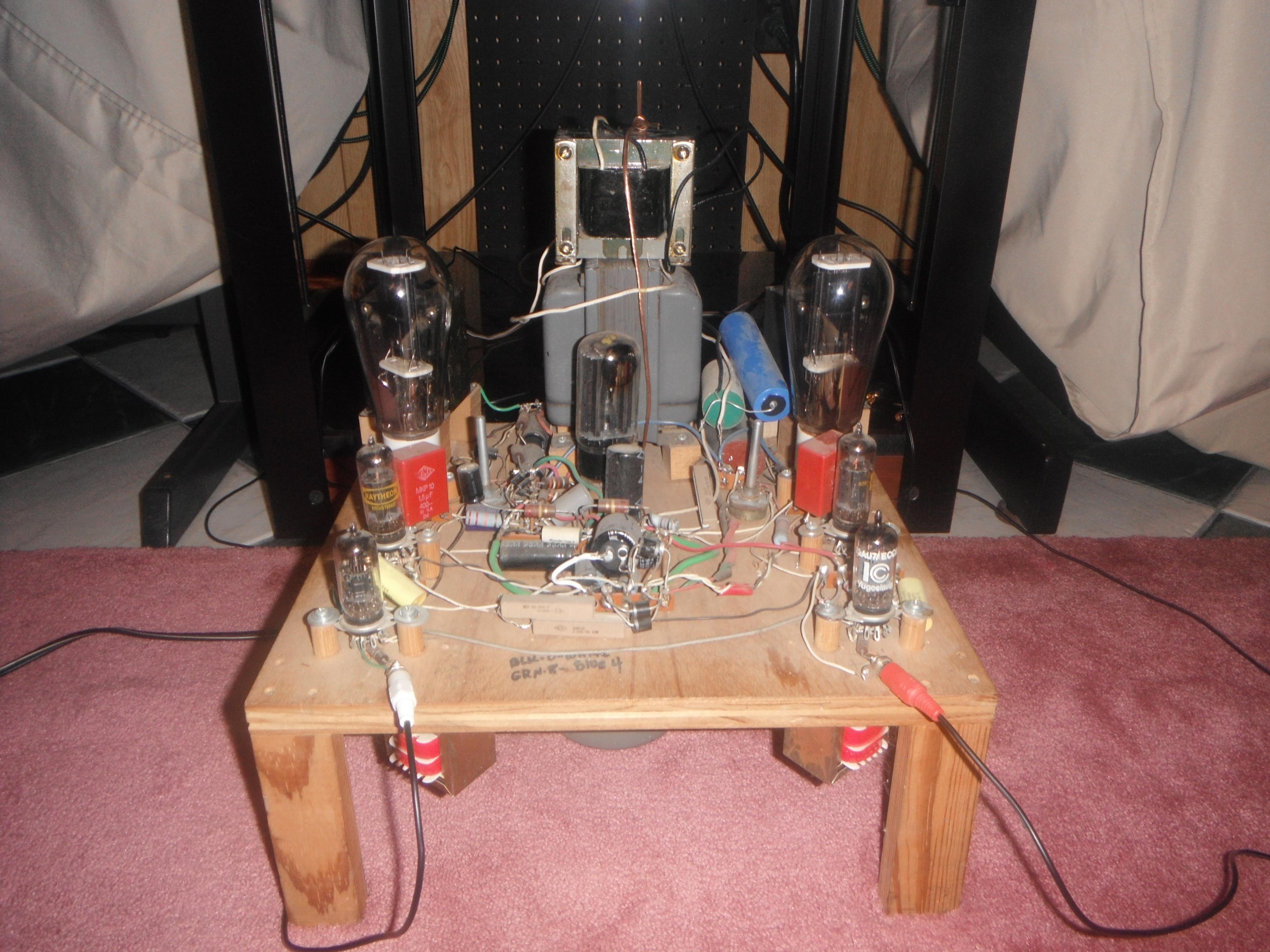

I take it you don't have any catsThought I would share this with you since you were kind enough to reply.

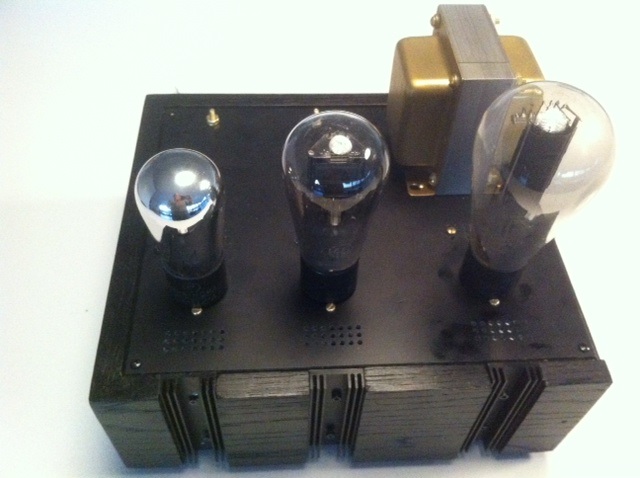

I have just finished two stereo SE 50 amps, the second of which will get first power today. Here's a link to a quick cell phone photo of the first one playing (sorry for the poor quality, I'll get some porn shots up soon). http://Imgur.com/hGoWzHD
It has a Newcomb TR-100 or TR-91 input transformer, type 56 triode, Lundahl LL1660 IST, 50 triode and Hashimoto OPT. it has twin 5U4 rectifiers and oil and motor run caps. I have a pair of EML50s as well as some pairs of vintage 50s. The amp sounds amazing. I don't ever want to stop listening I can't hear a difference between the EMLs and vintage tubes. The EMLs are extremely well-built, like all of their products.

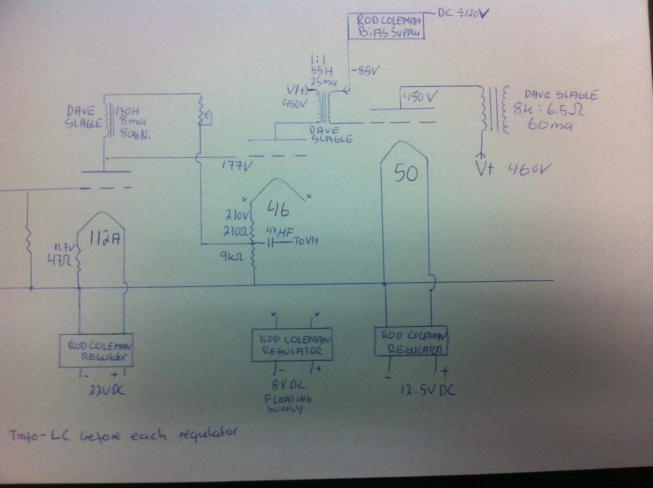

Here it is. Please excuse me for hand drawing. I have not learnt to draw on my computer....
Each filament supply has its own transformer. lc supply where the l is lundahl 2733: This choke can be made with gap for different currents .
The Coleman regulator is well known, the Coleman bias supply
is quite new , very promising, highly recommended.
Same goes for Daves Irons: excellent stuff!

So far the psu is a shunt regulated supply
borrowed from Stephie :
Tube Based Voltage Regulators - Part 5
the one with multiple controll tubes.
I am rather curious about psus, and I am making a choke input supply for comparission with the shunt regulated
(Actually it will be lc-lc-lc for output tube, and lc-lc-lc for driver input tube)
The currents in each rail allows the use of plate chokes which have rather high inductance. I am curious to see how this kind of psu behaves.
