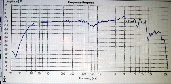

The response is actually amazingly flat compared to my old speakers. I've been doing some more controlled tests and I think what I detect for the treble and highs is resonance and reflections and phase stuff from my small room. I don't think there is much difference at all for pure response.
The bass begins to become audible at 52Hz. You are right, any peaking is somewhere around 120Hz, but it seems more like a phase difference between the sides of my head than anything (I sit at a right angle to the speakers on my computer...). The rectification frequency in any amp is at precisely this frequency, so the amp may have some affect too. (wait, I think my car amp uses a switching supply...)
- keantoken
this fr response is what I got on betsy-wow

Is this strange?
As I increase the series resistor, the response around 174Hz dips, instead of peaking. This is a spread out dip, between C3 and C4 (130Hz to 261Hz). This has the effect of seeming to drain the life out of music if it's strong with a large series resistor, since it cuts out the lower midrange. From here it gets louder rather steadily with increasing frequency. Shouldn't the response peak instead of dip?

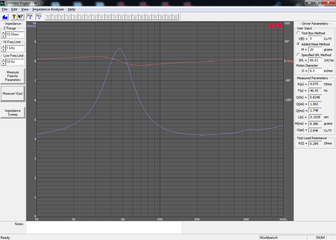

I'm not sure what to do now:
Was expecting low QTS suitable for Karlson loaded project...
Might have received open baffle Betsy (without the K)?
Its a nice speaker. Can still use for something, I suppose...
Just maybe not for same plan as I had originally posted.
Sais "Betsy" on both the box and the magnet...
And QTS measures 0.8 as-if optimized for an open baffle.
Kean said something about adding a series resistor before
his open baffle sounded right? Maybe he got my low QTS
K's? They were both ordered and paid on the same check.
Kean, what yours say on the magnet? Was there a sticker?
This was after about 10 min breakin at very low volume...
Just using WT3 tester itself to play some music in Mono.
Measurements made in fee air (very hot and humid), and
with 20g non-magnetic weight added (4 US Nickle coins).

I got OB Betsy with thin magnet, bumped back plate, and vent hole.
Fairly sure of it now... Though I still wonder which type Kean got?
Can't fathom Kean's preference for series resistor if his OB Betsy has
the same curves as what I just measured? If BetsyK, would explain.
I suspect shipments (I ordered and paid for both) got wires crossed.
Not certain I can use 0.8Qts for my 3rdK12 project? Unless I don't
use fullrange, but cross down to 1955RE Karlson K15 (overstuffed
with SigmaPro18) at some frequency well above Betsy's Q peak.
Even then, I doubt 90db sensitivity is useful matched against 97db.
How much could I boost Betsy's effective sensitivity, tightly cupping
the back? I mean, if I was to intentionally cut off all the low end and
send Fs and Q skyrocketing, but cross to 18 well above that mess...
Compare Alpha-8 against Alpha-8MRA, I think the closed basket is the
only major difference? But the sensitivity went way up as the low end
of useful bandwidth got whacked... Would it be the same on Betsy?

Ken,
I was thinking you wanted the Betsys, but now I remember the Karlson project. I'm sure I just goofed up. You indeed did get the Betsys, so the Qts you measured is dead on. If you and Keantoken want to trade, I sure wouldn't complain. Otherwise, email me and we'll work something out. I've got K's I could send you ASAP. Either way, I owe one of you a new BetsyK. I'm not sure what happened to that one in shipping. The cone shows a little damage, and I'm not incredibly comfortable with that. I've never lost one in shipping before. My packaging isn't fancy, but it has proven to be highly cost effective. Let me know where to ship the replacement BetsyK.
