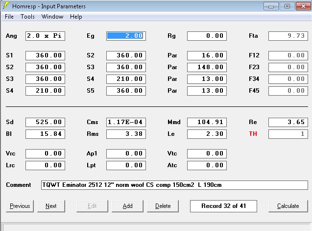

That's pretty similar to what I came up with for a TQWT for the 12" eminator, which turned out to be the same as a the vented box. But I had a ~400cm2 area, which seemed like it would work in a simple fold, roughly 20x20x15 overall.
That sounds kind of weird for a TQWT. Mouth size usually decreases as you go from TH->TP->TQWT. What are the rest of the HornResp parameters in your model?
Trying to shoe-horn the driver into the smallest 1/4L model though kinda negates some of the advantages of using this type of alignment. Do you know you can probably get down to 30 Hz at around 96dB/2.83V/1M with this driver? You'll need to use a 200L box though 🙂

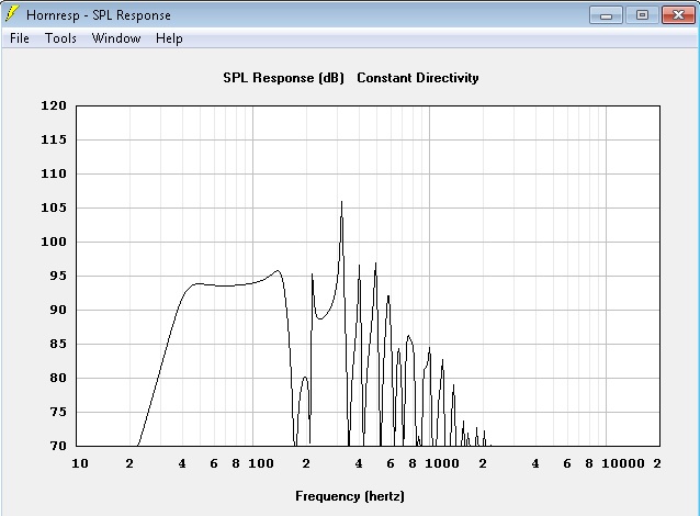

Here you go.....I adjusted my voltage to 2v for the nominal 1w on 4 ohms and get about 94 db. It was actually 360cm2 that I was working with, or 14x4". The s4 is reduced to compensate for the approximate cross section of the woofer at the mouth. A ported box of the same size sim's almost identical.
Unless the program you're using for box modelling allows you to do the same adjustment for the vented alignment you're looking at, I suggest not doing this. Alternatively, use HornResp to model the vented alignment as well, so you can compare them directly in the same program.
Interesting idea though, putting in a "pinch" at S3 to reflect the effect of the driver on the cross-sectional area around there.
The mounting depth for the 2512 is 5.6", so that's not probably going to work out too well if you're planning to just bolt the driver to one side of the mouth. However, with 360 cm^2 available at S2, it might be possible to come up with a creative way of squeezing the driver in (e.g. magnet facing into S2, and mounting rings used at S3 to raise the driver up an inch or two so the magnet stands clear of the wall).

I took the volume of the driver and used the equation for a volume of a cone to back calculate the approximate cross section of the driver, then subtracted from s4 in the sims. I think it's about as accurate as you can get.
I used hornresp to sim the BR also at 2pi and same voltage, and got shockingly similar results.

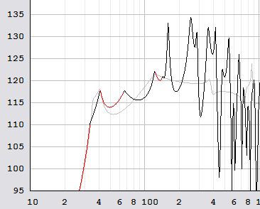

FWIW, compared it at 250 W to a BR of the same net Vb using a sufficiently large 6" dia. vent:
GM
GM
