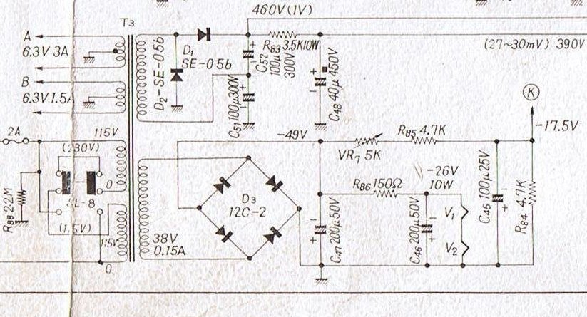

I have continuous problem (or may be not a problem at all) - a very small level of 50/60Hz hum from 7189a push-pull tube amp (28W RMS). It is present even if sound volume pot is at zero point.
On 8-ohm load, its level is 0.003 and 0.009 V, it is audible if I put my ear right on the front of 36sm woofer (with 98 dB/W/m sensitivity).
However, with headphones it is more audible, I can clearly recognize it during pauses. Hum does not change under any circumstances, so it is clearly come from power supply or filament circuit. Phono pre-amp filament is filtered DC (and tubes themselves are covered with grounded metal screens), all other standard, straight from the 6/12V PS transformer. Voltage and idle current of all tubes is in norm.
High-voltage power supply consist of voltage doubler - 2 x fast recovery Vishay BY500 800V/5A diodes, 2x560 ukf Epcos caps connected in series (like in all voltage doublers), + 1 x 100 ukf Panasonic cap right after 450V and ground. There is no room for any filter choke, unfortunately.

Again even though youv'e mentioned it, make sure the output tubes are taking similiar I quiescent currents esp important with fixed bias operation. If not the o/p tranny winding won't cancel the unbalanced 100Hz ripple and it will peter through to the output. This happens in alot of cases. :att'n: How much 100Hz ripple do you have on the raw B+ ? Be VERY careful how you go about measuring this.
Voltage doubler implies double the current spikes and poor circuit earthing will increase noise and can be hard to eliminate. Make sure the input circuitry grounding is well away from power sections and the power sections is substantially sized.

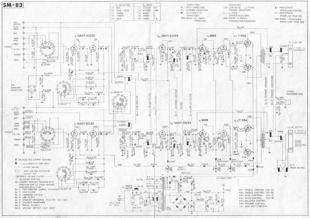

Thanks a LOT for so many hints. This is not exactly DIY amp, it is Pioneer SM-83 being completely restored by myself.
1) Hum is not caused by output tube mismatch (I have chosen matched pairs by myself measuring idle current). I have removed 6AN8 amp/inverter and hum is gone. Additionally, I took off all 12AX7 (with 6AN8 and output tubes still installed), and hum remained. So culprit is clear - 6AN8 (rolling another NOS 6AN8 have not eliminated hum). I have double checked cold soldered joints - nope, everything is fine.
2) I cannot install 10 Hn choke - there is no physical space for it. I installed small 680 mH toroidal choke - no changes at all in hum level.
3) Does not looks like it is cable grounding issue - moving hand over cables do not changes hum level.
4) Volume pot (NOS vintage Marantz) is screwed into heavy metal chassis.
It's very, very small. Parts of choke must be Ш & I /like output transf./. There is very big
anode current and the filtering must be very strong!! R 83 doesn't
enough !

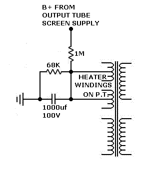

Since you describe hum and not buzz, there's something you can do that might help - see those grounded centre taps on the 6.3VAC windings? Lift that centre tap and make a voltage divider and tie them at about +35 to 40V above ground. Then bypass that to ground via 2.2uF or larger electrolytic (not critical, just for HF noise bypass).
'Tis a trick I use to knock the hum levels down up to 20dB ;)

Hum getting in at the concertina phasesplitter stage ? Can't be ruled out as the triode cathode is about 100V + above the heater potential. leakage is possibility. As Geek mentions lift the heater off earth but don't over stretch the voltage otherwise the pentode will complain.
Since the amount of hum is low level but irritable,
Check the condition of the B+ 47uF 450V electrolytic cap (C???); which decouples the 47K's connecting to 6AN8 triode anodes The concertina anode has a poor (CMRR) ripple rejection and a good electrolytic is required at this point. Same goes for the 2K2 feed resistor (R??) .
Originally posted by azazello It's very, very small. Parts of choke must be ( & I /like output transf./. There is very big anode current and the filtering must be very strong!! R 83 doesn't enough !
Can you please posy an URL to such choke? All I have seen have been either very small or just too big, there almost no space inside this SM-83. Thanks.
Cheers!
Hmmm, since English is not my native tongue I do not know the difference between hum and buzz. Only I can say is ONLY low-freq, no high-freq coloration.
You advice something like shown below ?
I have replaced 6AN8 with another one 100% unused before, hum remains. As for caps, they are all new Panasonic. The caps in voltage doubler are 560 ukf instead of 100, so even if one cap would have gone bad, it should not cause hum.
Yup, you describe hum correctly.
That circuit is the ticket! :D
I don't know your B+, so can't confirm the resistor values.
With resistors of that size, it's a good idea to keep the electrolytic under 47uF, otherwise it will take forever for the voltage to come up.
