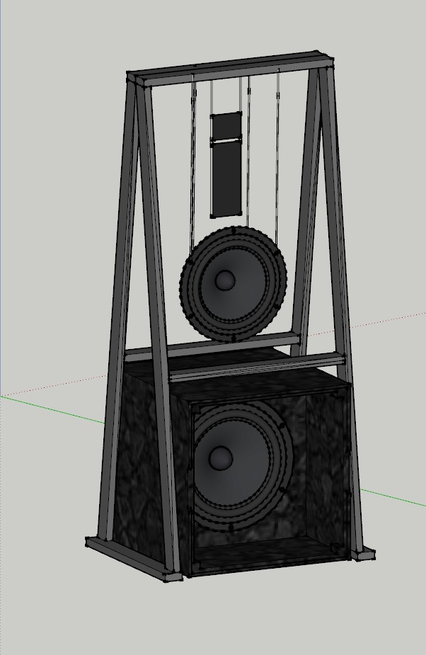

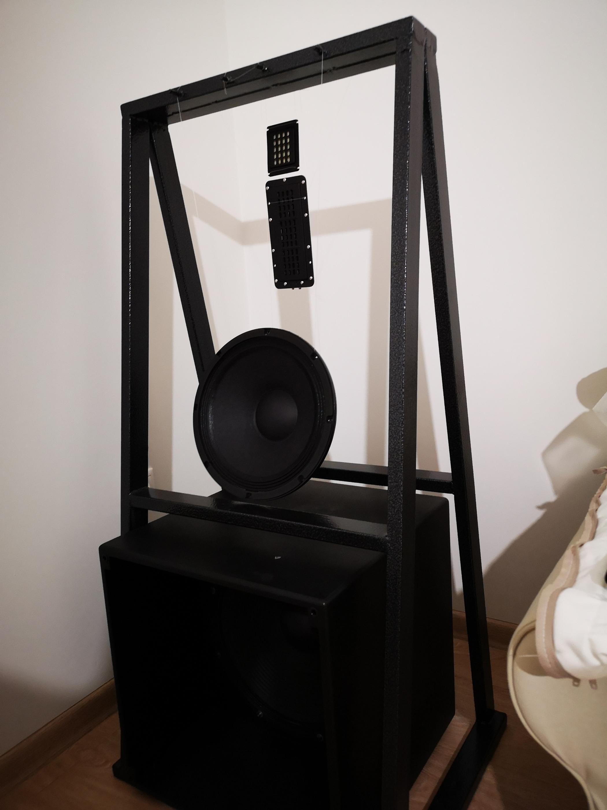

I chose metal because i hate (nor have any talent) working with wood and i have a friend who soldiered those metal parts according to the plan i made in SketchUp. Metal is hollow, but filled with sand so it doesn't resonate.
Can't see any reason why driver hung from the ceiling won't work. IIRC, someone here tried this - try searching the forum. Doubtful about boxed subs (maybe this will minimize floor rattle?), but for nude dipoles - why not?
As for QTS of the driver - yeah, the general rule of thumb among the OB enthusiast has been using higher qts drivers, like Eminence 15 (it was Alpha model, iirc). But i tried simulating them in HornResp and comparing to each other. Simulations has shown that driver that i chose as a midbass, although not a classical 'OB' woofer', was capable of more SPL at lowest required frequency than that of the OB-suited woofer. So results may vary.

Um, i have simulated a few midbasses that i could get cheap here locally. When we talk about midbass, we mean a 15" 18Sound driver that works in 55-200Hz range. I simulated it in Hornresp. I knew i was going to use H-Baffle and H-Baffle can be modeled as compounded horn in HR. You can find more details in this thread.
A lower midrange in Beyma 12G40. I have some experience with Beymas (8G40) and i really like the sound. Besides, mige0 was speaking highly of this model in one of threads so i figured i had to try it.
