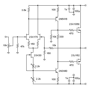

Hi Guys,
Are there any good schematics for a 5w Class A push pull solid state amp ?
Thanks.
Eric
look up JLH1969, it’s up to 10W. Yes, I consider this push-pull.
just to play devil’s advocate, a Single Ended option: search for SEWA, it’s up to 7W
they are both excellent.
Post #2 has 3 unicorns you can't buy in the US from a distributor. 2sk170, 2sa162, 2sk1058.
There was a guy in California that would sell you 3 ea 2sa162 2sk1058, 6 transistor for $100, but I didn't write it down.
Push pull is class AB. Post #2 is class AB. 25 W AX6 can be done with MPSA56 input , MJE340 VAS, MJE15028/29 drivers, & BD243 outputs. $8 in transistors. All from Newark. If you drop the rail voltage from 50 (36 v transformer) to 33 (24 v transformer) you can get down to 10 or 15 watts. You can get 24 vac 1 amp transformers at the home store, they are called a doorbell transformer. Link of APEX 25 W Retro amp is in the last posts of this thread: Retro Amp 50W Single Supply - Page 22 - diyAudio

SA and SK can easily be replaced by Exicons which are readily available, I must admit that SK170 is a bit more tricky, but it's far easier to find a replacement for that one that for instance SJ74.
I am about to make a 39w version of this amp called the Alpha Nirvana. Some quick LTspice sims shows that replacing the outputs with IRF610 and IRF9610 and dropping PSU to +/-15v and bias current to 500mA should get 5w into 8ohms. There are no unobtanium or even expensive parts. You probably have these in your bench drawers already. Although technically a SE Class A output, there is a reactive CCS that will make it behave like a push pull.

Thats a good practice amp, I had constructed one with J113, MJE340/350 and for outputs BUZ90X with no problems, however you can't get the same gain without the risk of oscilation with that kind of FET (J113) you will need to reduce the gain experimentally. The J113 is nowhere as good as the 2SK30/170

" Post #2 is class AB"
It's a 2x15V secondary biased at 1A, I wouldn't consider that AB...
The current soure shouldn't be too much of trouble and some members have found satisfying substitutes for the 2SK170 with modern available parts, agreed with the need of parrelleling 2 of them... but they are 40 cts parts...
That said, I am not selling that amp in any way, but the OP asked for a 5W PP amp which to me is very specific as a request, the amp I showed is given for 8W, suggested speaker are from 96dB on IIRC, I guess the OP is having something similar from his request.

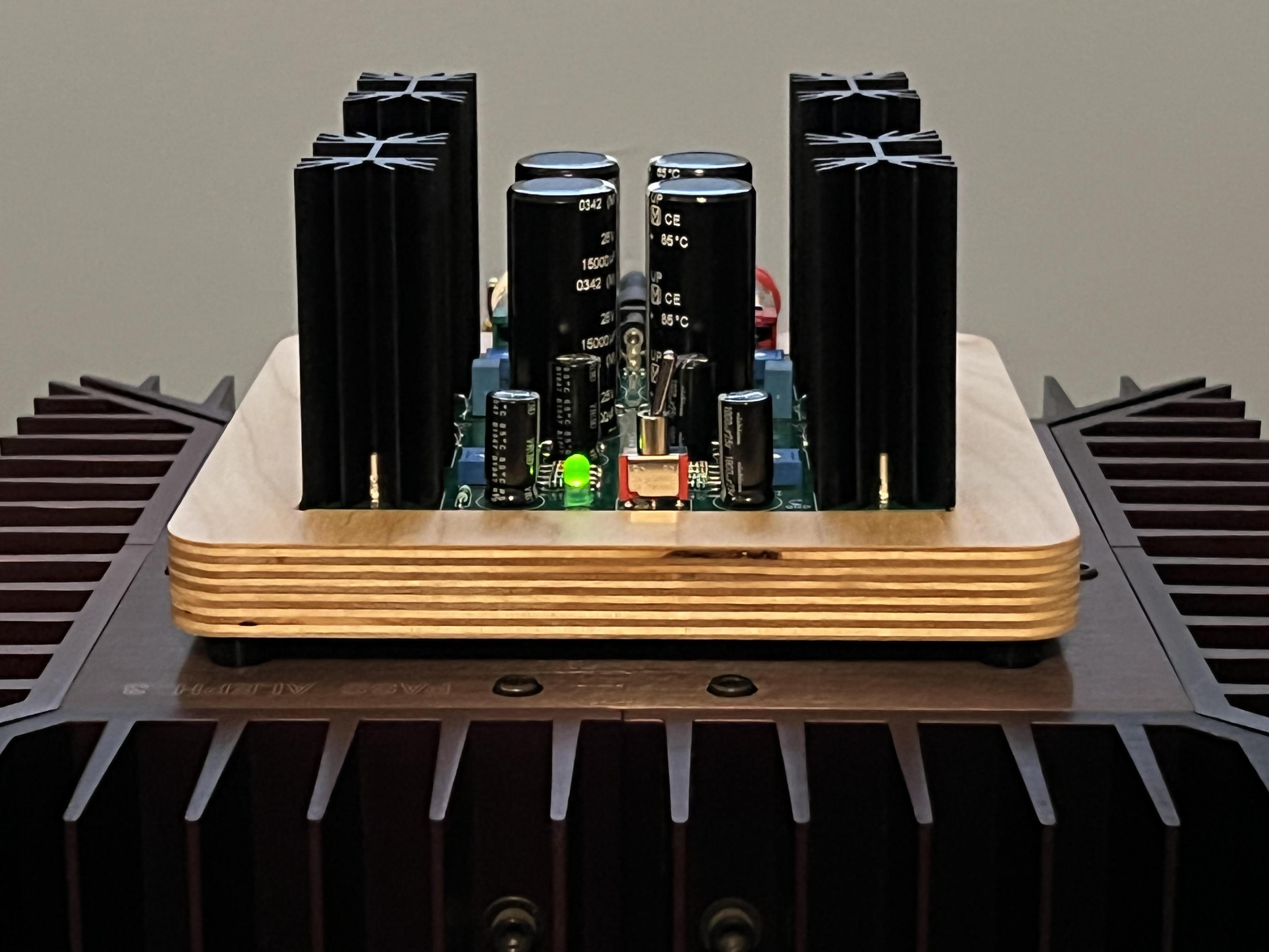

I see you posted a different Mimir hereI am in the process of building Mimir, a class A power amplifier with mostly standard components. It can be supplied from a symmetric supply in a wide range, so a 5 W amplifier is easily obtained.
At your website is another version.
Is this version better?
Thanks!
🙂 Stefan
