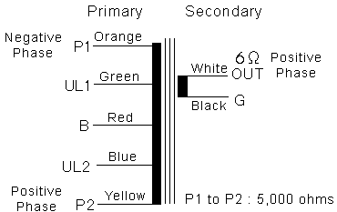

I am new in tube amp, and I have a question about PP Output Transformer.
Above is a 5 leads 5K PP output transformer picture.
P1 to P2 is 5K, B is CT
So, what is the value for UL1 and UL2? How to determine it?
It's that it is a 2.5K-1.25K-0-1.25K-2.5k structure on the primary winding?
Thanks!
UL Taps are for Ultralinear push pull operation , they goes to pentode screen , often they are taped at 43% between center tap and plates...
Only way to determine without a datasheet is to apply an AC voltage to the transformer and measure voltages at UL connections ...
