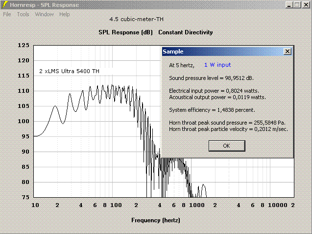

RE audio XXX 18" drivers. I have them in an infinite baffle setup.Dave.let me add another question to the one before from Art. What kind of drivers you do talk about and how much do you use of that 18" drivers? Maybe also the kind of installationis also interesting!
Dave I still have you beat by a driver...😛
You have the better room and mains though. 🙁
LOL, did you just dare me?
Crap, I think I caught your disease.
LOL, did you just dare me?Maybe I should add those 4 LMS ultra 18" to the equation?😀😀😀
Pics please, or video @ 5hz
