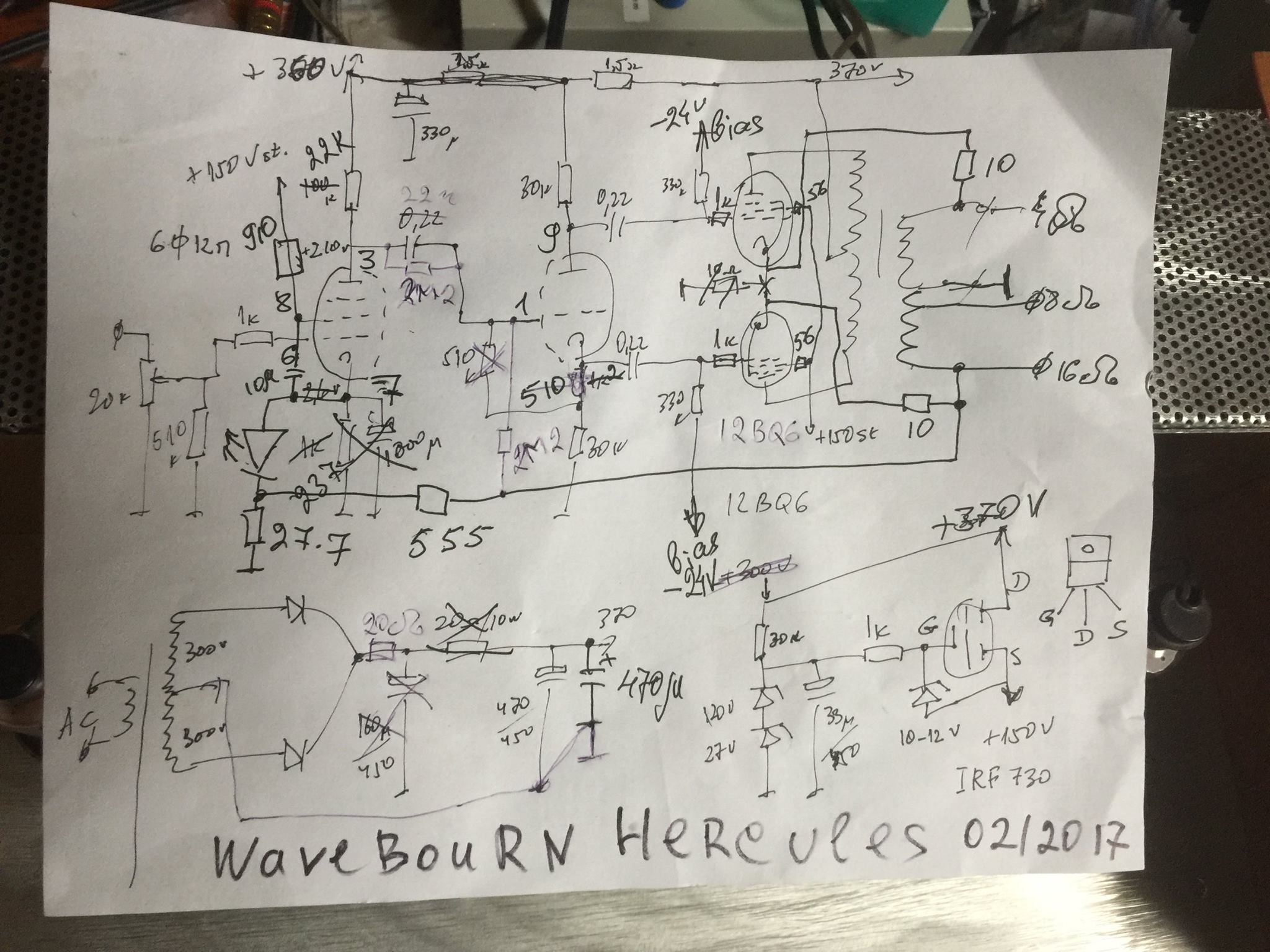

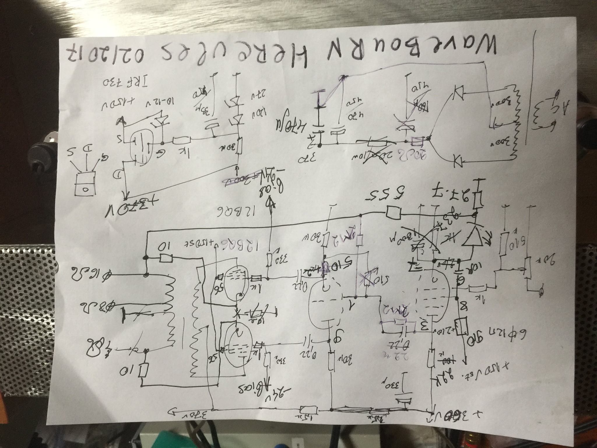

I see a 2m2 resistor going to the splitter grid from the N Fdbk line. Another "local" N Fdbk?
No, just a DC voltage divider, to make both tubes happy on different voltages. The upper resistor is shunted by a cap. It supposed to be drawn to the ground. :)
Ever try an RC there to reduce the global N Fdbk at HF? I see the Dynaco ST70 had a small cap there.
No need to. It is already unconditionally stable.
Yes. LED biasing of input pentode (IR LED), frame grid video pentode-triode, MOSFET voltage regulator with Zener string for screen grids (can use VR150 though instead of Zeners), and local cathode feedback from 0-4 Ohm and 4-16 Ohm secondaries.
Mmmm... I am partial to an 0D3, despite the fact that they are far noisier than a typical zener, especially a zener with a soft knee. As pretty (and interesting) as it is, plasma is anything but quiet...
How do you measure your "Quiet"? What is amplification factor of 12BQ6 driven from G2, how that "anything but quiet" would be translated into output voltage, especially when feedbacks are applied to the amp? Nothing is absolutely quiet. We deal with S/N ratio that matters. And if a voltage regulator tube adds some noise on the level 1/100 of already existing noise floor, is it quiet enough, or not?
You can find noise voltage in datasheets for gas discharge tubes. And what is a "Zener with soft knee"?

I'm quite convinced the gnd connection of your OT's secondary must read 4 ohms instead of 8.

That ARRL 6BQ6 amplifier has no N Fdbk. The 4000 Ohm primary would translate the 20000 Ohm Ri of the 6BQ6 into 40 Ohms output Z, so no damping factor. 6V6 or any of it's updates, like 6EZ5, 6JC5 or 6MF8, at 50000 Ohm Ri are out for sure.
For no N Fdbk, we need a low Ri tube. 38/12HE7 is on the $1 list, with 6200 Ohm Ri. (38HE7 lets you power up just the beam pent.) Otherwise it will take one of the bigger TV Sweeps to get low Ri. The 6HJ5, with 5000 Ohm Ri, are sold out due to popularity. 6CB5, 5000 Ohm Ri, almost gone too. 6DQ5 is close to a 6HJ5, 5500 Ohm Ri. 42KN6 can get you 4000 Ohm Ri.
Otherwise, use some N Fdbk or go to triode mode.

On the 6BM8, and on NFB applied to output cathodes from the OPT secondary.

The 6BQ6 amp circuit shown above, using NFB to the cathodes from the OPT secondary can counteract much distortion if enough grid voltage swing is available to overcome the degenration.

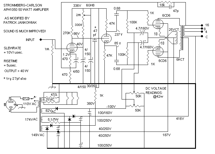

I was selling these modded APH1050's for a while in the 1980s, using the same NFB cathode circuit with H deflection tubes and everyone who bought them loved them. I had to increase the plate voltage on the driver to overcome the added, opposing K-GND voltage. (aph1050x.gif)

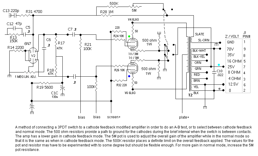

There's a way to connect a switch to do a/b comparisons with/without the neg CFB. There's always contention about it. (cath_feed_ab_test.gif)
My opinion/point is the best thing is going to be what pleases the builder/listener anyway!
Best regards!
Yes, I screwed that letters, because outputs were marked before I added feedback. In short, "0 Ohm" is still marked as "0 Ohm", as well as 4 Ohm, 8 Ohm and 16 Ohm, but grounded is 4 Ohm tap, that is right in the middle between "0" and "16".
