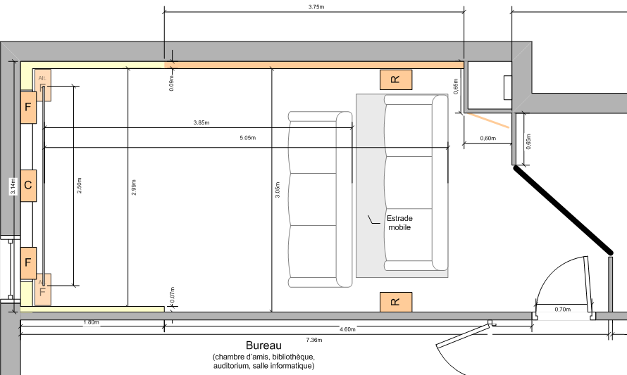

Ok, back in the place!
As I said I tried to answer yesterday, but it crashed on me after a long (wasted) time and after I had to go...
Ok, first of all I have attached a drawing of the room. Sorry for the annotations in french, but I did not take the time to translate them. I think the dimensions are pretty obvious, as well as listening/viewing position. "F" stands for front speakers and "C" for center. All 3 will be behind the screen. "Alt. F" is the alternative position of front speakers (right below screen this time) if we want to give them more width, but I'd rather live them behind the screen.
The yellow-ish layer against front walls is accoustic treatment (fabric over rockwool). The cieling will be rockwool as well, certainly a laminate floor. It is pretty obvious the size is not ideal, but "pushing the walls" was not an option. The dispersion for the rear speakers is going to be challenging and it certainly won't be ideal for the extreme seats (the ones on each side). The "sweet spot" will be ssuite narros as well, but again, "pushing the walls" was not an option.

As you can see from the drawing, if I keep the front speakers behind the screen, they are going to be pretty close and I am not sure there will be enough space between tehm for good stereo, that's why I am keeping the option of the alternate position (but then, all 3 are not leveled, unless I put all three belos the screen)...
The rear speakers are the real headacke... I am just afraid that there will not be a good solution, not with home-brew DIY at least as I think the only way to create enough diffraction for the job would be to go dipole (or bipole ?) and I would think that it is in the "too hard box" at this stage (for me at least). I remender reading something about a guy that designed various dipole configuration, and there was a few attempts before he had the ideal set up... How stupid was I not to save this link!!! I definitely started from here, but I think it was on a DIYer website...
So I probably have to accept that the situation won't be ideal here.

Hi Jean-Michel,
I'd say this makes the room between screen and "last row" about 3x3m to 3x5m.
Basically, it looked dificult to have a 8' going as wlow as 60/80Hz,
It's not difficult to get an 8" speaker "as low as 80Hz".

We are indeed keen on an "unbalanced" set up although some multi-channel gurus would call us heretics. Ithink that it may be required to have 5 fully identical speakers for multi-channel music, I do not feel it as important for a HT set up.

Since several questions have been asked of me,I will add some more info about my system,and hopefully answer everyone at the same time.
My room is 4.1 meters wide,5.94 m long,and 2.44 m high.Main speakers have center to center spacing of 2.9 m.Works fine without a center channel,the main speakers fill in the sound.
Screen is 3.2 m diagonal.

Since you are new to building speakers,and not completely sure what the best solution is,it might be better to spend your entire speaker budget on just the mains and subwoofer, After you get them up and running,you can add surrounds at a later date.
