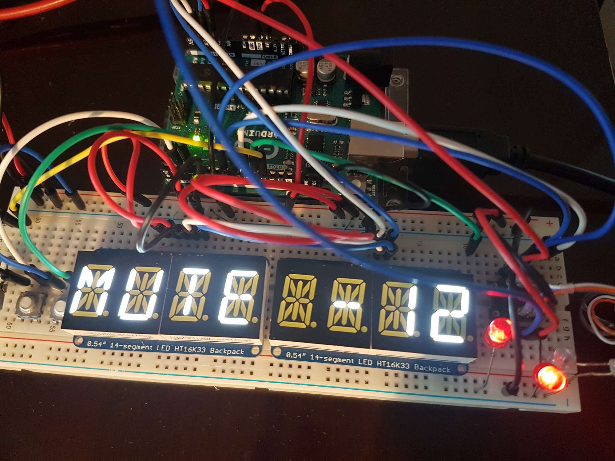

I found what I consider to be a serious bug in the 5.1 software for the Arduino. In single channel volume
mode the MUTE button went to MAX volume rather than MIN. I'm sure nobody is using it besides me but
I wanted to add the corrected version before I forget.

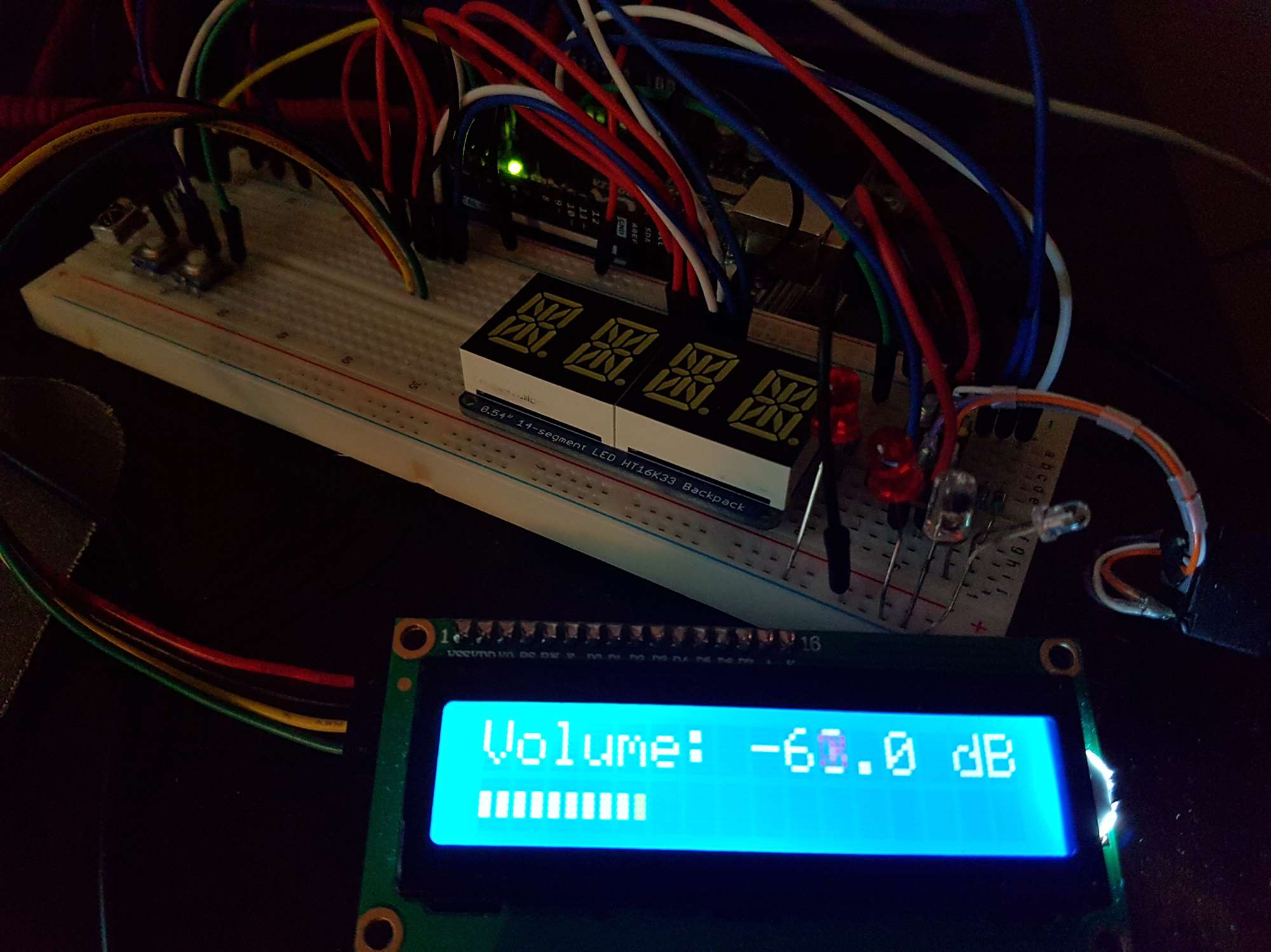

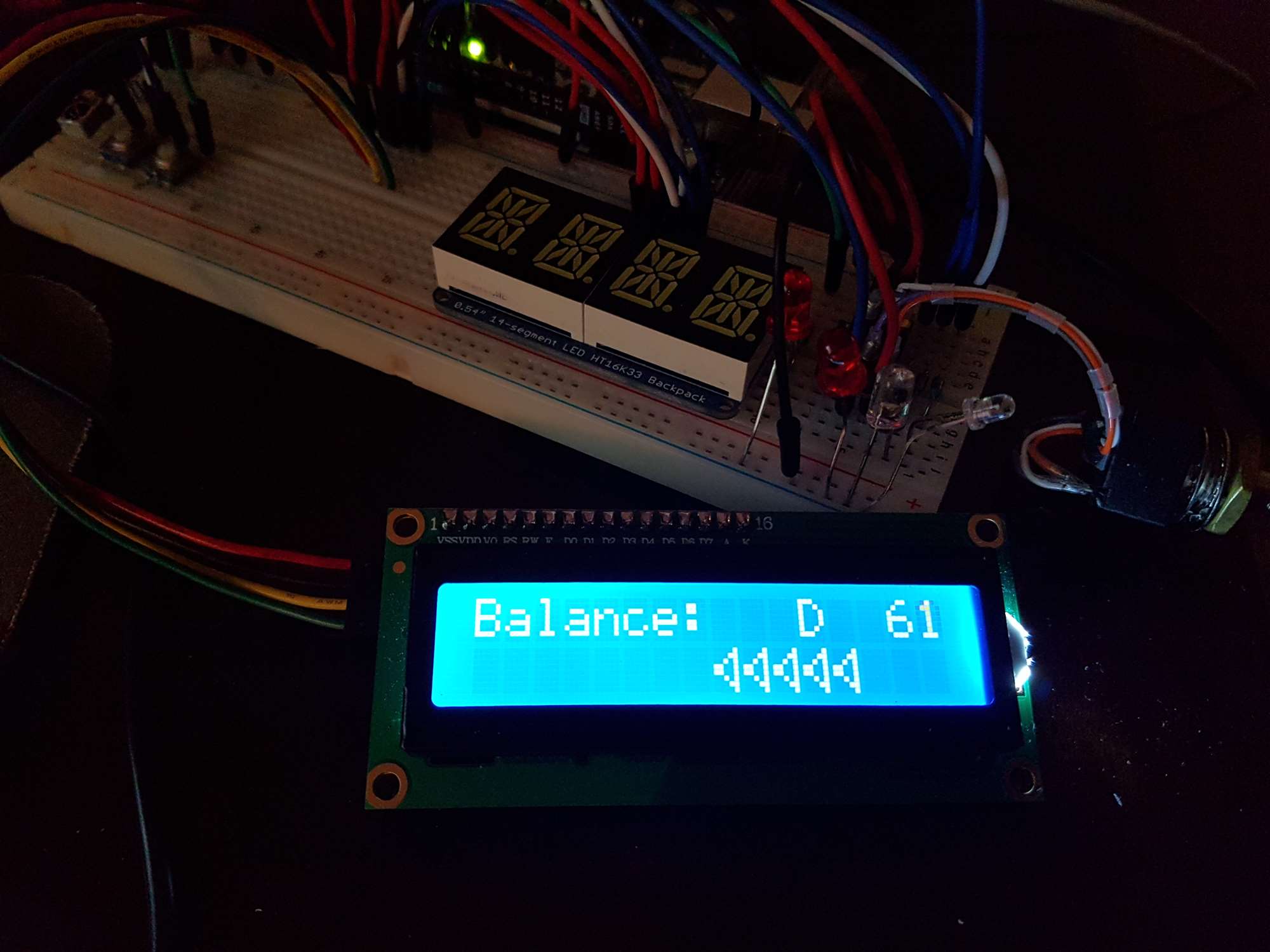

Hello, I wish to send a big thanks to Stratus46.
Who have demonstrated that it is (relatively) easy to make myself a volume-control system with an Arduino board and its software to drive PGA2310.
I tried to recover all of your lines of code, but I failed. My brain is not big enough 🙁
So I took inspiration from them to make my complete application.
My specifications are much simple than yours, control volume is the same, just behind an active crossover, without any tone control.
So I started in the realization of the software.
The "online" support (Coder, IR remote, display, EEPROM etc...) for the Arduino IDE is really effective and helps me a lot.
Firstly I bought 14 segment displays (like yours, blue aren't disponibles
in France... White only 🙂...) an arduino UNO board to build the software.
I will replace 14 segments AdaFruits with LCD 2 lines of 16 characters.
Now, only the prototype of this new display is created.
I still have to integrate it into the existing code. A unique C function is created.
Then, I have to create the software that controls 2 outputs trigger:
1 output to control the power up processor, and
1 output to control power up amplifiers.
I wanted to thank you for your approach because:
It is more than 4 years that I seek,(Without success, or very incomplete solution) an "intelligent" solution to replace the CHINESE KIT, whose software is very poor.
I attach some photos of the prototype board, and also photos of the new display. It's more pleasant, according to me.
When the 16x2 display and the triggers are integrated I will attach the code in this site, perhaps it may be useful to someone ?
NB: spécifications are also join to this post, in french unfortunely, but synoptics are explicits

You have been successfully busy! Congratulations. I like the look of your 16 char display. The reason I
didn't use those is because I sit about 10 feet away and want to read the displays as it is for a TV set.
G²
G²
Hello,
I was certain that the brightness of the 14-segment displays motivated your choice.
So I set them to the minimum to not burn my eyes 🙂
I keep this software version with 14 segments display, because you are absolutely right:
we see absolutely nothing at 3 meters with LCD 16 chars.

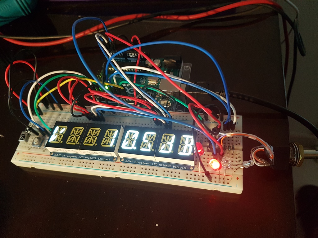

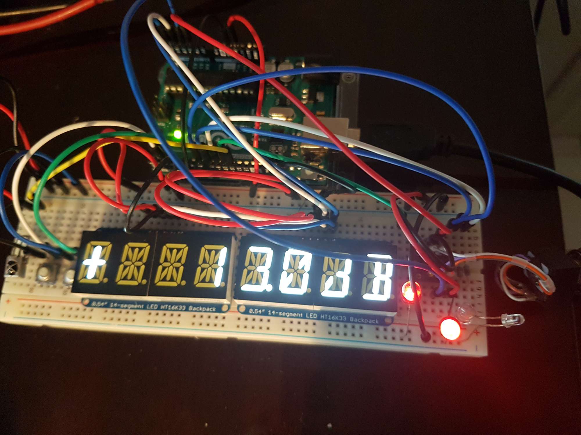

I'm adding the latest Arduino sketch as it tweaked the code a little specifically for the left/right
up down arrows to improve usability.
As far as small goes, if you're comfortable with SMT (no choice on the chip), each 2 channel group
of the NJW chip takes about a square inch. 0805 parts are small but not difficult to install. They
are also very tight on tolerance and not expensive. 0.5% resistors less than 4 cents in 100 lot from
DigiKey.
G²

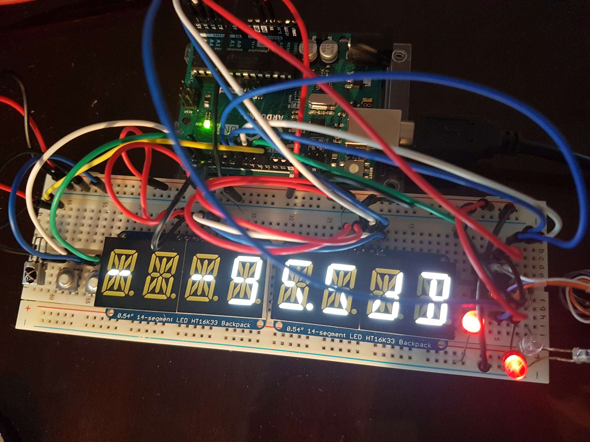

The neat thing about a software based gadget is you can try changes without even getting out the soldering iron.
A bright idea popped up while watching a show and having the dialog get a bit lost in the remaining channels so
I've implemented a special 'mute' mode to turn down all the channels except center. The gain down value is
settable in user setting called 'CDim'. The display shows 'Mu-C' rather than 'MUTE'. Volume up or mute
or the special mute button restores all to normal.
