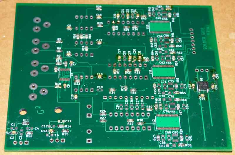

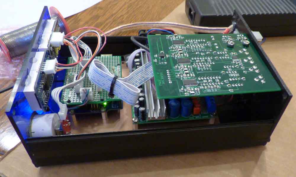

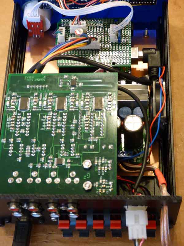

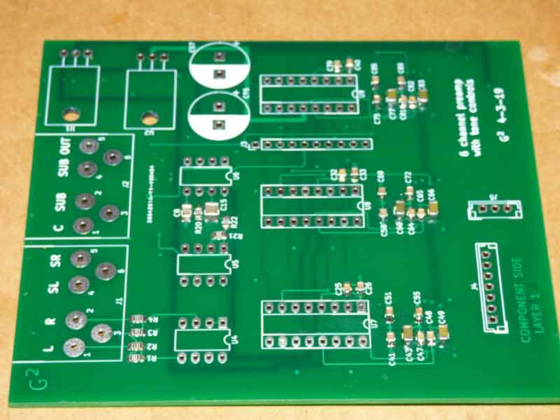

This 'preamp' is part of my home made 5.1 audio system. Volume control
uses 3 CS3310 (same as PGA2311) volume control chips, 3 New Japan Radio
NJW 1119A tone controls for Bass, Mid and Treble. 3 OPA2134 opamps are
buffers, summers and LP filter and impedance buffer for the analog feed to the Arduino controller.
This 'preamp' includes a 6 channel power amp based on the T.I. TPA3116
that delivers 20 Watts /channel into 8 ohms. The box is my 5.1 audio for an LG OLED TV.
This is not the exact encoder I'm using but it is functionally the same.
Rotary Encoder + Extras ID: 377 - $4.50 : Adafruit Industries, Unique & fun DIY electronics and kits
This display is exactly what I'm using. For volume only 1 unit can suffice.
With the tone controls it's better with 2 units. BTW I like blue better but
that's just me. They have several colors including white.
Quad Alphanumeric Display - Blue 0.54 Digits w/ I2C Backpack ID: 1912 - $13.95 : Adafruit Industries, Unique & fun DIY electronics and kits
The IR modules are these.
38 kHz Remote TSOP4838 DIP-3 IR Receiver Infrared Radiation Modules XZ | eBay

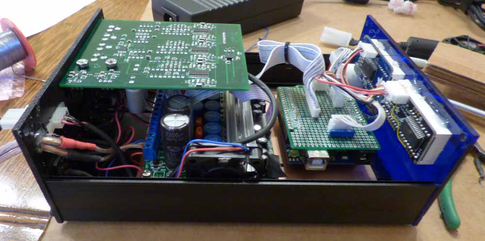

The 'interface' is nothing more than a blank Arduino shield to mount the connectors.
3 pin for IR, 4 pin for the rotary encoder, 5 pin for the displays and a 10 pin
to talk to the preamp board and get 5 Volt power. The pins just connect to
Arduino Uno pins with no extra semiconductors but a couple of capacitors.

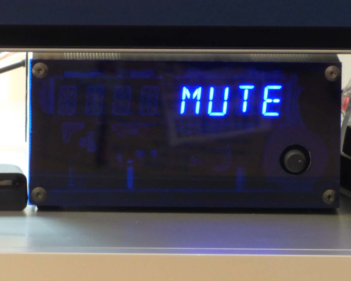

I got a little silly with the controls. The 'mute' function has a 'dim' mode. If you hold
the mute button more than a user settable preset, it goes to a secondary volume.
I usually set it to -15dB. The hold time can be set in 10mS increments up to
500mS to trigger 'dim' mode. It can also do 'fade' as mute. You can select
10 to 100 dB / second in 10 dB steps. Selecting 11 is not 110 dB but plain old instant mute.
Volume DOWN in mute or dim mode will reduce the level to un mute to but stay in mute.
Volume UP in mute mode comes out of mute and increments 1 dB. Mute button while in mute
just ramps back up to the old value. All settings are stored in EEPROM (non volatile).
My version includes a mono mix for a center channel in stereo mode and also low pass filters
the center to feed to the sub woofer. The Arduino gets a buffered center channel feed so
when it finds audio on the center channel it switches back to 5.1 mode.
The shaft encode is not needed but gives local volume control without a remote.
The button portion triggers mute and holding will also enter 'dim' mode.
Operationally the 5.1 is active always and uses the cable box remote to changes channels,
volume and inputs exactly like TVs of old before they turned into something that sometimes
need an engineering degree to use.
I know you can buy these thing but it's DIY. It's fun.
The TXT file need its name changed to .INO

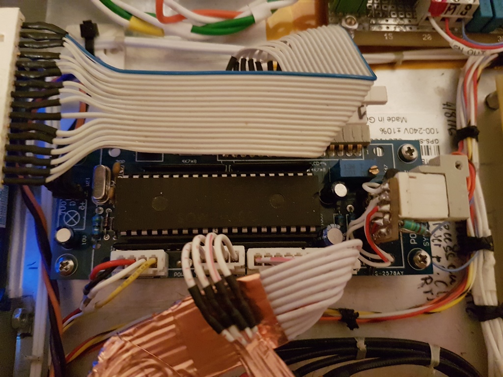

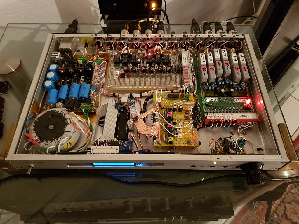

Well done,
I know how much work it is, when I made my portable radio/media player, using the TPA3100, before the TPA3116 was out. I still have code to write, I am not so good at it 🙂 Should be fun reading your code 🙂 . I think I left it at the IR decoder code. I made a remote encoder too.
My Mom uses the radio all day, she likes the RDS decoding. If you want to add AM/FM radio, I have code to give you.
I'll take a further look at your design, thanks for sharing.

The preamp power transformer is a 12 VCT but it would have a little more 'wiggle'
room with a 14 Volt transformer. These guys sell good toroids inexpensively.
AN-0107 - 10VA 7V Transformer - AnTek Products Corp
The power amp uses a 19 Volt 9.5 amp laptop supply.
The CS3310 and PGA2311 data sheets recommend a low source impedance.
In my case the analog signal is coming from an optical input DAC so the source
is already low. You might want to use input buffers like U3 to allow any source
impedance. I my case U3 is to isolate the 10k summing amp from the source
since the CS3310 is also 10 K. I like low impedance but 5K is a little low even
for me, hence U3. The input then is the resistor to ground at the buffer, in my
case 10K.
It isn't clear on the schematic that U3 is a triple 2:1 switch similar to a CD4053.
All analog switches show varying series resistance vs signal level. The 4053
maybe 120 to 180 ohms at 25C. In series with the 10K load would cause some
non-linearities (distortion). The Analog Devices chip shows the same series
resistance change but varies from 3.3 to 4.3 ohms at 25C so an order of
magnitude plus better than a 4053.
Because the center and sub channels have 2 different sources because of the
analog switch, it stores 2 sets of tone control and volume numbers for stereo
vs 5.1, only for center and sub.
At work I'm known as Mr or Dr capacitor for all the 'lytic caps I've replaced
(10,000 plus). On this board the only 'lytics are 2200uF 16 Volt and those are
Organic Polymer. All the 10uF and 100uF caps are SMD ceramics in addition to
the 100n bypass caps. The capacitors in the signal path are 2% film.
The 4 resistors on the regulators are 1% thick film 0805. The rest are 0.5% thin
film 0805 Susumu from Digikey. 11 cents in single lot, 10 cents in 10s but 3.76
cents in 100 lot. I have considerable 'left overs' that cost less than the 'right'
quantities.
Some tricks for SMD. I use a Metcal soldering iron with an STTC0126 700 degree
fine bent tip. Flux on the board from a flux pen in addition to the 63/37 Multicore
solder. After the parts are soldered but likely a little crooked, a hot air tool set to
the lowest air flow will allow the surface tension of the solder to align the part
without blowing them away. It's neat to see them self align.
Search for "858 hot air" on eBay and you should find lots around $35.
quantities.

Help about 5.1 project
Hello Stratus46,
I am interested in the complete outline of your project.
I made a 6-channel volume control with 3 x PGA2310, based on a Chinese kit.
My purpose is not the 5.1 but the volume control of the 6 outputs of my active crossover, so it's the same purpose.
I developed the input/output inteface balanced, but the computer part of the kit is pitiful. This is why I would like, if you agree, to have the interconnection schematic between the Arduino card, your analog part and the corresponding software.
I understand many things, but some one remain unclear: PIN_SW?, Why the outputs of the encoder Bourns are wired on analog inputs arduino? which input is used to program the parameters (Ex: dB / Second)? how did you find the VOL + and VOL- codes for Samsung and LG remote controls? I hope to use a NAD remote IR control, but I don't know her codes for VOLULE +/- tec...
If you can help me it will be with pleasure.
Olivier
France (please excude my bad English🙂
Hello Stratus46,
Olivier
First of all your English is 1000 time better than my French.
You might find it easier to treat the PGA chips separately rather than daisy chaining them.
That would mean sending 16 bits 3 times using 3 chip selects instead of sending the same
48 bits sequentially and only 1 chip select. Your choice as it's only a minor code change.
When I first tried a shaft encoder on an Arduino the example code from Arduino Playground
used the analog inputs which I just copied and everything worked. Since there are no
conflicts I just left it as it was.
The dB/second is for MUTE mode. The PGA2310 works in 1/2 dB per step. For TV use I really
don't need that fine a resolution so I just multiply by 2 to get 1/dB per step and then limit the
control range from 0 to 99. This simplifies the display using 4 character units. The MUTE mode
ramps the volume up and down. That rate in in dB / second which I limit to 10s I.E. 10, 20,
30, 40, 50, 60, 70, 80, 90, 100 and 'instant'.
Since you can't really tell the step size by listening 10-50 dB / step in in 1 dB per update, 60 to 100
is in 2 dB per update an 'instant mode just sets the rate to 100. This allows time to send status to
the serial monitor screen.
To get the remote codes I started with IRecvDump by Ken Shiriff on GitHub but evolved to this
very simple sketch
#include <IRremote.h>
#include <IRremoteInt.h>
#include <ir_Lego_PF_BitStreamEncoder.h>
int RECV_PIN = 6;
IRrecv irrecv(RECV_PIN);
decode_results results;
void setup()
Serial.begin(9600);
irrecv.enableIRIn(); // Start the receiver
void loop()
if (irrecv.decode(&results))
{if(results.value != 4294967295)
Serial.println(results.value);
irrecv.resume(); // Receive the next value
You then copy the received value from the serial monitor screen and replace the number
in my sketch.
You don't need the tone control code so you can just delete it but since you don't have the
hardware, it could just send the data to nowhere.
Have you built an Arduino test system for this? I have the unit I built for the 2 channel version.
It's nothing more than a blank shield board with the connectors to the other parts. 3 pin
connector for the IR sensor, 4 pin for the shaft encoder a 5 pin for the Adafruit displays and
a 10 pin to the preamp board. There are a couple of bypass caps and pullup resistors for
shaft encoder. No semiconductors. Once you have the test system you can use the serial monitor.
You'll find a pretty complete messaging system to help debugging and testing. That board will
run the little sketch for identifying the codes. I've used this for Sony, Samsung and LG remotes.
The one possible problem could come from a different modulating frequency of the IR. Most but
not all remotes use 38KHz but there are other frequencies. All this means is you might need a
different IR module for the NAD
I'm hoping you're OK with Arduino code.
Good luck
G²

Thank you very much, I did not understand that you set the 48 bits of PGA2311 directly with lines of code, more simply doesn't exist
I thought you were using the SPI possibility of the Arduino chain.
I think I understoud (approximately) everything about your project.
Code seems easy to modify, because it has all the bases that I search.
I would like to help you so, certainly not in software ... may be in hardware for ground wiring, if you have any noises or oddities between the digital part and the analog. I know what to do for this.
I think this project, with or without LOW MID and HIGHT corrections should be on the market.
And it is not so, I don't understand why.
Still thank
PS : warnings are not importants, they are also with last version of Arduino. there are in the middle of the long text write by compiler, sometimes I don't see them...

"Bit banging" the data loading in this case is trivial as there is no need for a steady clock rate, just the
right number of them. The actual block is "load8vol" and is only 5 lines of active code. The rest of it
would be needed to correct the level values based on the offsets whether using SPI or not.
As far as should be on the market, it already is. If you search eBay "5.1 remote volume" you'll find
several items, right now it's 5, based on the Mitsubishi M62446 6 channel volume control chip, all less
than $50 and all with proprietary controllers. I had one of those interfaced to an Arduino and it worked
well enough. But, I wanted to do the derived center and subwoofer from the simple stereo L and R,
I wanted to go back to the PGA2311 (same as the Cirrus Logic CS33010) because it claims better
channel to channel balance, more accurate steps and more control range (127dB for PGA chips and
79 dB for the Mitsubishi) lower distortion and noise. Could I actually hear these "shortcomings"?
No but I feel better about it. Under VERY noisy conditions the Mitsubishi chip did not mute completely
though I have not tried that same noise into the new unit. Mission creep being what it is, I added
tone controls to all 6 channels which then gave me an excuse to try a KiCad project and do another
DIY thing. At the end I finally added the mute as fade up/sown and the "dim" mode to partially mute.
I can't think of much more to do to it but you never know...

Chinese kits : I knew them, I bought 3 since 2014, I join some pictures of the realization around this kit, but what I did in reality is to build a cathedral ( ok: just a big church 🙂 on a "pile of manure".
- the remote control is a crap, contacts does not last long, no volume backup when power off, no choice of the increment, CPU does not follow when we turn the encoder too fast, etc, etc ...
I join a picture of my "cathedral" and the Chinese kit, the guilty I am going to replace.
Well, it's not all that. I have to work a lot if I want to throw this Chinese kit in the trash, as soon as possible.

That is precisely what I did. Search on eBay for "TPA3116 5.1" and you'll find several types.
I used a power amp only module with no remote or controls.
5.1 TPA3116 digital amplifier board 6 channel amp board 50W*4 + 100W*2 L163-8 822933248485 | eBay
The boards like this all have a silk screen error. Notice all the '+' outputs are to the right
except for the 'MS' output which is really 'SW' upside down. The '+' output is to the right
just like the rest. As far as I can tell, the less expensive units use 1 main power input
cap rather than 2 and have 5 screws rather than 3 to hold the heatsink. Keep in mind that
100 Watt thing for the center and sub assumes you use a 2 ohm load. With a 24V supply
all 6 channels will do 25 Watts at 8 ohms and 50 Watts into 4. I used 19 Volt laptop supply
because it is completely enclosed and no worries about exposed wires. One other thing
that might surprise you is the output DC is 1/2 the power supply value. In my case that is
9.5 but it's a bridge amp so the value across the speaker is 0 but you need to be careful how
you connect test gear. You could add output caps but they would only waste space and money
with no sonic benefit.
The space occupied by this box is 203x144x68 mm. I used blue plexiglas for the front rather
than the metal plates supplied and black plastic for the back as it's easier to cut the holes.
The recess for the knob is a PVC end cap for PVC pipe cut to size and glued to the plexiglas.
I later added a USB extension from the Arduino to the back panel to GREATLY simplify firmware
updates. The HTPC in the system simply has the Arduino IDE on it for this purpose. There is
one change since the rev 7 I posted in August. Any remote keypress while the display says
HI and the audio is muted (always muted for the first 5 seconds) will remain in MUTE until a
volume up or Mute button is pressed.
