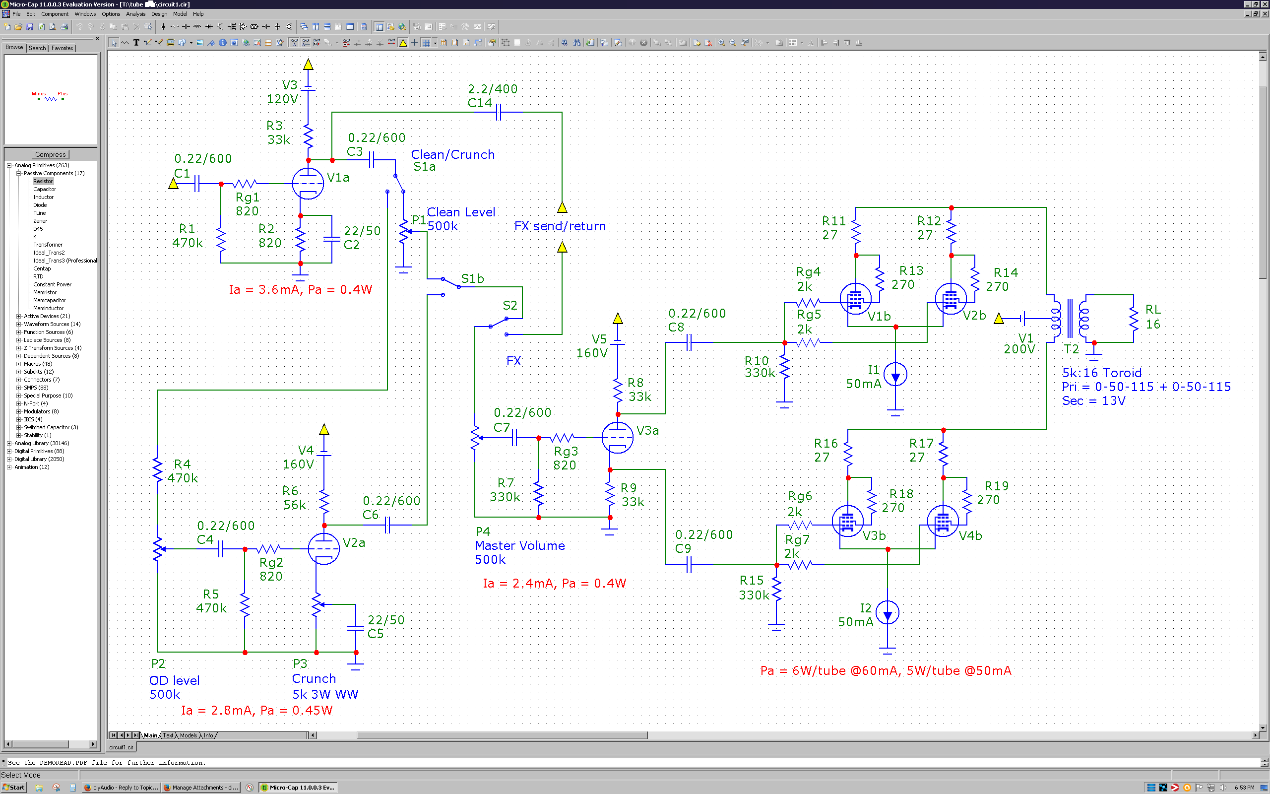

Riiight.

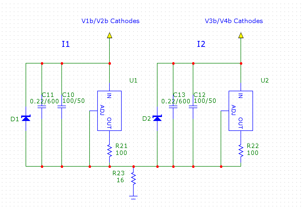

'ere's version 1, standard PP no global feedback. Provision for an FX in/out loop, which allows me to not use only the power section onwards. CCS uses 7805 regulators, for a 50mA constant current through a 100 Ohm resistor.
The library does not have a UL transformer, so the power sections are currently triode-connected. I am planning on pentode and UL connections too. Also, PS schematic is not shown, as I am not really confident of the voltages used.
Brickbats welcome. My main issue is how close to the edge the triodes are running (max Pa of triodes is 0.5W as per datasheet). This is sort of deliberate, so I don't run out of drive current. Could back it off significantly if required/advised.

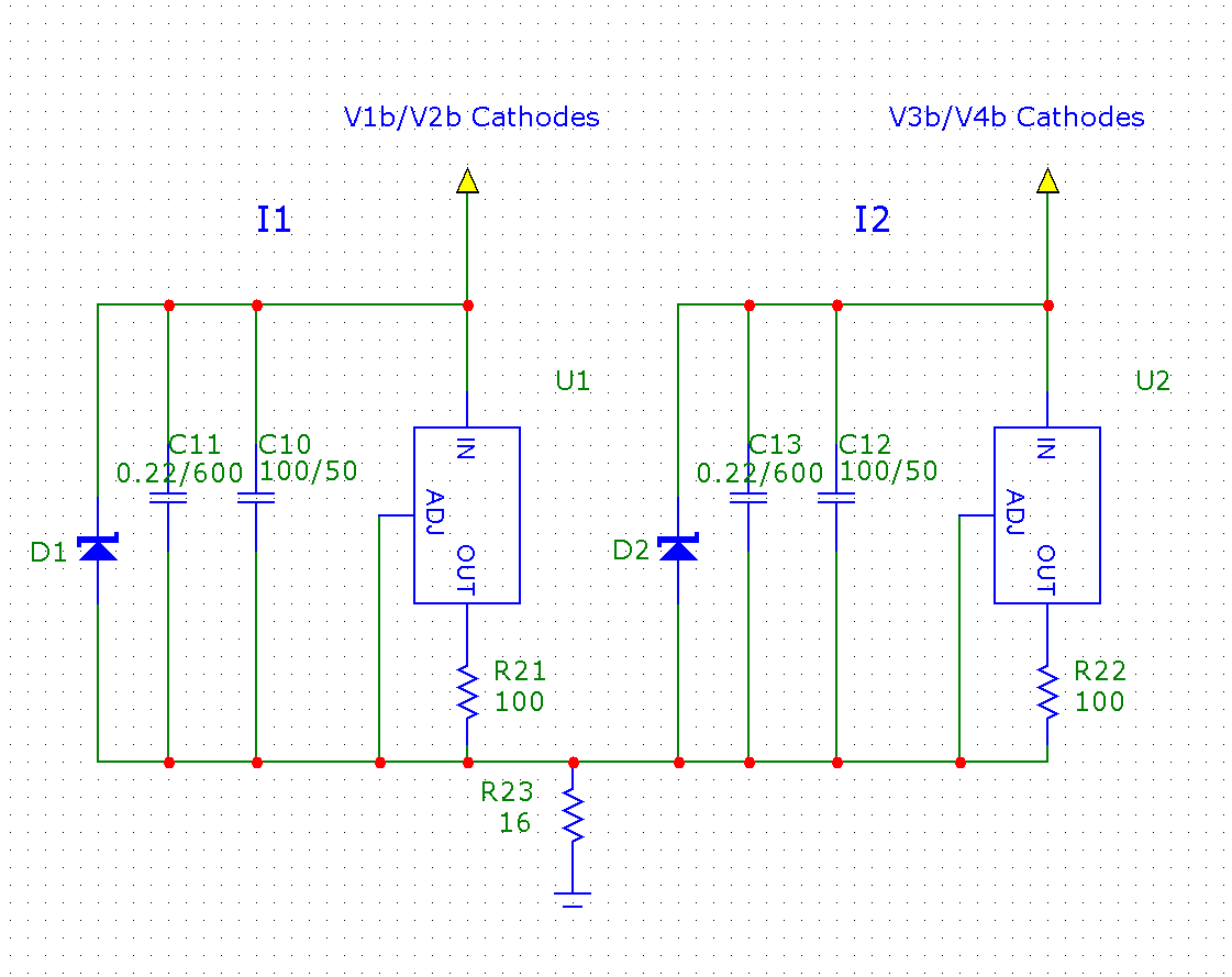

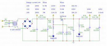

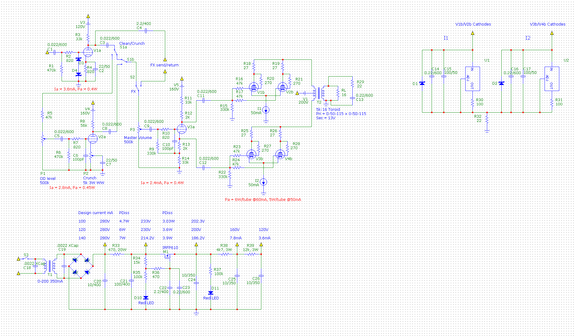

Well, I finished drawing up to the best and worst of my ability. Will start sourcing parts next week.
How much insurance will I need? And what should the ER be prepared for?
Yes 0.22uF is a bit too big for guitar amp use. Try 22nF or as Jim suggests 10nF.
I only had a quick look at your proposed schematics but noted the following:
MOSFET M1 needs a 220 Ohm or biggger (no need to go over 1K) gate stop resistor. The propensity for parasitic oscillation is roughly inline with a devices gm. Mosfets have X100 to X1000 the gm of a typical audio output pentode and so you can assume that without a gate stop they are X100 to X1000 times as likely to go into parasitic oscillation.
The concertina splitter V3a needs some bias components. Probably best to cathode bias it and return R7, C16 etc to the bottom of the cathode bias resistor (bootstrapped input).
Check out some early Fender Schematics - e.g.
http://www.recproaudio.com/diy_pro_audio/diy_files/tweed_deluxe/deluxe_5e3_schem.gif
See the way they biased it?
Don't worry about the 56K vs the 33K anode and cathode loads. The triode section of your 6GV8 is "grunty'er" than a 12AX7 triode section so you can use the 33K you had shown.
If you want to get fancy you can use LED(s) in place of the bias resistor. IR and Red LEDS about 1.4 Volts, Green LEDs about 1.8 to 2.0 Volts.
When you go to pentode mode the 2K grid stop resistors on the output pentodes will want to be MUCH larger (suggest 47K) to help prevent blocking distortion and improve the overdrive sound.

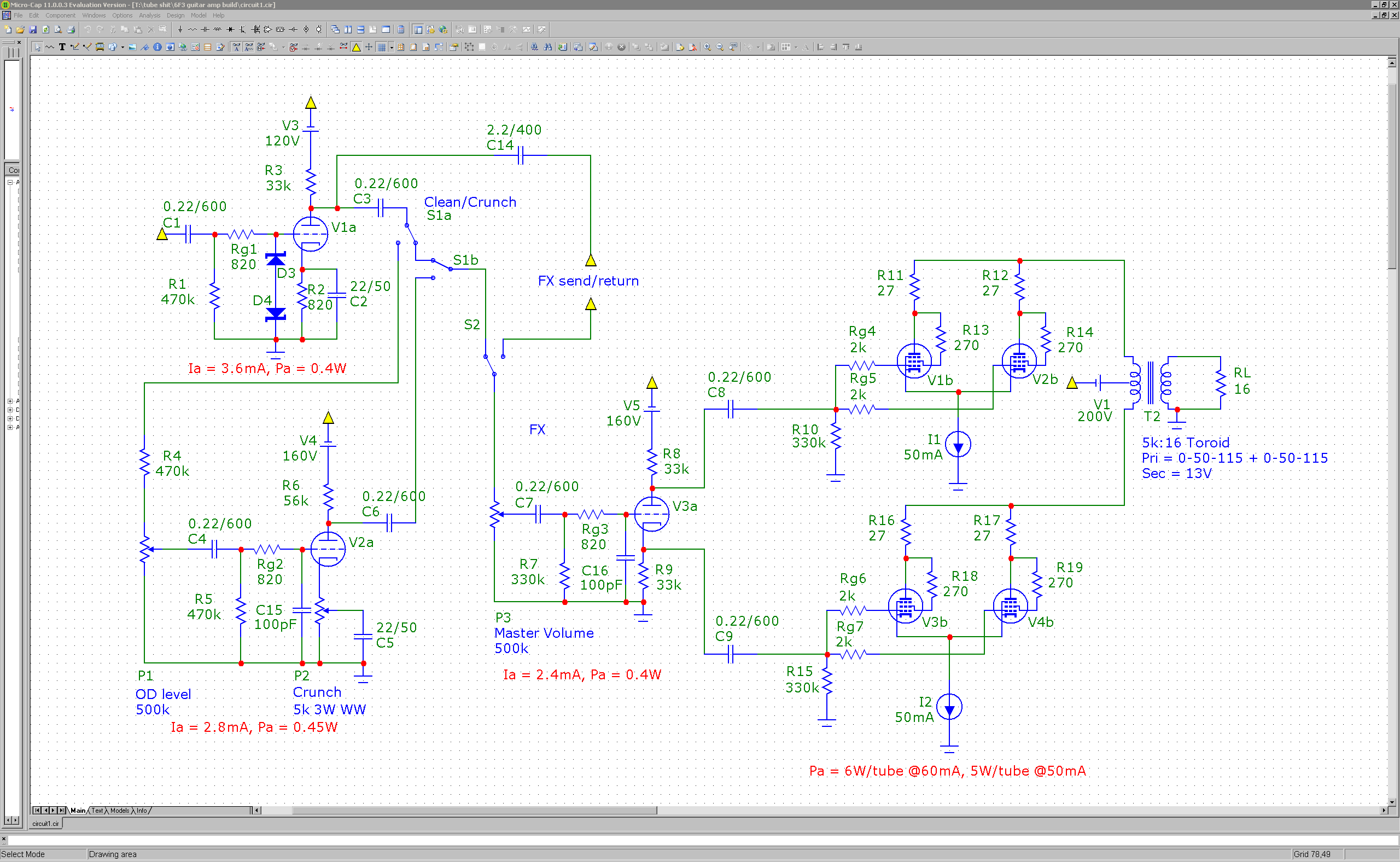

My question was actually the calculations :) I was using anode load to set the max current through the tube, looks like my current and power calculations are off so I will need to go back and see what those are working out to. For academic interest at least!
I could not figure out how to change the gate stoppers in pentode mode only, not enough poles on a switch (I assume to help with the increased miller capacitance in pentode mode?), so I'm just using a single value now and hopefully it will work in all the proposed modes.
Eventually I hope to evolve a preference for a specific type of configuration. In all the hifi amps I've heard, I seem to prefer UL modes or amps configured permanently in UL. I suppose it might not be the same for guitar.
I'm guessing I might get about 10-12W out of this thing in Triode mode, which is enough for me and hopefully has a sound decent enough to record some basic stuff with. Not really looking for much overdrive, basically some soft clipping. Like an old Fender, rather than Marshall. That is why I haven't yet put in a bridge rectifier.
