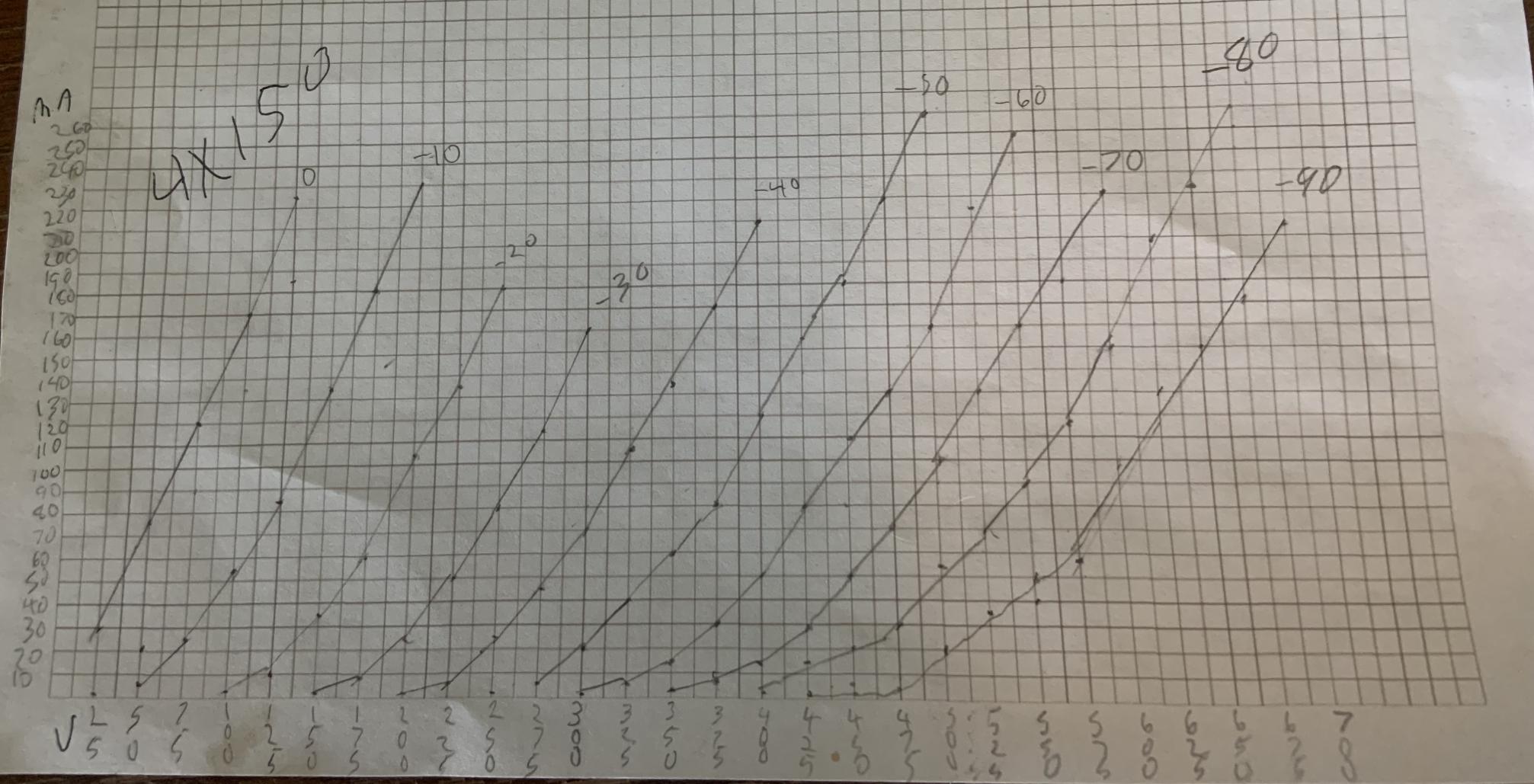

I was able to get some triode curves for the 4x150.
Looks fairly good. Note this was done with one sample tube with variable power supplies and volt/ammeters. Some measurement errors may exist.
Next thing I need to do is measure screen current especially at higher voltages.
Will let me know how much plate voltage this tube would tolerate.
Since this is a tetrode it may handle higher voltages gracefully for ultralinear use.
One note is you need to be sure the plate connection does not detach when using as a triode. The screen current will spike and the tube will likely die.
