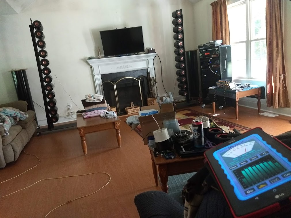

4x 8" Subwoofer experiment.

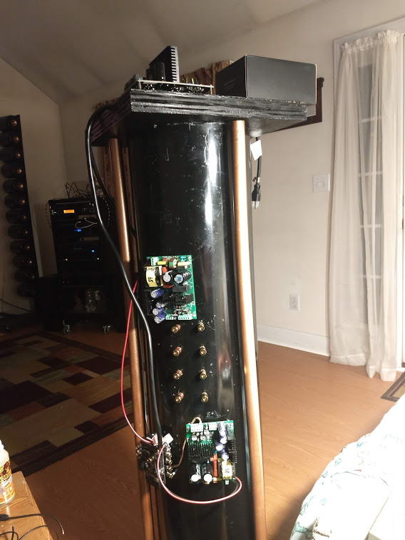

Generally it's been said the one can't really hear where 20-80Hz is coming from. So even better when you feel the subsonic frequencies.
Just FYI I could only feel it when I was closer to the sub. So many nodes in the room cancelling out... I do have another sub on standby to be modified.

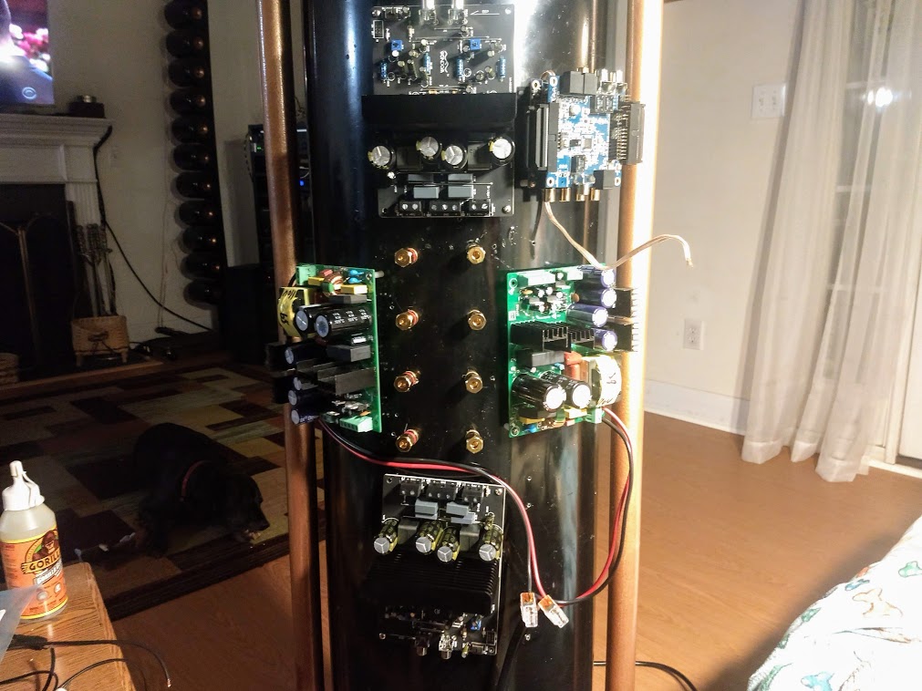

Think, thanks alot for your input I really appreciate it.... I am having recurring problems with these cheapo IR2092S 500AMP boards I got from eBay. They keep blowing out randomly... To fix this situation, using the same +-65V 2x 500W SMPS's, I decided to order 2x (250Wx2 IR2092S) Amps made by Sure and sold by PE. That way I'm done wasting money on poorly made product. I should have them in before next Monday. Hopefully good results!
Then I shall make progress, if the Amp situation is resolved, on sealing 2 drivers....
Interestingly enough, the 2 amps that failed last were the ones driving the outer drivers and I did not notice a 'real' difference in SPL at subsonic Freq's as I was testing sub20Hz at louder volumes. also, another plus is the Sure Amps have 1.1Vrms input sensitivity, so I'm not looking to mod the gain setting... Still I would steer anyone clear of the IRS2092S 500AMP's made in China. They're cheap, but they don't work.
My guess is that the amps connected to outer drivers failed because of an impedance problem created by the outer drivers because of the inner drivers only pushing but not pulling the outer drivers; as the drivers have a open space between them.
Not like an isobaric setup where 2 or more drivers push and pull each other because of the closed spaces between them.
If so, this problem is not fixable and the sub won't produce good sound.
Other amps have failed, not always the outer driver amps.
Here's the new setup. As always, priority is given to the shortest length of wires from amp to drivers. That still needs to be wired. Had to place things differntly too because of the larger heatsinks on these boards based on the IRAUDAMP7S.
