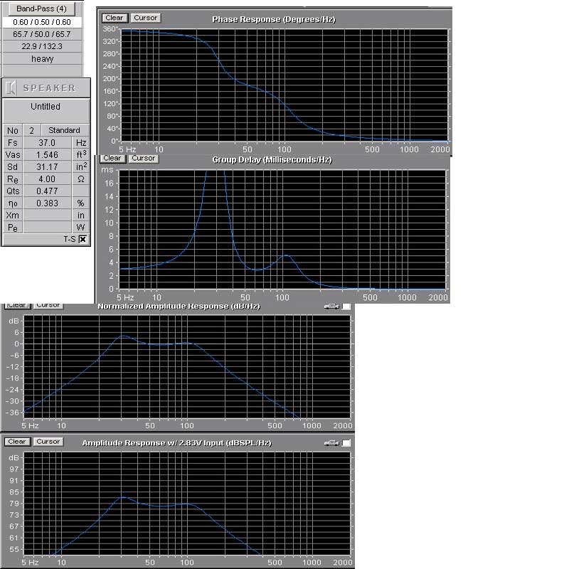

I designed this subwoofer, its using 2 8" drivers,
and i wanted to know if the response curves are ok, and if i should do something to make it better, or if its ok

What is the rated SPL @ 1W/1M of your speakers?
The curve of your subwoofer--3 dB at 25 Hz, using two 8 inch speakers, (equivalent of one 12 inch), is very, very good, if the SPL of the rated speakers is 88 dB @ 1W/1M or above. If it is much under that, then there is a dropoff in performance.

how can i find the rated SPL @ 1W/1m? i bought those driver preety oem, and thats why they were cheap but i think they are awsome, and i calculated the specs needed for the box design.

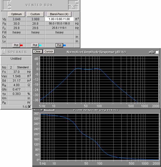

I've being working on it, to reduce the volume because it was too big
thats the new version.
what do u think of it?

Drivers are OK
So its sensitivity is 88.03dB as shown by that chart. Now just make sure you use at least a 3" flared port to aviod port noises from trying to pass too much air. Flared ports can move air faster, so a 3" non-flared port might make chuffing sounds, but a 3" flared port probably won't.

A) Your amplitude response at 2.83 input is only about 79 dB. Very very low.
B) The sensitivity of the speakers is given as 88 dB-about normal. However, these are actually 5 or 6 ohm speakers-that sensitivity rating might be inflated.
Sensitivity is sometimes measured by watt, often by 2.83 volts at 1 Meter. 2.83 volts produces one watt in 8 ohm speaker. However, it produces 2 watts in a 4 ohm speaker. A 6 ohm speaker measured this way will be overrated by 1.5 dB-which isn't so outrageous, actually.

I think a best shot is your ported box. If you take a look at the midpoint of your bandpass, you see that it's throughout most of it's range, it's playing at 75 dB or so at 2.83 input.
The sensitivity of the woofers is either 88 or 86.5 dB. The bandpass is lowering their output-smoother line, but lowering the output throughout it's playing range.

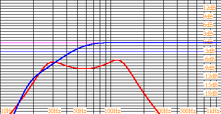

The following graph WinISD graph contains two speaker responses.
The one in red is for a bandpass enclosure with characteristics very similar, though not identical, to yours.
The line in blue represents the two woofers in a bass reflex cabinet, 2.6 cu. ft., tuned to 25 Hz.
As you can see, the two curves meet around 25 Hz. However, the ported system is much more sensitive throughout most of the playing range.

Two more things to consider.
When put near a corner, the output of the port frequency is increased up to 6 dB. It gets less the farther from the corner you go. The ported box's port frequency is 25 Hz-right where you can use a boost. The bandpass box's port frequency is 55 Hz or so-where you don't need help.
In a ported box, the cone is moving ony about one fourth as much as it would in a closed box to produce the same bass. There is probably very little help from the port at 25 or 30 Hz in your bandpass. that means that your cone is moving three or four times as much to produce the same bass output.
When a big bass note comes at 25 Hz or so, you are very likely to run out of excursion with the bandpass. Not with the ported. the port aids the reflex box right where it needs it the most.
Try a reflex box, 2.6 cubic feet, 25 Hz tuning, and see what you get. Oh, yes, the bass distortion will be much less with the reflex box as well.

Bandpass subs can be very good. They can raise output per watt or lower it, depending on how they are built.
The bandpass sub here has a lot of bass extension, but as you can see, it plays at 79 dB @ 2.83 volts throughout most of it's range.
I certainly do not have anything against bandpass subs as a whole. I just thought that much can be gained by compaing this bandpass to a ported sub.

after seeing kelticwizard 's graphs, i see vented would be way better than my design. Any ideas on how to reduce the vented woofer size while keeping the same bass?

Well, one way to keep the same bass curve while cutting down on box size is to use just one woofer. A 1.3 cu ft box will give the same bass curve as 2 woofers in a 2.6 cu ft box.
