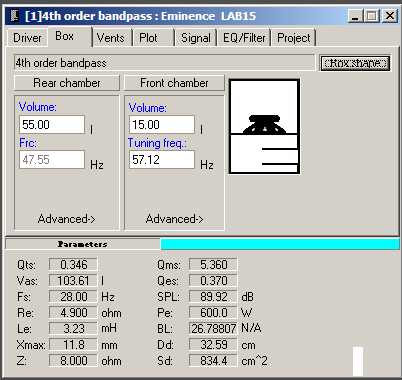

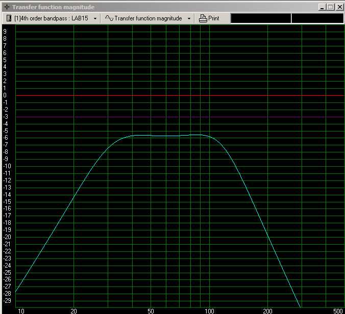

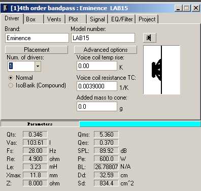

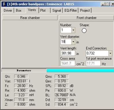

Hi slipfirep40,
I don't mess around a lot win WinISD, but I'll attach a quick entry using the LAB15 and an 18"Dia. duct. Under vent you find the duct length, and from that you can calculate the air mass, which is the moving mass of the respective (in this case 18"Dia.) passive radiator. You have to enter your components of choice into WinISD.....
