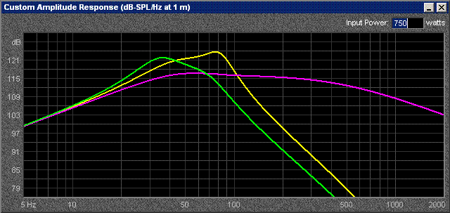

Okay here I go, I am a long time reader first time poster as now I need some help. It has been a long time since I designed a 4th order bandpass enclosure so I am rusty. I did some reading to brush myself back up on the theory and even used WinISD to help me model it. Some of the main things I worry about are how I did some of my own tweaking to provide a gain boost in the low end and most importantly having enough port area.
The single 12 sub will be used for car audio application and being powered with a true 750 watts. I am looking for it to be overall decent sounding also while still providing a lot of low end response through 40s to 60s hz range.

Enclosure:
Fb: 45.21 hz
Vf: 0.94 ft^3
Vr: 1.14 ft^3
Av: 40.5 in^2
Lv: 51.5 in
All the enclosure specs are tweaked by using formulas they are not what WinISD suggests. The net volumes (sub, bracing and port displacements factored in), port length, port area and tuning are what they actually are after measuring out on graph paper. In my past I have always adjusted any enclosure with using formulas after modeling them in a program. I prefer pencil, paper and a calculator.
After my adjusting it to get a +2dB gain in the 40s to 50 hz range I figured the Q should be around .80ish and providing a decent transient response with a passband of 40 to 82 hz.
Now I am a little worried about the port area I am trying to avoid excessive port noise if at all possible. Going by the calculator on CarStereo to find my minimum vent diameter it says I need 99.74 in^2 but if I go by minimum port area from diyaudiocorner they say I only need a 6 inch circular port or 28.26 in^2 for a single 12 inch subwoofer. Can someone please tell me if my 40.5 in^2 will be adequate enough? Using WinISD it shows it as a 0.02% match. Lastly will the 51.5 inches long labyrinth port length (corners will all be beveled) affect anything?
Thank you all for taking the time to read this. I am looking forward to some helpful replies and of course any suggestions are also welcomed.
- Gus -

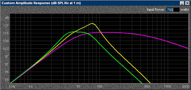

Ok, you've gone for the classic flat top response which unfortunatly results in a pretty bloated response in a car after cabin gain, if you tune the front chamber to ~70hz you will will get a raw response that looks ugly on "paper" but will work very well in the car, combining with cabin gain to give you a large boost from 80hz all the way down to below 30hz (compared to sealed)
This plot has a modest 6db cabin gain added to show what I'm talking about.
Pink is sealed in 1cuft, green is your design, yellow is your design tuned to 70hz.

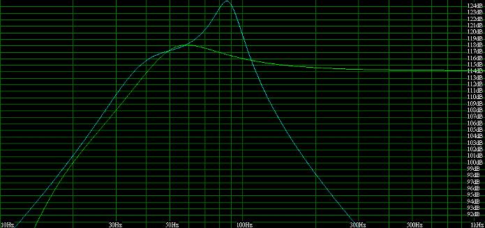

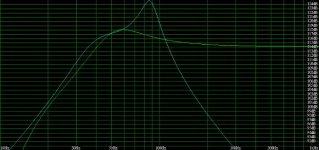

following what volenti said in the first post, I gave it a try with the kicker compVR's that I'm thinking of building a bandpass box with........
the blue line is the bandpass with 1.5cuft sealed chamber, 1cuft ported chamber tuned to 73Hz. the volume the ports will take up is already taken into consideration. I would like a little more lower end extension but this has been the biggest box that I could fit in the space I'm willing to give up. the port will be rectangular 3" by 14"
the green line is the box I'm currently using at 1.5cuft tuned to 32Hz.
any comments?
any comments?
That plot looks a little peakier than I'd expect but that program may not be calculating for box losses, it's not a big issue.
The beauty with this "alignment" is that for the most part all you are changing is the port length to tune it, and the usually high tuning frequency let's you use very large ports which keep vent air volecity down.
