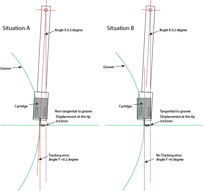

Maybe you should pay attention to trigonometry and geometry, since that is what you are discussing. I would like to see your analysis of that geometry problem. Do you think the cantilever deflection would be more or less that the 0.2 degree arm error? Justify your answer. Now given your estimate (or observation)of cantilever deflection, what do you calculate for angular error at the stylus, and how?
Here is the analysis I am showing you now. Let’s assume that stylus drag is zero for now. Please see the image.
Situation A
1, All the parameters are from johnmath’s calculations. You can see angle Y is tracking error. It should be the same as his assumption that 0.2 degree.
2, Now, let’s introduce stylus drag into the equation. However, why in the world it will be 6 degree? Do you understand how big 6 degrees stylus drag in reality? It is not playable if it is 6 degrees.
Situation B
Let’s assume there is 0.2 degree tracking error which is inherent in the construction of the arm. But in reality, you should adjust the cartridge base upon the cantilever. So, the stylus can still be tangential to the groove, and the tracking error is zero.
I also have a problem with johnmath’s statement to generalize his calculations about a particular linear arm to all the servo-driven and passive linear arms.
When wiseoldtech said his Kenwood linear arm is rated for less than 0.2 degrees of any tracking error. It doesn’t necessary to mean there is an error 0.2 tracking error in the base of the arm wand. When we say tracking error, it always means the relationship between stylus and groove. In my drawing, it is angle Y. If Y=0.2 degree, it is reasonable and creditable. Therefore, johnmath’s following calculation is simply nonsense.
(tan0.2°)x180 = 0.63mm
So is
arctan(0.63/6.0) = 6.0°
So is
Thank you super10018 for doing the drawing which makes my mistake obvious! The tracking error at the stylus is not going to be near as large as I stated becasue the deflection of the cantilever is correcting tracking error, not exacerbating it as I incorrectly thought. I should have drawn it like you have.
However your drawing highlights that the problem manifests in a different way: there is still a potential 6° error at the cartridge for a 0.2° tonearm error - not between the stylus tip and the groove, but between the cantilever and cartridge body (and the magnetic drive system inside).
At the very least this is equivalent to a serious skating force in a pivoting tonearm. But for many cartridges, especially high output designs, any deviation from 0° for the cantilever will begin to modulate the output level from the cartridge. Over the years I have found some cartridges are particularly sensitive to output level modulation from cantilever position offset. Note: I am not claiming all cartridges are!
Basically, this is how my turntable functions......
Arm inward movement during play is monitored by an optical sensor which is obviously highly sensitive.
The system reads the the sensor's beam from a photocell, which slowly varies in resistance due to interruption of beam intensity caused by a blocking flag on the tonearm.
The 0.2 degree rating is the maximum "un-tangent" that the arm could be while playing, but in actuality, the system "nudges" the carriage motor a tiny bit before that 0.2 is reached. - because if that happens, the carriage motor runs faster in order to "catch up" and correct, as when the stylus changes songs, or moves quickly in the lead-out area.
The arm is practically never allowed to deviate from true tangency, and does so silently.
As for the stylus "angle", there is nothing to discuss there, the frictional drag , while small, keeps the cantilever straight in the cartridge.
There is no rediculous 6 degree crap going on.
