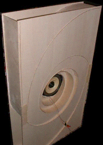

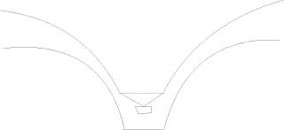

Since horns have so many variables, it has much more design flexibility to achieve a wide range of design goals. Obviously, if the calc'd throat is larger than the filter chamber, then you have a driver mounting hole the same size as its Sd (or whatever portion of Sd will fit) on whatever size baffleboard is required to terminate the horn's throat: http://home.att.net/~lkalin/gifs/downstairs.jpg (note late '40s Altec A5 theater horn doing center channel duty) This is for illustrative purposes only! This driver's specs didn't dictate the throat area, rather this horn represents just a small 'slice' out of a much larger, longer compression driver design and only loads the driver over a very narrow BW to extend the multi-cell's gain down into the midbass.
Qts has no bearing on the filter chamber's design beyond determining the mass corner if you're using it to set the horn's Fh. That said, when Qts = 2.0, then Fs = Fl = Fh (zero BW). IOW the ideal horn's sole function is to flatten the huge peak this creates enough for it to have a flat response to Fs. In theory a filter chamber is still required, but due to the need for a negative pressure compression chamber to accomplish this, there's no real point in providing one.
This negative pressure requirement that many BLH designs have causes the driver's excursion to be non-linear, but unless driven hard it's not audibly obvious unless it's a fairly wide BW design, and since it's most obvious down in the BW where the room dominates, even designers 'in the know' usually ignore it since they're more interested in as compact a design as practical.
