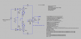

4P1L triode PP (40W!!?)
I am new in LTspice. For very first simulation I made PP with 4P1L in triode. I do not know if my simulation is OK. I got 40W (!!?) and 1% THD.
Is my schematic and meauser OK? Please comment.

I am playing with this schematic for several days. I know that the 4P1L is "only" 10W, but I am curious why I get this result. Because of schematic? Because of tube model? Or beause LTspice does not work 100%?

Models fail to detect faulty start conditions. Thats where the users intelligence is essential to understand the limitation of the model. Spice doesn't understand power limits - it simply amplifies within the parameters of the valve stages and the input conditions. As was pointed out - your mistake was to input far to much signal to the outputs.

I did not know that. Thanks for info.

As already pointed out you cannot drive the 4P1L's with 260V signal. As it is a simulator valves will not get red hot and the amplifier won't disintegrate. This is not a fault of LTspice but yours. It will work as long as you feed it with sensible numbers....
Also 1K8 load is just too low.
I don't know if Ale has refined the model for positive grid region but it should be fine up to +10V grid voltage (except for the driver requirement of power drive). It is surely based on real curves. This means that if your bias is -24V you should only apply no more than 78V peak-to-peak signal to the grid not 260!

Something like this (14W)?:

I haven't refined the model for A2 operation as I don't have(yet) grid current traces. I have recently refined a model for the 814 and 4-65a in triode mode as transmitting valves generally have grid current curves available. Dmitry refined the grid current model replacing the classic diode one with a better curve model which matches the exponential grid current at lower anode voltages.
I will publish these new models when I get the time.
The new 4P1L model performs more accurately than Dmitry's at larger voltage swings, but clearly will not represent A2 operation well...

I was getting 5W from one paralleled pair in A2. You can't get more.
Soviet push-pull amp that used one 4P1L as a driver with interstage transformer driving a pair of 4P1L was rated for 10W output. However, it was battery powered, so I don't expect high idle current.
