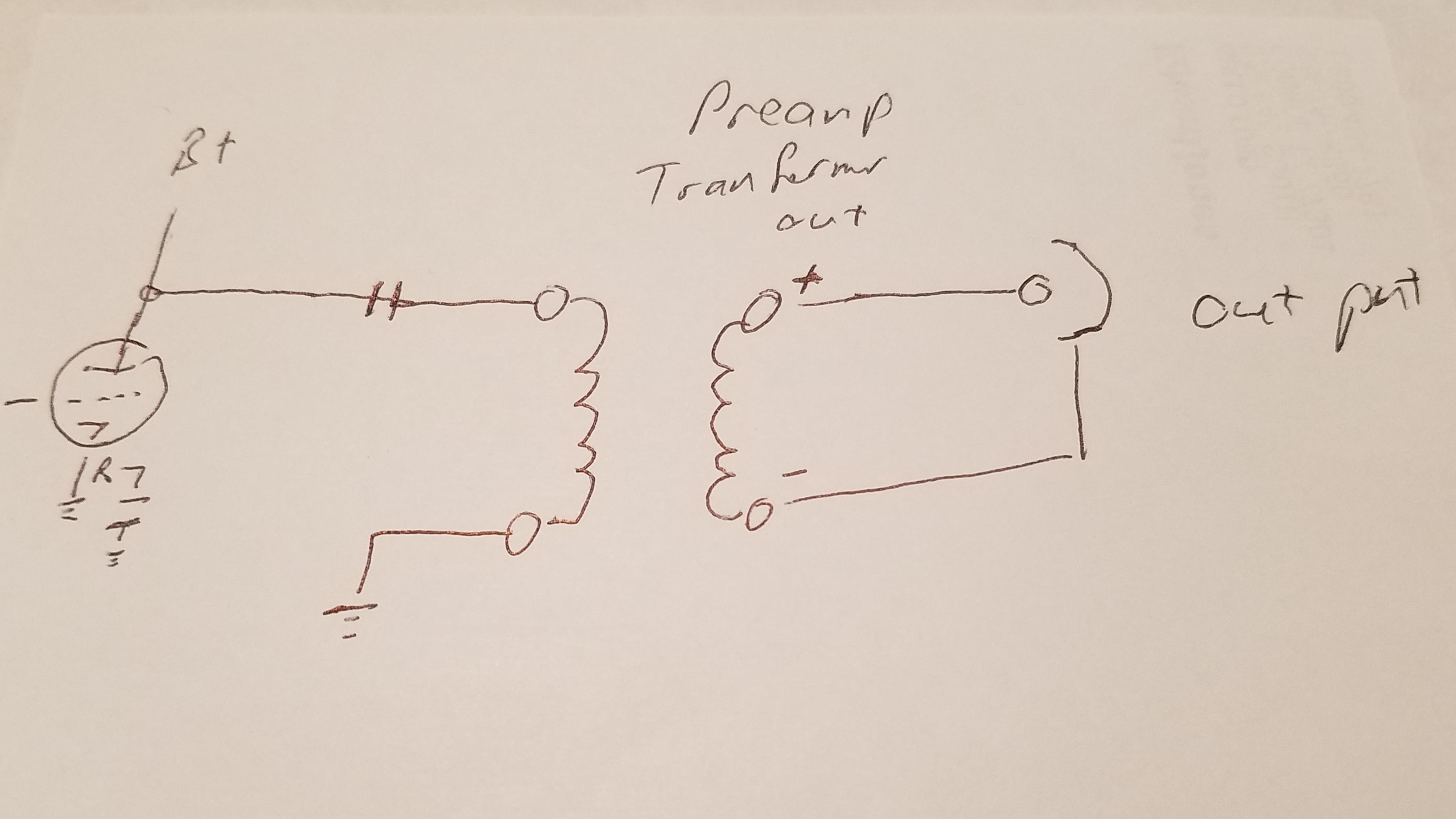

I am building a 2p29 version.
Planning on TVC on the output as below.
My question is do I need the resistor across the output yo ground to load the input of the amp or will the TVC do this ?
