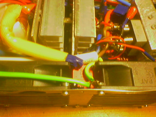

First of all, I am very glad there is this much interest in my problem. Thank you all, guys.
Originally I have got two 100uH, but really BIG inductors for both positive and negative rail separately, followed by 3x330uF/100V Panasonic EB series caps per rail. The filter is made better than calculated (originally 60uH and 30uF would suffice for 10% current ripple at full load)
I am attaching a photo of this.
As entire control circuit is on the secondary side (I drive the MOSFET gates through pulse transformers), there is no optocoupler in the feedback loop. Just a zener diode and a voltage divider to set the desired voltage.
The third modification made now was putting a 100pF/1kW cap and 100R/2W in series paralelly to main transformer's primary winding. Previously, I had them there for evaluation, but I removed them... don't remember the reason. But now I put them back because I think it may help reducing EMI.
NOW THE RESULT:
-Really significant reduction of EMI into mains, input and output cables and into ether (now I can put the mixing console right on the amp and there is no audible hiss or noise anymore). Anyway, there is still significant interference with VHF mics at the events, I can even see both diversity A-B leds bounce to the bass
I would really like to fix this, because now I have to increase the squelch setting of the VHF receiver and this decreases the mic's maximum working range.
-Better voltage stability (before, the LEDs connected thru resistors to + and - rail against ground were visibly showing the voltage fall at full-power bass peaks. Now, the light has significantly more constant intensity, telling me that voltages are more stable.
-Better start-up sequence and small load operation(before, there were large VPP and VNN oscillations of about 2-3Hz and 30V amplitude, that caused the chips in both amplifiers go into undervoltage protection with only 1mA current draw. I had to toggle the power switch several times and if lucky, it started up 🙂
Now, I can only see a voltage drop right after the amps get from UV protection to normal operation mode, but I think this may be caused with large supply soft-start capacitor (47uF), who causes the PWM duty cycle, and supply voltage respectively to raise slowly.
I am sorry for the quality of attached photo, but it is taken only with mobile phone's cam. I do not have a digital camera.

You're right, this is the original schematic. I have no schematic but I did the changes discussed.
Added snubber consists of 100R/2W resistor and 100pF capacitor. I did not ever measure primary waveforms (too high voltage for me
I did not add that 22pF to OSC_OUT, but I have made other modifications which I have explained in another topic
(sorry but i don't remember them right now

Well, I have unmounted the control PCB and chcecked it especially for you 😉
now I don't remember which pin is "comp" and so on, so>
560pF and 10nF in parallel from pin at the edge to ground
10k resistor from pin at the edge to the one next to it.
