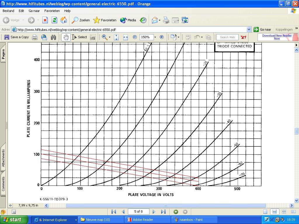

I've got some 4K7 output transformers I'd like to use for a SE 6550 project.
I've been fiddling with load lines, and came up with this:
My gut feeling would like me to use a steeper line, is this advisable? I'll use more current anyway, but the xformers are really good 🙂
Thanks!

What is your B+ voltage.
From the load lines it seems like around 250V. It's pretty low....
With a load of 4k7 I would suggest a quiesent point at approx 400V 80mA
Should give you approx 7W
/Olof

I have build Simple SE's with 3K, 3.6K, 5K, and 6.6K OPT's. I like 5K the best but I run about 460 volts of B+. About 40 of that is dropped in the cathode bias resistor, and another 10 in the OPT, so the tube sees 400 to 410 volts.

Hmm, using a 3.5W EL84 OPT for a 10W-ish KT88.. Good idea? 😉

Someone knowledgeable suggested I use those Bocama trannies for 6550, they could handle the power. In that case my SE trannies probably will do fine, it's about double the power, not times ten.. We'll see/hear it, right? 😉
