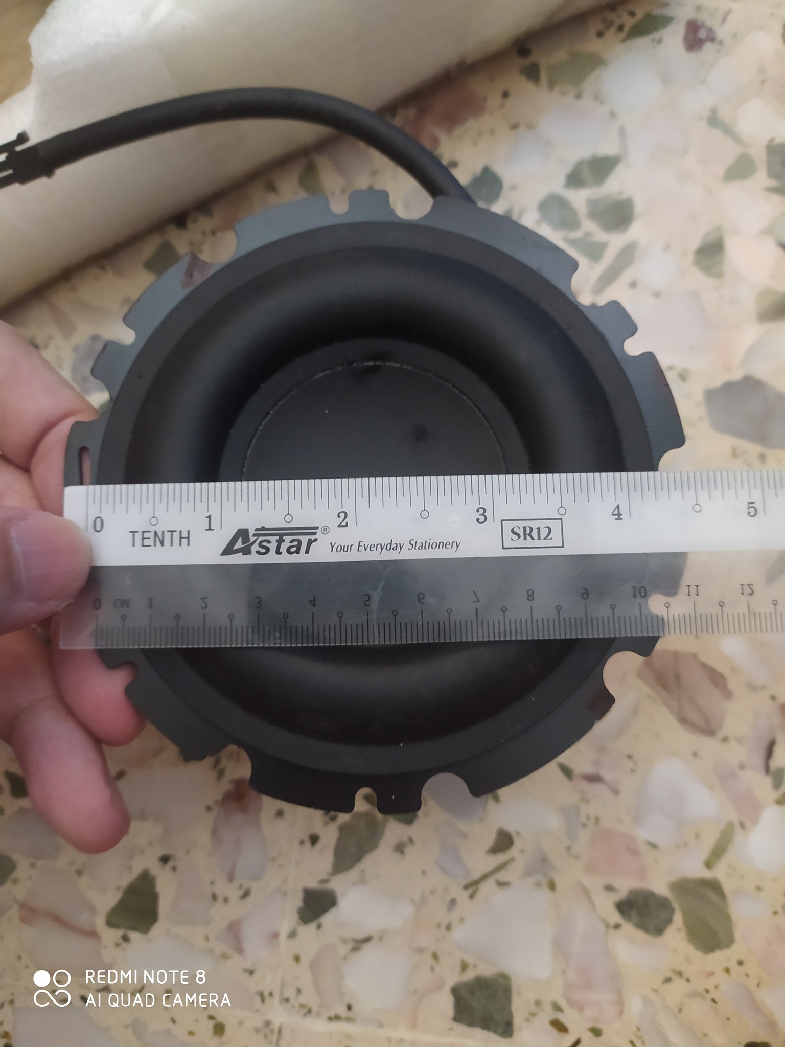

i here have a microsub woofer 4inch diameter with a huge magnet and around 1.5inch voice coil diameter ... the surround is rubber roll and it is a long throw high excursion woofer but it is easy to push the cone down ... tried in a ported box currently around 9 liters tuned to 40Hz bass was quite ok but at the risk of reaching the xmax easily looking at the driver moves so easily
So now i was about to try something else ... i tried in a sealed box of about 2 liters it sound ok too ... now i would like to combine these two chambers together derive it into a 4th order bandpass enclosure (sealed size cone surface ported side = magnet) making the sealed chamber smaller so it could control the cone excursion then add abit shelving / Peaking EQ to boost the bass ... will this approach work?
just a side note when tested free air the cone moves quite alot but bass not really can be heard ... unlike large woofers ...

Ok this driver unit just came to me past few days ago only have the time just to try to mess Around and experiment with them before taking the TS parameters ... If I am about to measure the parameters what type of characteristics I would expect from this driver ? My guess low FS and high QMS and QTS might be ��

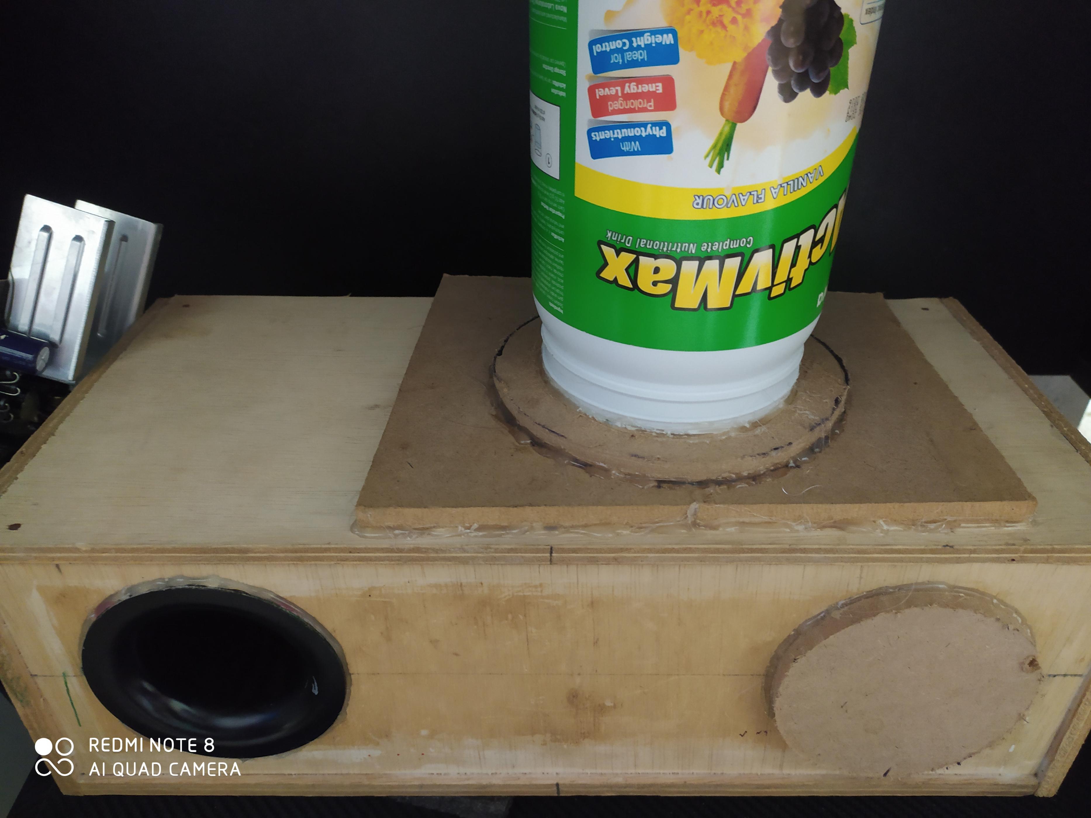

Currently it was converted to bandpass ... Around 2 L for sealed and 7 Liter ported magnet facing ported side
There is a peak around 70hz but so far it sounded really nice ... This is a test box real box yet to be done ... Will include a transparent removable arcyclic panel for access the driver and able to monitor the excursion through the transparent window
