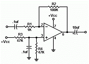

Simple answer is you can't.
To make an individual discrete buffer inverting requires an additional stage or a total reconfiguration of the single FET but it then would not be a buffer.
Far better if you want phase inversion would be to use a single inverting stage at the output to invert everything. An opamp is the logical solution for that.
Do you have an example circuit for 9V supply?

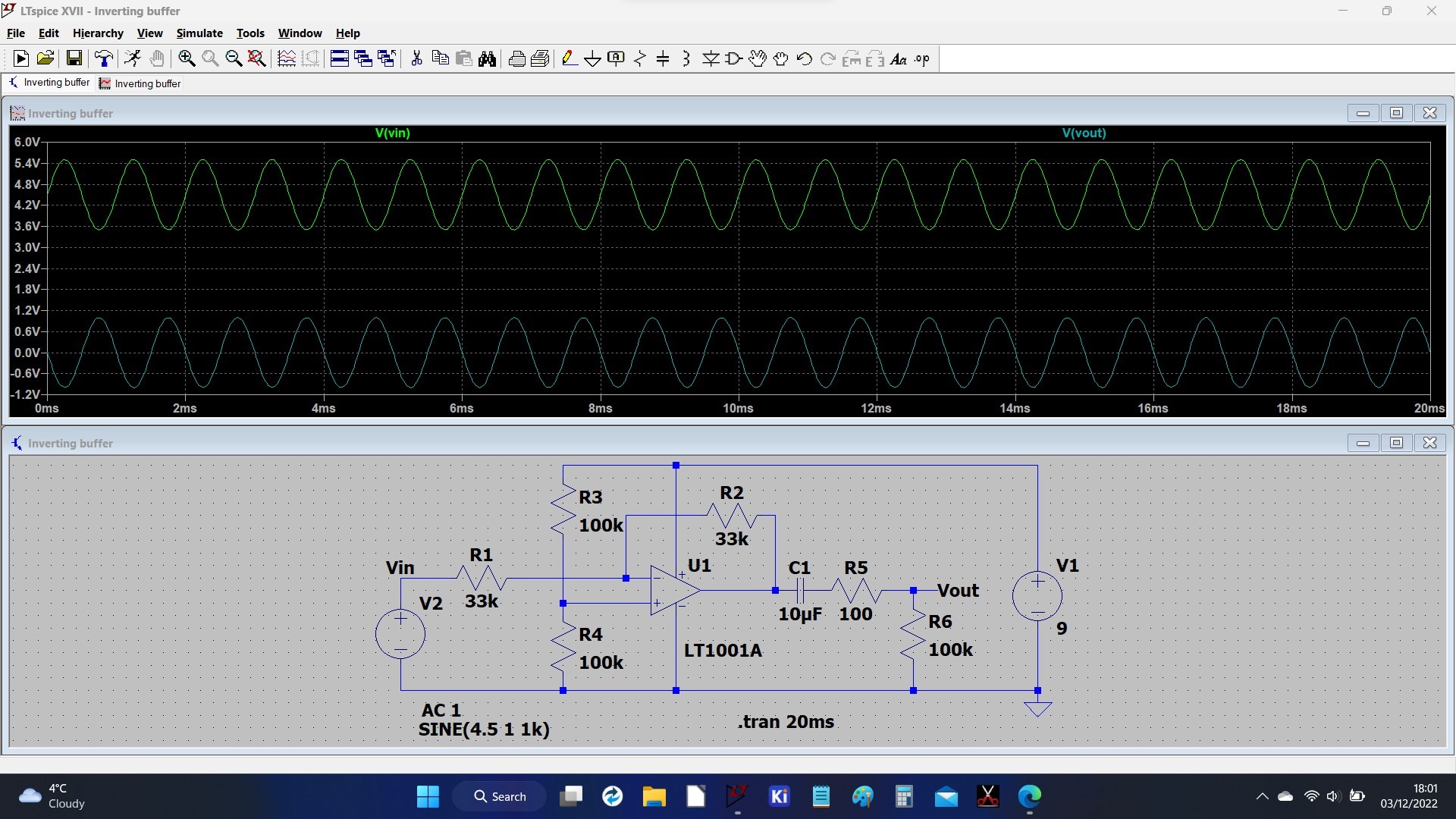

It would be like this. The gain equals -(R2/R1) the minus denotes phase inversion. So two equal value resistors give a gain of -1
R3 and R4 generate a midpoint voltage equal to the supply divided by 2. Keep the two resistors the same value in the 20k to 100k range.
The input is DC coupled from the FET driving it but this does assume the FET is also biased to approx half the supply. You can AC couple, but this saves a cap.
C1 AC couples the output and provides a ground referenced output voltage. R5 and R6 are good practice although some would omit these... you shouldn't.
You can see the phase inversion of the output signal here. The opamp should be a low power rail to rail type if you are using a 9v battery although it will work with pretty much any common device.

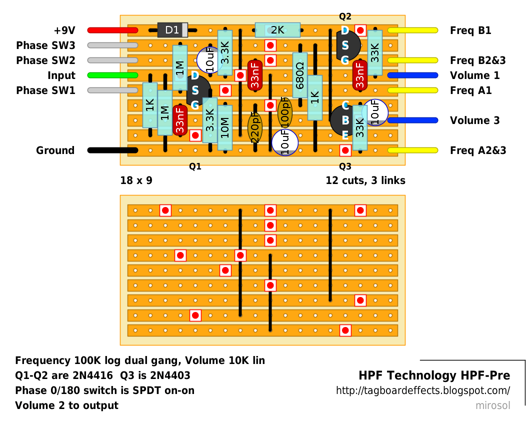

Anyway, I just discovered a veroboard layout for a preamp specifically designed for double bass piezo signals. The main advantage is that it has a built-in HPF and also a phase switch.
Can I just use this as the master buffer in my design after the individual JFET buffers have been summed?
Would need to see the circuit diagram... or you can draw it out from the layout 😉
I can try....
But I guess if the design works for high impedance piezos, it should also work with a buffered signal, right?
Since there is only one input (as opposed to Input+ and Input-) I would assume that the phase reversal also remains functional.

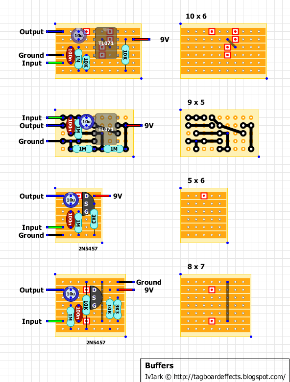

I wonder if I could just put all transducers in parallel and use the very basic JFET buffer without a HPF or any trim pots (third one in the pic). That is apart from the regular tone and volume controls in my bass obviously.
In my latest tests the string to string volume was pretty even so I don't think I even need individual trim pots and opamps or multiple buffer stages.
What do you think?
Is a HPF necessary to avoid speaker damage?
How would the behaviour of the transducers change when put in parallel?
