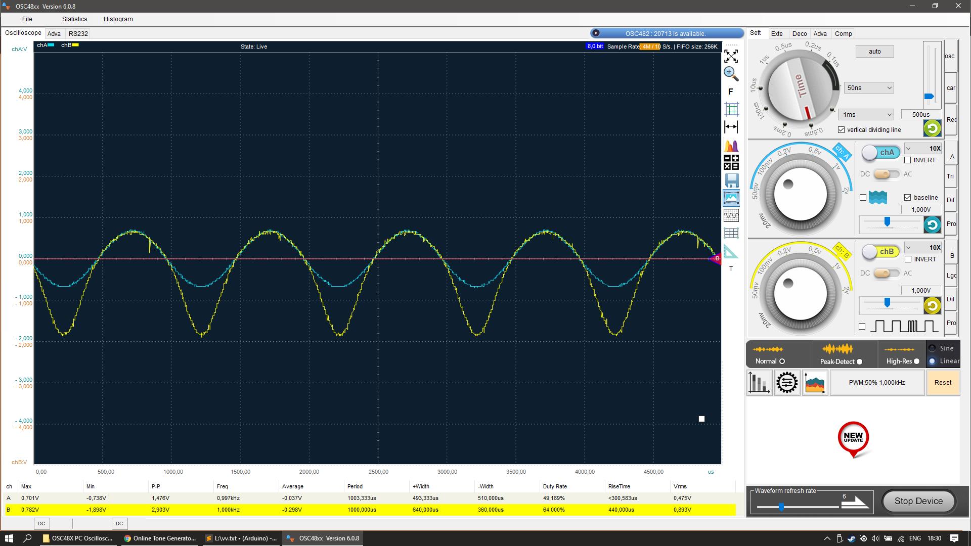

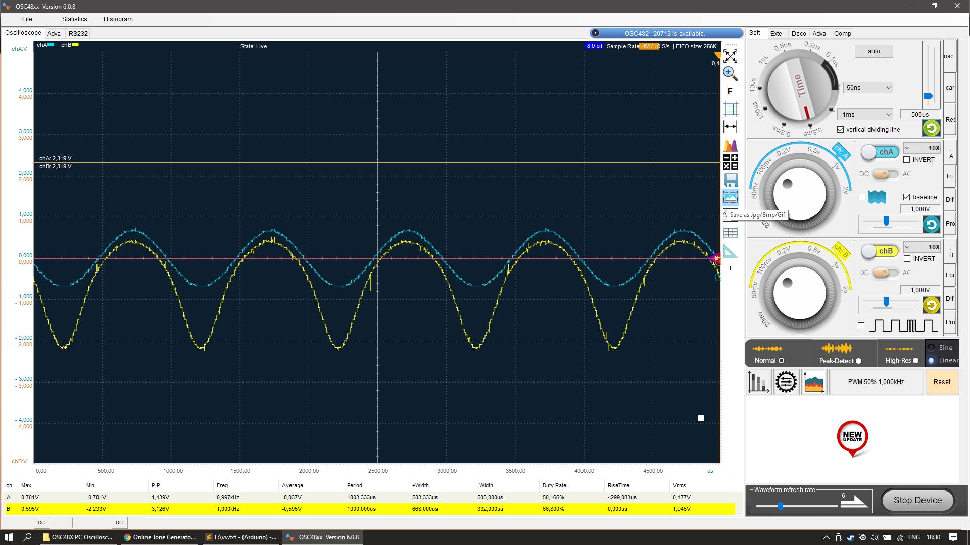

With the BJT's removed I get 250mv between Base and Emitter pads on the board.
Attached is my scope results of 1KHz test tone, Blue is input, Yellow is Emitter pad on first pic, Base pad on second pic.
If I adjust the gain higher the signal starts clipping on one side only and distorts even more!
What could be causing this?

I am trying to find out where the signal is being corrupted by probing around.
I see output of the op-amps NJM4558L have a beautiful clean boosted signal of about 5V.
Just after this the signal goes through R330 where on the other side the signal is very small, looks like it's being pulled to ground.
So I see on the other side of this resistor there is a transistor Q313 S9013 which is between ground and base is connected to something called VT ?
Can anyone explain what VT is ?
On their other side of the schematic I see it's involved with the TL494CN PWM controller and the Protect LED is in there too.
So I'm just suspicious of this VT line because I notice the protect LED is stuck on. Maybe this is something to try disable the input signal when protect light is on?
Yes my suspicion seems correct! 😀 I removed the S9013 transistors and now the signal on the output stage BJT is a perfect sine wave!!! The bias measure between base and emitter on output BJT pads is between 0 and 1V depending on the gain while playing the sine wave. Hope this is correct ?
Does anyone know what this VT line is ? If I fix the issue triggering protect light and VT maybe the amplifier will be repaired?
This feels like such an accomplishment I'm going to sleep well tonight.
Amplifier repaired! Replaced Q20 and Q22 on the schematic with generic 2N3904s I had lying around and deadbugged 10KOhm base resistors 😀 works great now.
Seems like when the power supply went blam it damaged the protection circuitry. The failed transistors were holding the amp in protect and attempting to disable the Input signal using that VT line.
