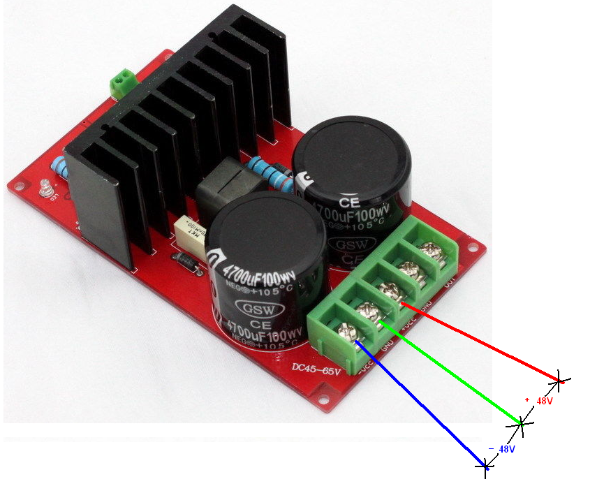

I bought one of the IRS2092 dual voltage boards off of ebay: Assembled IRS2092 Mono Amplifier Board DC Power Supply 350W | eBay
I also bought a 350w 48v power supply. The specs on the listing say that the operating voltage is DC + -55V, but the board says "45v-65v". When I measured the output of the power supply I was indeed getting +- 48v.
When I hooked up the board, I'm reading more like +- 24v on the positive and negative board inputs.
So I am thinking that the problem is that I didn't account for +48v to -48v which would mean I actually need ~96v. OR the board is incorrect and I actually do need +-55v and I am actually 7 to 10 volts shy.
Are either of those correct or am I way off base?

The amplifier requires a dual (symmetrical) power supply that outputs +xx and –xx DC Volts in respect to the center 0V rail.
I am afraid that the power supply you bought is a single supply +xxDCV in respect to it’s 0V rail.

48 VCT at 7.3 A would give you the 350 W rating. My bet is that you're getting +/- 24 under load.
That's sort of what I was thinking since I was seeing +-48v before I hooked up the board.
So I suppose my next question is how I should proceed?

This PSU is single ended.
The marking is +V and -V simply because the outputs are DC floating.
48Vx7.3A=350W.
(2x48)x7.3A would make 700W
Sanity check:
Play this amplifier at low levels. Measure the supply rails. Such an amplifier working at 2-3Watts can not load a 350W PSU to the extend of halving it’s output.

So would it be insane to buy a second psu (like the first) and wire the +vcc of the first psu and the -vcc of the second psu to the amp, or will I still see the same voltage drop? Or am I just stuck buying a 700w power supply? Thanks for all the help.
Going back over all the replies, the answer sticks out like a sore thumb. George (gpapag) was right from the get go. Sorry for being so thick headed. Now to dig through the site looking for the most cost effective SMPS threads.

I have built an L15D irs2092 based amp and used two 48V supplies (meanwell NES-350-48) wired in series with the PGND connected in the middle of the series. I am currently troubleshooting a ground loop (my RCAs accidentally contacted enclosure ground which I did not want) but otherwise seems to work just fine. Make sure if you do this you adjust both supplies to an equal voltage before connecting the amplifier modules.
