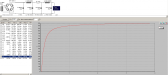

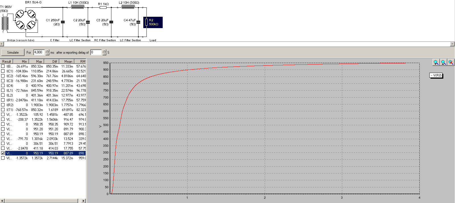

Hi, as simulated in Duncan amps PS Designer II
This will give you a voltage of around 950V. Well within the spec of the GM-70 and the voltage should come down to around 750 V with a load of around 200mA...
Thanks *quikie22*.

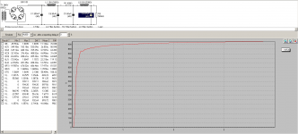

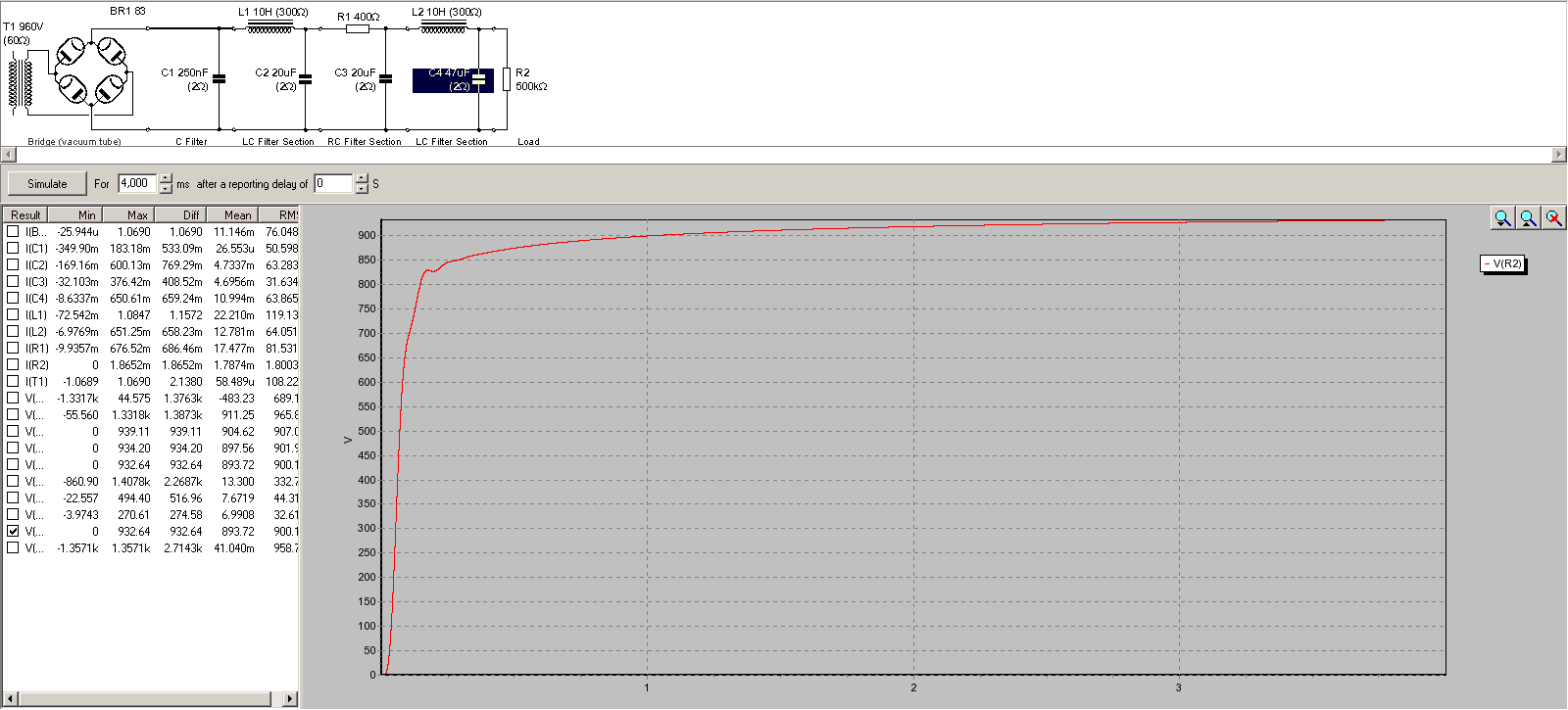

Hi .... I'm indeed grateful for your desire to help-out! :happy2:
Can I use IN5822 or .....?
Can I use a #83 mercury before C1 ?
Now, I can proceed with confident to build it on a breadboard.
Cheers!
Zekk
do a google search for Duncan Amps PS designer 2. It runs on Windows and allows you to simulate most power supplies. You can design any power supply you want using tubes or solid state devices. 🙂 In fact, it would be best to do the simulations yourself as you will have the exact spec of the devices you will be using. As is, I am guesstimating the specs of your devices hence follow the recommendations of the simulator at your own risk!!.
Anyway, as requested, a #83 PS.
Zekk
1N5822 is a low voltage Schottky diode, I think with max PIV of 40V. Not really suitable application in this circuit. Unless you wish to serialise at least 25 of them for each limb of the bridge making it a total of 100 diodes for this circuit :-D
A viable option would be serialised pair or triplet of 1N4007 or 1N5408 if you wish to use solid state rectifiers. However do not that the final voltage will be much much higher due to lower losses in the bridge. If you wish, there are also fast recovery UF4007 that can be used.
