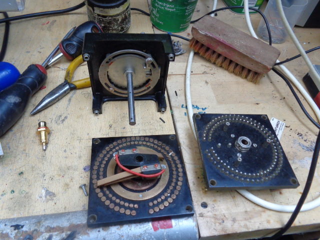

I.ve got some really nice 50 pole ganged SW's, gurt big heavy duty jobbies which would make decent stepped attenuators, however it'll be a nightmare trying to buy 2 of each R value from Farnell/Digikey etc, especially if I go down the SMD route, as these are usually only available in multiples of 100's on tape.
So does anyone know of a good source of just the resistor kits? All I can find is SW + R kits.
If I've calculated correctly I'll need 100k series 48 X 1.25dB. Still getting my head round this complex subject, forgive any mistakes please.

Looking again at the switches I have in more detail they may be best suited to a ladder type attenuator. Each wafer ( two wafers per SW )has 2 x 50 contacts in parallel, see pic.

As I have a pair of these so I am following with interest!
I was told that they came from 50s radar equipment. They are beautifully made and I would like to find a use for them.
"As I have a pair of these" You do? I've not seen anything like em before and thought they were Post Office as was, as you say they are well made and should last 100 years. I would think they're ideal for attenuators as they're make before break.
