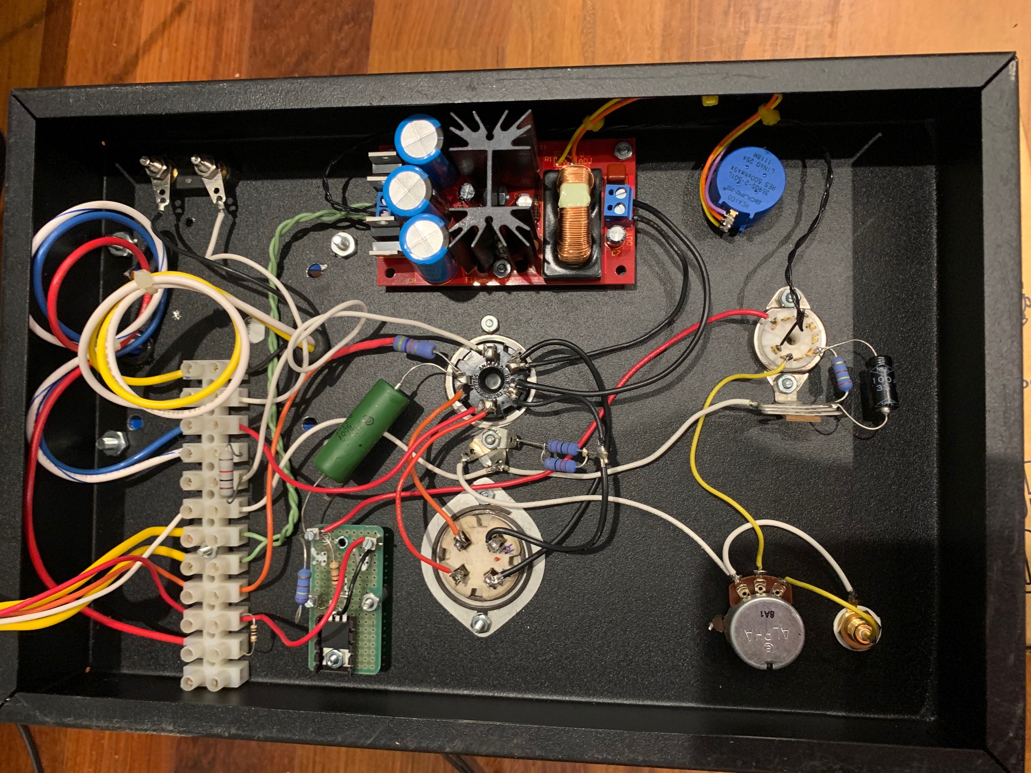

My current "flex" version of the old Simple 45 circuit has provision to use 4-or-5 pin power tubes with a 417A/5842 driver under a CCS.
I'm working on a pair of 300B monoblocks to replace it (for improved WAF), but before I cannibalize it, has anyone used a 46 driver to a 300B in SE configuration?
I have a small pile of 46 tubes (as well as low power triodes like 76, 56, 71A).
I was pretty impressed with the linearity of the 46 as a power tube, just didn't have quite enuf power.
I doubt that a 46 alone has enough Mu without some input help (another stage? a step-up transformer?), but perhaps a 9-pin/46/300B arrangement?
The sockets are already in there; would just need a little rewiring...

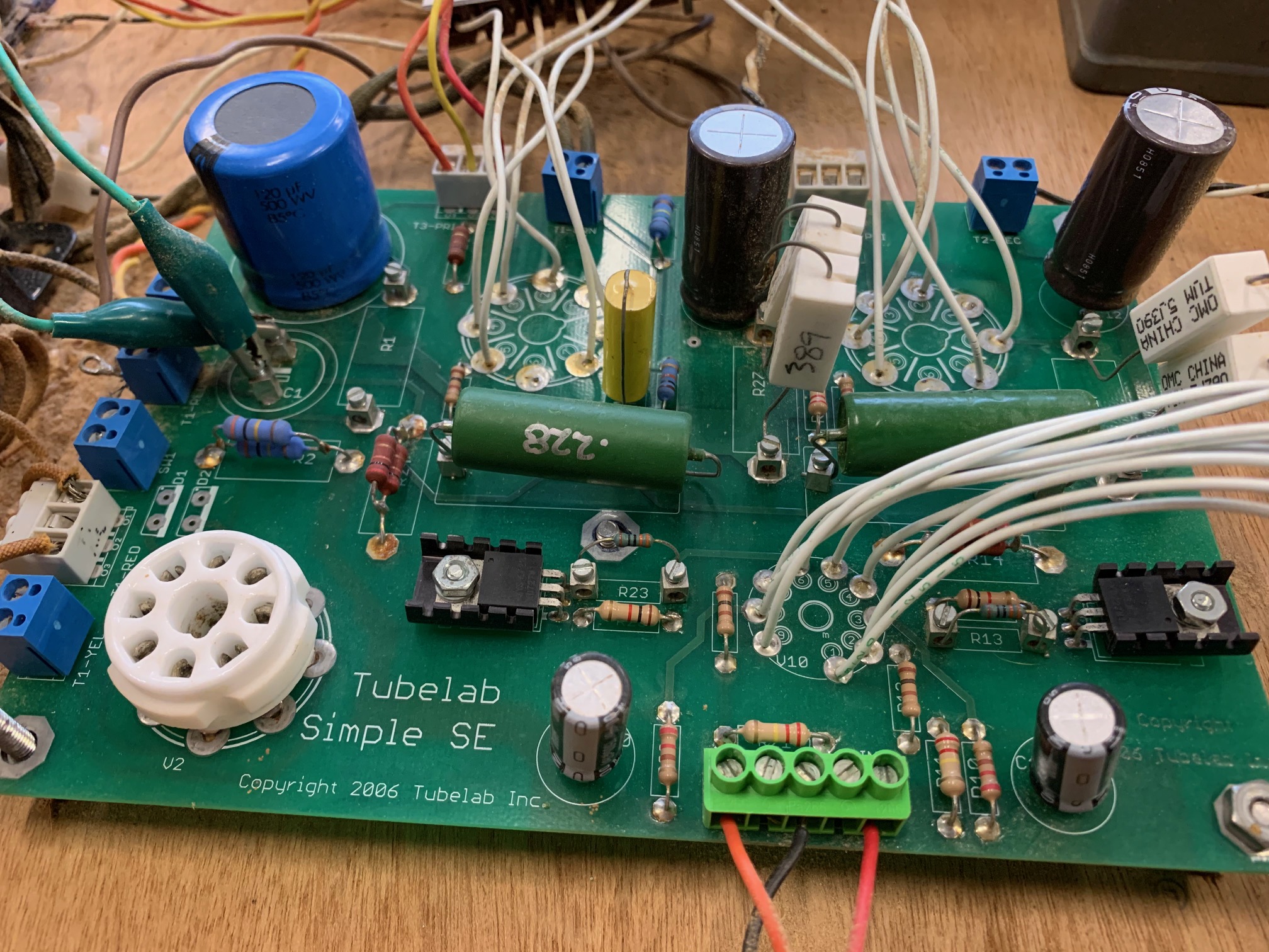

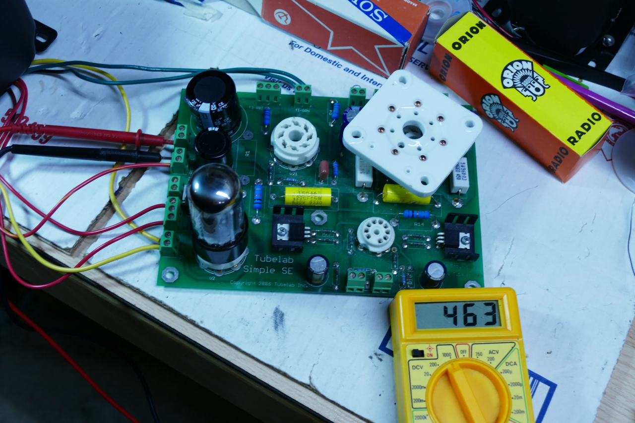

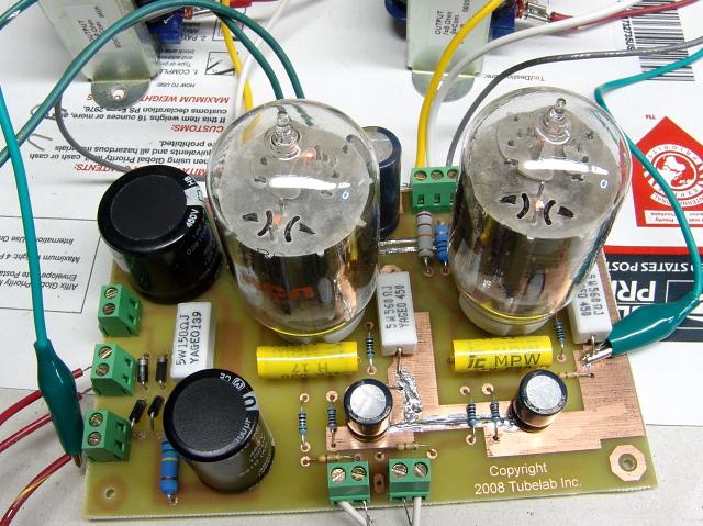

I hacked ( literally ) an SSE board to use four and five pin directly heated power tubes.
If mu is the only consideration, I don't see how 46 can get you where you want to be. 47 should, with a bunch of mu left over.

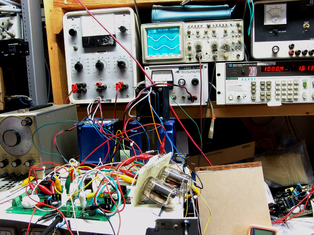

Toward the end of this thread, you can see some crude measurements of the relative performance of each as power tubes.

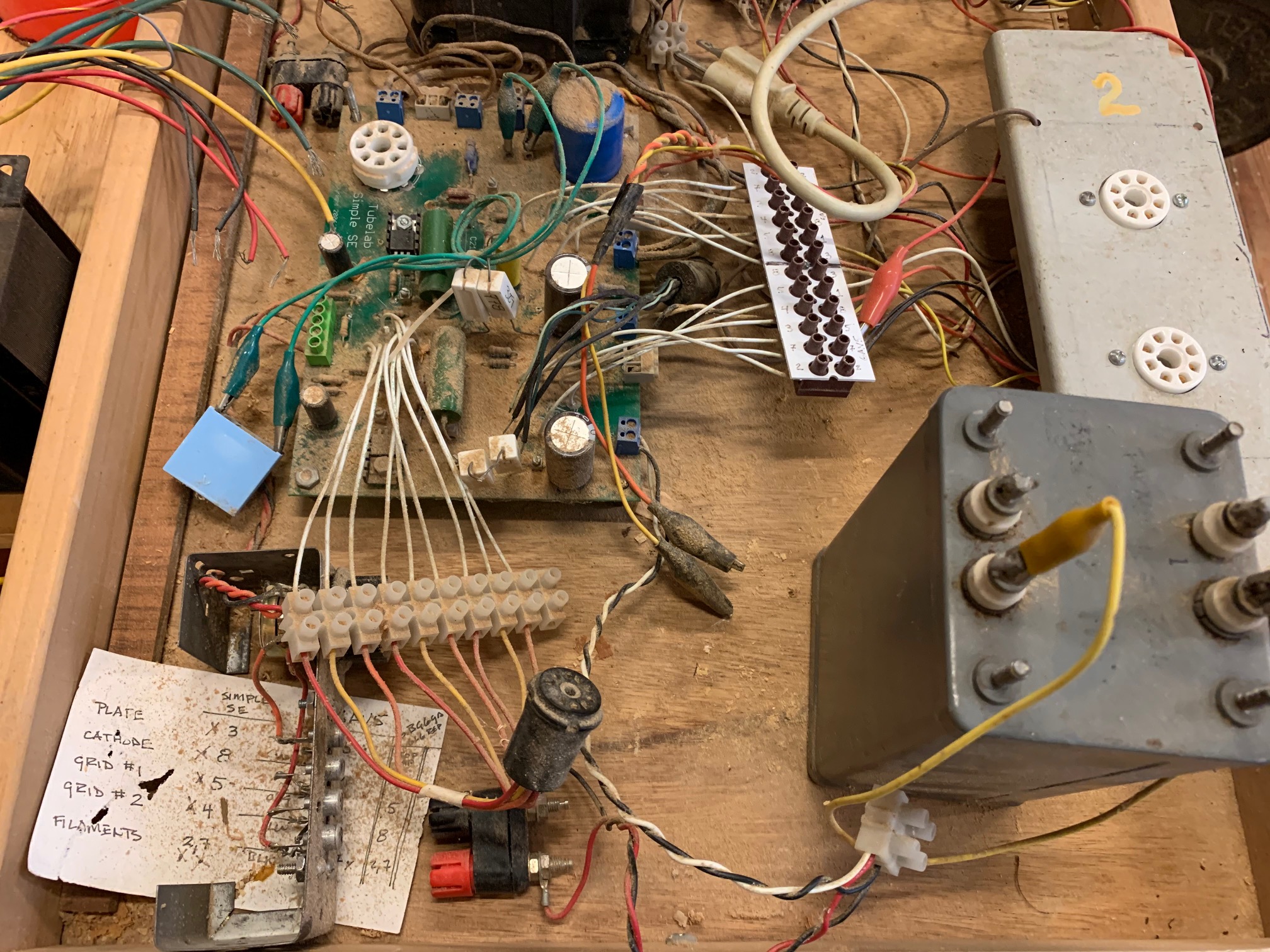

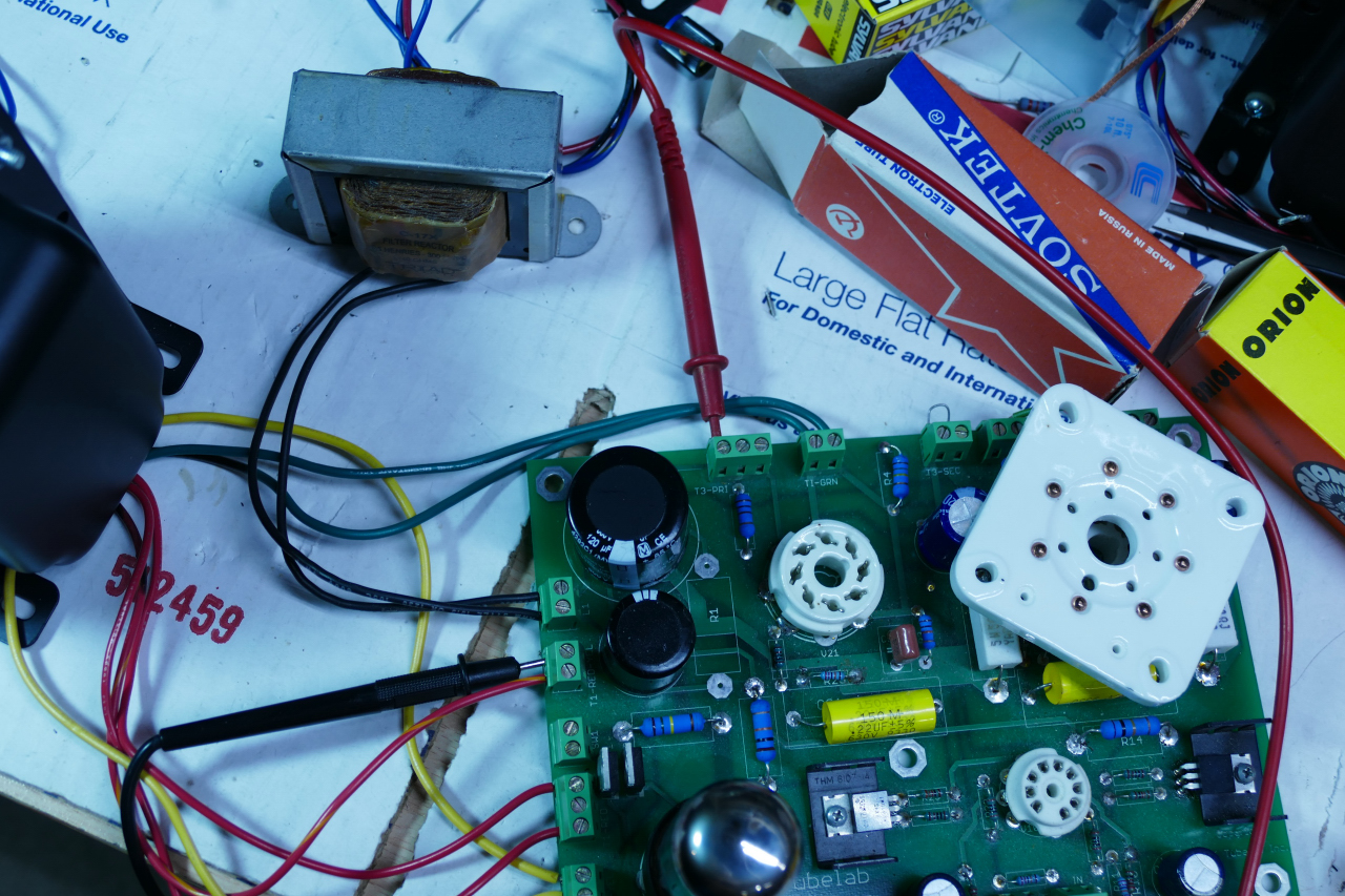

I did a similar hack on the RatLab "amp in a drawer" (now covered w/years of cabinet making dust) to use random octal power tubes (esp. the 6AV5) and random 8-or-9 pin twin driver tubes. Never thought to use DHTs. Hmmmm.

$150 for a pair of 307A's? I had over a hundred of them took them to hamfests and put them on Ebay for over 10 years and rarely sold any at $20 each. About 2 and a half years ago I bulk sold most of them in a three way deal with ESRC and another seller. Unfortunately that deal went bad. The end buyer claimed that ALL of the tubes were defective and never paid Stan. I asked that the tubes be returned to me for verification. Stan never got them back. We agreed to split the loss, with me receiving about $7.50 each in credit for tubes at ESRC. Unfortunately I never got to spend all of it. I have some 307A's left, but I don't know how many. I do plan to make a push pull amp with them someday using my Universal Driver board.
I got the 307A's and over 100,000 tubes in exchange for three or four weekends worth of manual labor that involved four 450 mile road trips to clean out the warehouse that they were in. The derelict warehouses were being demolished when someone decided that the some tubes contained mercury and declared the whole place hazmat. I took all the tubes while my buddy (a surplus dealer) took everything else.

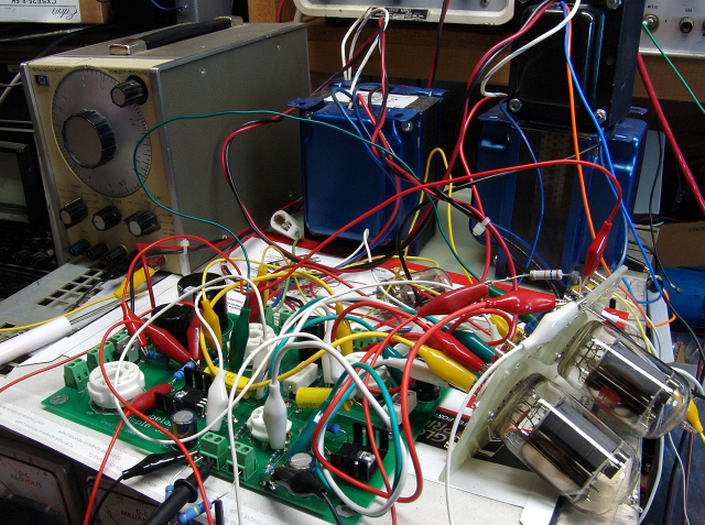

This all occurred when I was designing the original TSE, so I stuck every potential driver tube that I had (over 100 different tubes) into a test board and took measurements as well as listened to the good ones. The 5842 was about $5 at that time, and was the best choice for a clean driver, so that's why it's in there.
There were some other decent choices, but the 5842 was the best. Old style 4 pin DHT's with enough gain to drive a 45 or worse a 300B tend to be microphonic, so you may have to isolate it from vibrations.

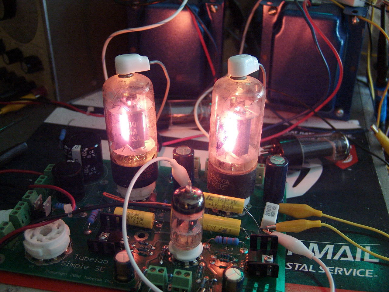

Slap that board in the dishwasher, and it'll look like new.
I laughed when you said that, but after exploding the second electrolytic in my personal test SSE, I tried it. The ugly board became far less ugly.
NOTES: Do this when your wife is not home. Don't use dishwasher detergent, It's rather nasty stuff and tends to corrode stuff. I had already scrubbed down my board with a toothbrush and WD-40 several times after blowing parts, so it was a bit sticky with a slime consisting of electrolytic goo, WD-40, and dust. I drenched it in rubbing alcohol and put in the dishwasher with no detergent. That was probably 10 years ago. The first two pictures show what it looked like last year. It's been living in a box with a bunch of other rarely used boards so it has gained some new dust. I only use it for experiments that may end badly. It was originally build 15 years ago when I got the first batch of SSE boards and built 5 of them for testing.

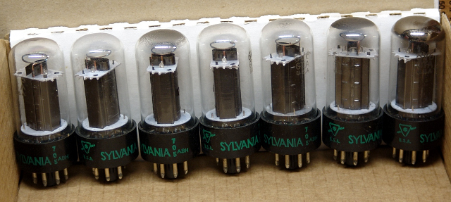

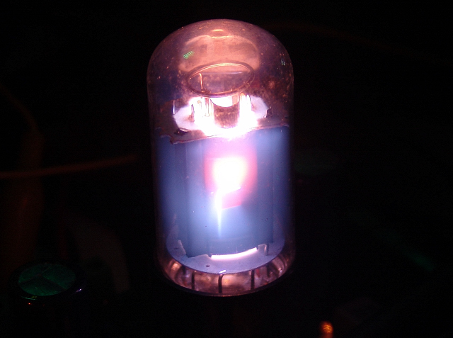

In another surplus deal I got a sealed box of NOS Sylvania 6V6GTA from a storage locker at the NASA facility in Cape Canaveral. I was disappointed to find that many of the tubes had gone to air despite being in a climate controlled facility. I tossed them and kept the rest. Later I found that more had turned white. Today only about 15 of the 100 tubes are usable, and I will not trust them in an amp. Back when I opened the box I got angry at the dead tubes and decided to make some "deader." This is how the first electrolytic exploded.
The poor board also got to "test" some "NOS" tubes that turned out to be not so NOS. They lived their remaining life rather quickly. The board did not blow during this test Those poor little tubes were playing music at about 15 watts per channel for about half an hour when one tube decided to go into runaway. I cut power to avoid a blown cap.
The same board was also used for the clip lead furball that led to a SPUD board design.

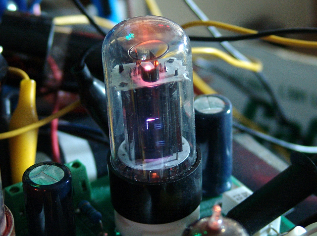

Say, George: Did you ever find operating points at which the 6BQ6 sounded good?
I tried them (in the RatLab set-up) but never found a way to make them work well, but perhaps I was too conservative (as happened with the 6AV5).
They sure were cute, though, with their slim tube and jaunty top-cap.

Hey, kids, don't explode electrolytics and you won't need to put your circuit boards thru Mommy's dishwasher!
Turns-out cabinet-making dust comes off with a chip brush and the Fine Nozzle on the FEIN shopvac.
Note the tiny soldered-in screw terminals for changing components. I use these a lot, even soldered to snap-in cap leads, for example.
The RatLab set-up was pretty good (poor-boy cousin of George's plastic pegboard set-up) but I need a new drawer, maybe with a cover so I can store it on my shop shelves.
