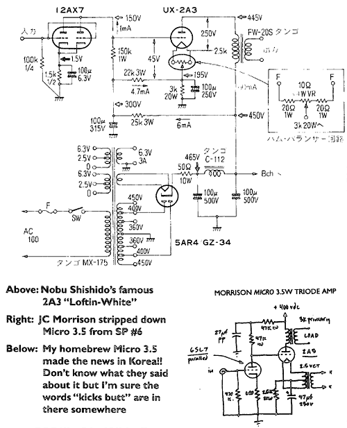

I am planning to build a nice SET too, and I'm thinking that I should base it around the 2A3. There are many old NOS tubes to spend money on if you like, there are also many newer tubes on offer from different manufacturers. it will also give you those 3.5W you are looking for.
As for a schematic - there are so many to choose from and many of them are simple. I'm currently considering a simple design based on what I believe is used in Don Garbers Fi 2A3 amplifier. it's a direct coupled design, a single high-mu triode directly drives the 2A3. others on this forum with more experience than I can probably suggest other options with different advantages.

here are some versions of the schematic that I referred to above - and I don't see why they wouldn't be equally useful for a 45 type tube with allowance for proper operating points

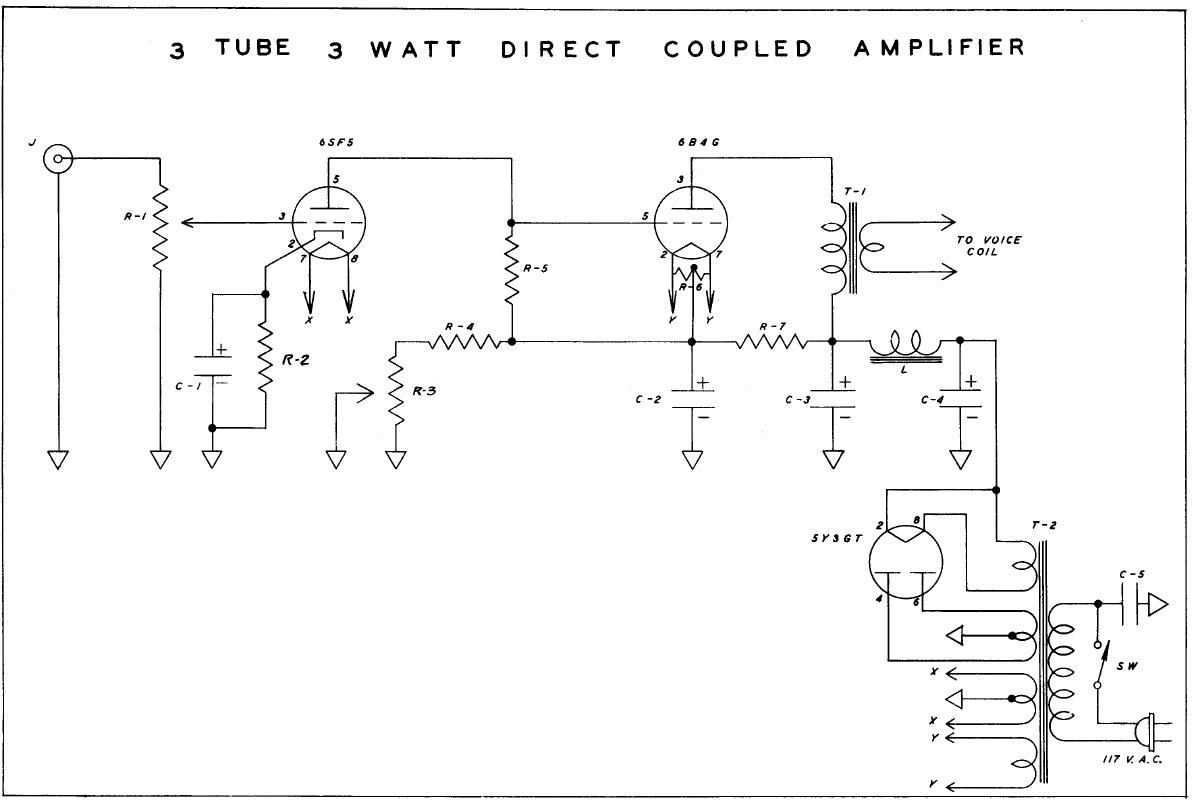

Hard to do better than this
Direct coupled, choke loaded, parallel feed, 45 with a constant current source on the driver. Meets your criteria for simple, and quality definitely depends on the choice of components. Note that direct coupling means you will be working with stacked (high) voltage. Not a good build for the easily distracted. What amp is?
Even though the design is going on 15 years old, all the parts are still available. CCS's may be had in kit form from several suppliers.

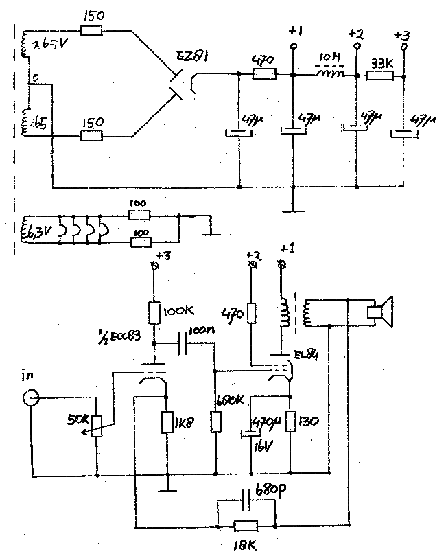

Please consider this schematic, it has exceptionally good performance for what it is, and uses the easy to get hold of EL84 and ECC83 tubes with fairly low complexity. Distortion is also low too, with negative feedback implemented. It is not my own schematic, but over the last 5 years or so I have built about 4 or so of these amplifiers with excellent results. It is not my own schematic and I can't quite remember where I got it from but it really is an excellent design and fits right into your requirements.
I recommend using a fullwave bridge rectifier and paralleling the windings ( or by replacing the EZ81 with a couple of 1N4007 diodes snubbed out with 10nF caps), so you can use higher value caps for power supply and lose the inductor for a 470R resistor, the first pair of filter caps this way should be 220uF (1&2) and 3 should be 100uF. This way the 470R resistor in series with the psu can be swapped out for just a 150R resistor.

I've heard some other SE EL84 amps before, no feedback ones mainly, but this circuit seems to beat them all in terms of performance (or at least sounds miles better, the incorporation of negative feedback really helps), if you use a silicon rectifier then you can make some good improvements to the PSU, which is what I did when I built my second one. It's a nice simple circuit with good performance for what it is.
The trick is to invest a good percentage of your budget in the output transformers.
I built the amplifier point to point and used moderately priced JJ Tesla valves. I used a 25w chisel tipped soldering iron. I wouldn't recommend a small/low power iron for point to point, 25w is the optimum power in my opinion 😉.

About 6000 ohms if I remember correctly, but anything from 5000 - 8000 will work admirably with this circuit.
Hi monty - don't you need cathode by-pass cap on the ecc83 as well? 100uF? or is your feedback loop there to keep things up?
Ian
Ian
A cathode bypass cap would defeat the feedback loop completely as it would also bypass the feedback loop and cause the amplifier to have too much gain and too much distortion.
