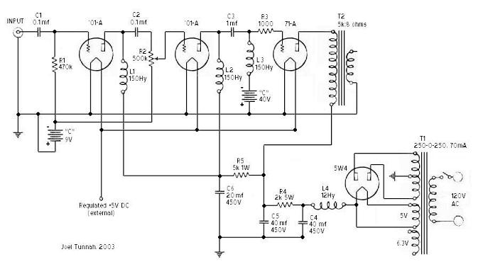

The-Planet said:On another note, what does your 71A circuit look like?

Gosh, I'd hardly call a 01A-->01A-->71A a budget design! The above 6EM7 amp was my attempt at a lower cost design - hey, aren't those Hammond 125ESE's

ANNO 2003.
Goes to show....
Joel, if you want my resume... just e-mail me.
Bygones,🙄
4) You say that, due to your age, you have advanced the state of home audio reproduction. This is amazing considering that nobody living has ever seen a Frank DeGrove amp. They must all be in the hands of private collectors...
Goes to show....
Bygones,🙄
