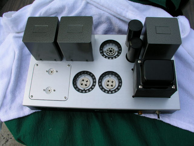

I use 417a to push 45 already.
later use 6C45 interstage to puch 45.

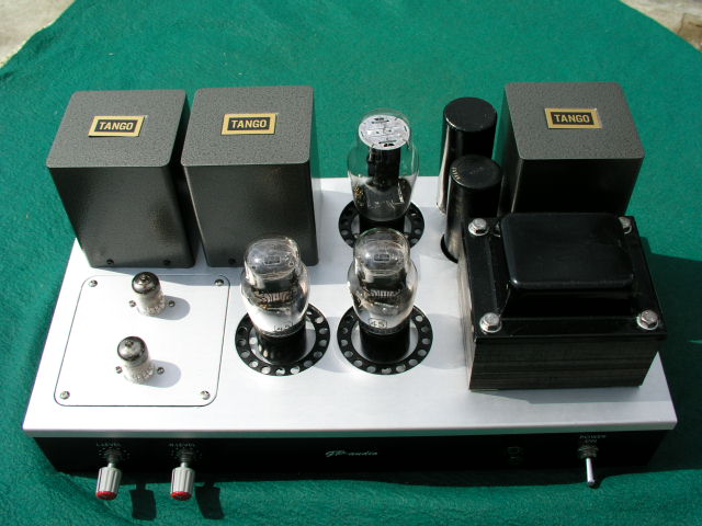

this is the finish outlook of my 417a push 45 se amp.
I use tango iso xe20s c-core output.
I can choose 3.5K or 5K to change the sound quality.
I use this amp to push my 1970's klipish la scala.
1970's still use alnico magnet.
also I use this amp to push my AER too.
thanks
Thomas:bigeyes:
