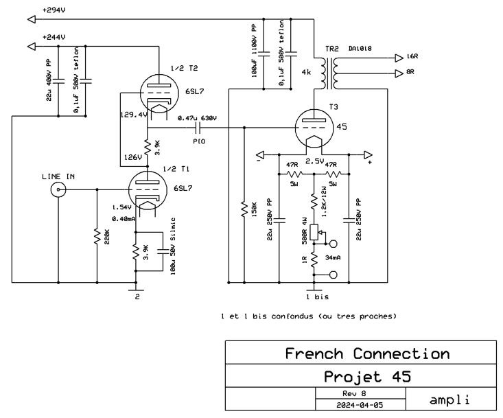

Hi everyone, I am pleased to present my fourth tube electronics project. It is a single-ended amplifier using the 45. This one was inspired by a schematic from the Japanese Isamu Asano. The heart of the design consists of a 6SL7 SRPP upstream of the 45 power tubes.
The interest in this project began about 4 years ago. At that time, I had been able to listen to a friend's 2A3 monoblocks (3.5W) in my high-efficiency system (101-105 dB). I had loved these amplifiers. Then, discussions on a French-speaking forum about the 45 had piqued my curiosity given the subjective qualities announced when using this tube that many enthusiasts around the world have appreciated for several decades already.

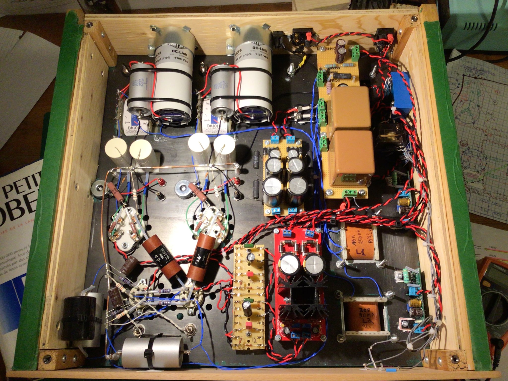

Having no experience in wiring for heating filaments in AC, my friend who already built this amplifier suggested that I start with DC heating of the 45. That's what I did while adding a current regulation with Coleman regulators. I also took a voltage regulation module for the 6SL7 that I had recovered from a previous project.
Once the schematic was specified, I supplied the various components. The output transformers with a choice of 4kO at the primary were wound by Charly Doria from Dissident Audio. It is the DA1018 model. The power supply transformer and the inductors were made by Étienne Tessier (former Hexacom). This is the first project where I left the all-wood chassis to let myself be tempted by a 4 mm thick steel plate for the top of the box. I drew the cuts for this plate on the computer and entrusted the laser cutting to a specialized Montreal company.
At the head of the high voltage filtering, I have a Russian PIO capacitor. The high voltage capacitors of the 6SL7 and 45 are also decoupled by Russian Teflon capacitors for their contribution in the high frequencies. The high voltage rectification is done by a 5Z3 rectifier. I also inserted Sophia Electric's high voltage delay module. The high voltage arrives after about 60 seconds of preheating the filaments.
Here's the schematics:
Amplifier stage:
Power supply:

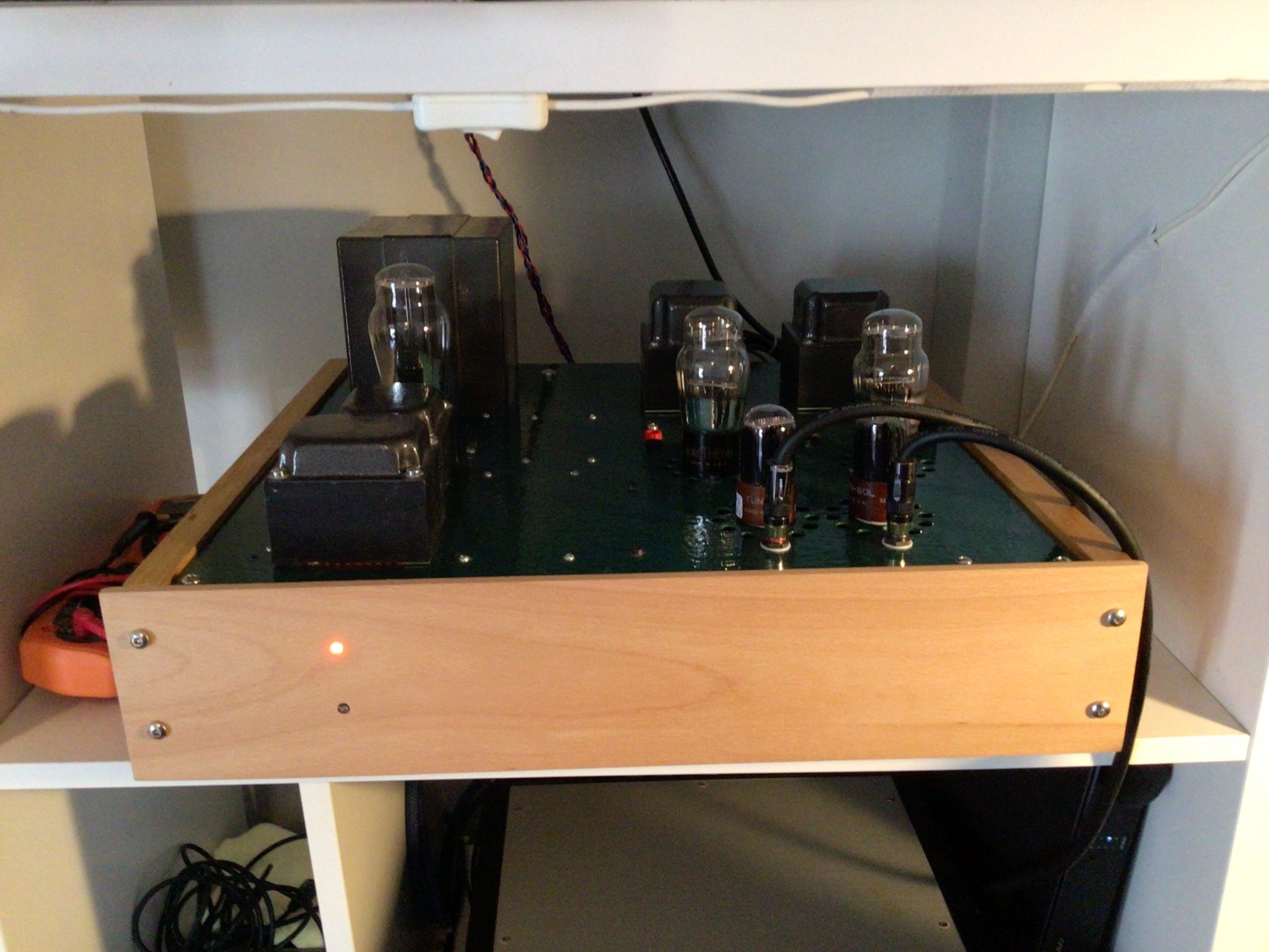

Here is a photo showing the inside of the amp and a photo showing the outside:
I finished the construction last spring. Given the French friends who helped me in the realization of this amplifier. I named it the 45 French Connection.
