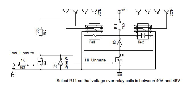

PS5-B infos needed!
Hi there, had the bad idea to say a friend "yeah I can build a 41Hz kit to you".
Sadly at that time I was not aware of which nightmare I did step in...
So for now, as I got one rectifier, one TO92 and... that's all I wonder what is missing and what goes where.
First JP2 pins, I guess the 2 is +5V from HMute, but the second? 1 to the GND of the HMute led? No loop or such? or left open? (grounded seems).
The rectifier is the rectifier, D5 OK.
For R21 and R20 (100K and 1K), I have spare 1/4W metal, is it OK?
R100 is unknow... may start with 1K, no idea at all! Relays are Potter & Brumfield RTD14048 (good for audio?)
The single TO92 I have is BS170A, but is it Q1 or Q2 or both so have to buy one?
DZ1 just anyhting saying "zener 9V"?
How to make few parts annoying to death, 41Hz... @#!
Or maybe leave that away and let the speakers live a risky life ;)
Thanks for any input guys!
Matthieu
ps: drawing from PS5-A but that is the same on B's.
