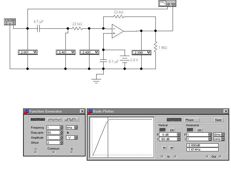

gpapag said:I did though a simulation of the input section of the TA 2020 (in my case is a 3.3uf followed by 22k feed/22kfeedback resistors into the inverting input (pins 10, 13 *)

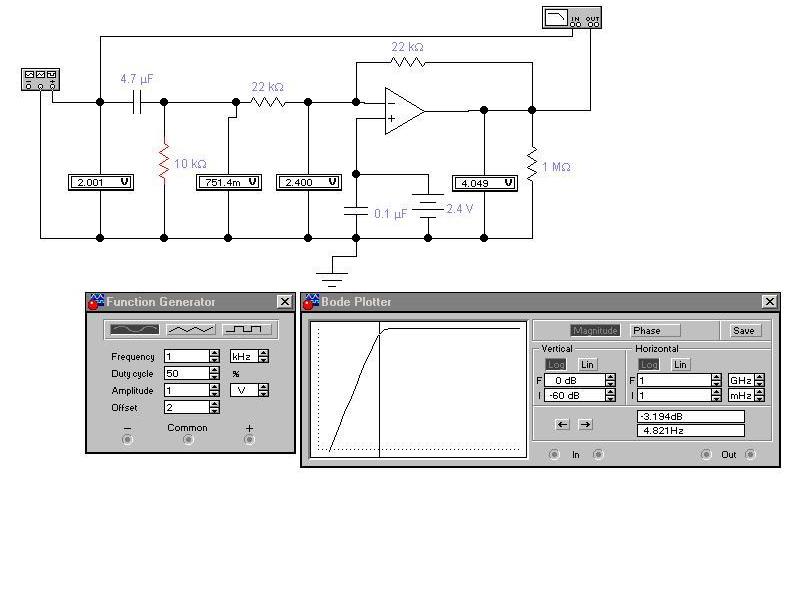

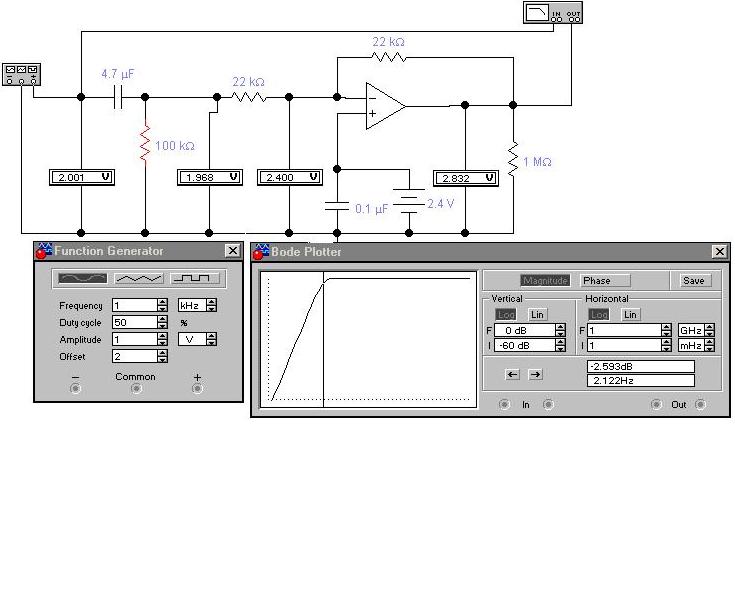

I had a look at the diagrams, all looks cool. But you did not simulate removing the 3.3uF cap. That is where the trouble would come. Espesically with that 10K resistor to ground. Having done that by mistake with a 47K, I can tell you there will be a BIG DC offset.
Pull the 3.3uF out of your circuit and see what you get. Please post the results.

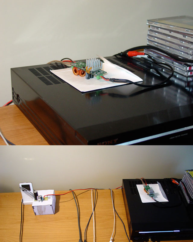

panomaniac said:I have an AMP6 running now that is not connected to ground at all. Everything in the system is 2 wire AC. CD player and transformer for the amp. No noise at all. No case on the amp, either. 😎
Same here, except it's an amp3 😀
It's on top of my CD player, within a foot of my laptop using wireless internet, and three feet away from my halogen lamp and there's very little noise!
You can see the little regulator board on top of a UCD180 box and the amp on the CD player. Not exactly a noise free environment!
One of the curious things I first noticed about the SI is that touching an input induces very little hum - a bit disconcerting!
Panomaniac, you are right. I didn't simulate what i ought to. Here is the simulation with the 3.3uf removed and no discharge resistor at source output. No problem hereI had a look at the diagrams, all looks cool. But you did not simulate removing the 3.3uF cap. That is where the trouble would come. Espesically with that 10K resistor to ground. Having done that by mistake with a 47K, I can tell you there will be a BIG DC offset.
That's correct. Your red resistor is acting as a voltage divider with the 22K input R.
Any pull away from the bias will be amplified at the final output. -12X, I think. Or +12X if you are looking at the output of the opamp.
Right again Panomaniac. The gain formula for the TA2020 is: Vo/Vi=12(Rf/Ri). What is shown as DC offset by the rightmost voltmeter in the above simulations is only the (Rf/Ri) part. This has to be multiplied 12 times to make for the final DC offset present at the speaker terminals.Any pull away from the bias will be amplified at the final output. -12X, I think. Or +12X if you are looking at the output of the opamp.
Verdict: .Do not ommit input capacitor, or strictly follow Panomaniac instructions at post #13 in this thread.
