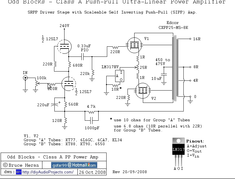

I found this schematic:
OddWatt Audio 5751 SRPP / KT88 Push-Pull Monoblock Tube Amplifier Kits

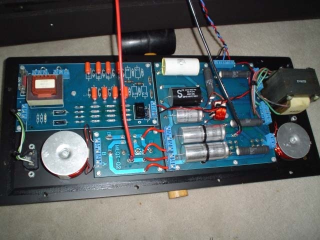

Why not drive the ML panels directly? You can leave the bias supply in the ML electronics and drive the panels directly from a tube circuit. Based on the super duper low impedance at 20kHz, there's probably a big step-up transformer in there. Why step the amplifier output down, only to be stepped back up in the speaker? If anything, you could go up from the output of the amplifier to the panels if necessary, but with only one transformer.
Its a thought and ML might let me have the schematic, but as they are mains powered, it probably would mean major mods.
It could literally be a step-up transformer and a big *** voltage multiplier acting as a bias supply.
Trying this:
I've decided to monoblock this design using a different otp - a Hammond 1650H which has a 6.6k primary and 40% UL taps.
Also I was thinking of using a pair of 6L6GC rather than EL34, or maybe KT88.
Power transformers have 360v 250ma secondary with a bridge rectifier and CRC filtering.
Other photo is of the ML Quest's electronics, and possible similar to the Aeons, so probably not feasible to modify them.

Yeah, so those electronics are a crossover, a voltage multiplier, and a step-up transformer. I would absolutely modify them!
You think you'd really need 40 watts output power from a true class A PP amplifier, so you'd need a pair of output tubes with a plate dissipation ration of 40 watts at least - per tube.

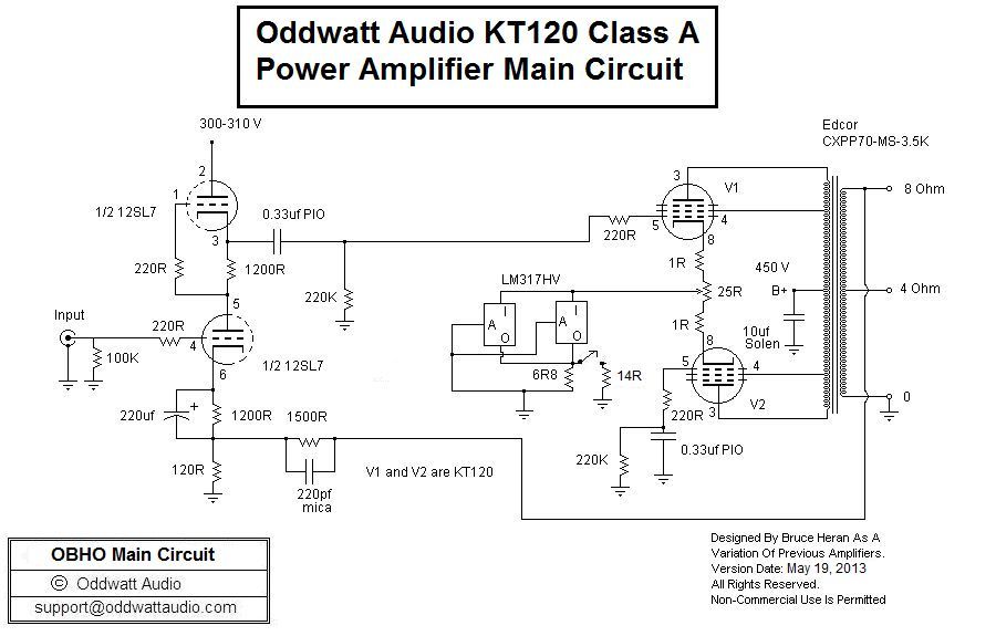

Since the basic circuit is one of mine I thought I would chime in. Swap the output transformer for a 3.5K one with at least 300 (more is better) ma balanced dc current capability (the Edcor 70 watt ones are fine). Then swap the tubes for KT120s. Parallel a pair of LM317HVs. They work fine in parallel if from the same lot. Many such arrangements are in commercial and diy amps we put out over the past 6 years. The schematic I attached shows two separate power levels for the tubes. Approximately 25 and 40 watts RMS. If all you want is the higher power use a single 5 ohm (4.8 calculated) resistor. Be aware that there are some Tungsol KT120s flying around that were made about 3-4 years ago that do not meet spec for continuous dissipation. Some barely handle 60% before red plating. Send any such ones back to the seller. I even got some directly from the US importer. PSVANE KT120s are not suitable at this dissipation as well.
Possibly. A pair of them will yield about 36 watts in PP class A mode (plate voltage 300 V, plate current 130 mA, plate to plate Z 4 kohms).
Many thanks for the info.
I have already ordered a pair of Hammond 1650H OPTs with 6k6 primaries so what would you suggest for V+ and CC resistors and tubes?
Mains transformer is 360v 250ma, 6.3v 3.2a - per channel. A pair of 6L6GC or KT77+ an Ecc83, is just possible for the heaters from this transformer.
Actual power into 6r is not that critical provided it's around 25w minimum, but more would be better.
Hi, Unfortunately you aren't going to get the 40 watts you wanted. The B+ will be too low (the design uses 450 as a target voltage). The current available will be on the short side as well. However, my personal favorite for similar amps is to reduce the current to about 65ma per tube in class A U/L and have a 425-475 B+. This could be in your range of gear. Using solid state rectifiers and capacitive input filtering it could work. Your output trannies while not 8K would be almost in the range that seems best. Such amps would deliver about 20 watts RMS and sound really sweet. On the power remember that the "loudness" is not a linear function of power input. So half the power is not half the loudness. You might not even notice the change.
