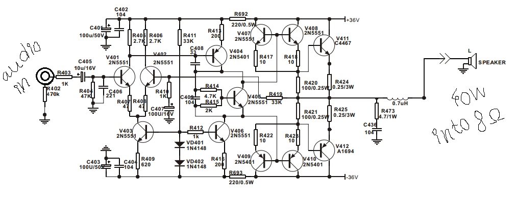

Looks fairly standard topology.
Except pairing of driver transistors, I haven't seen that before, they usually just put in beefier single transistors.
Yes very standard apart from the doubled-up drivers. Probably easier and cheaper just to use a pair of TO-126 drivers, and that way you can eliminate the four current sharing emitter resistors.
What's the Vdrop across those rail filter resistors? 40W seems a little on the low side for that topology with 36V rails.
I think the 40W/8Ω limit is in line with the limitations of 2N5551 - even 2 of them, since they can only dissipate 1W between them, with no heatsink. I think a 70W/4Ω rating is just being hopeful, even using good, high gain output transistors like those Sankens.... they usually just put in beefier single transistors.....
In manufacturing, a pair of T0126 transistors is more expensive than all those resistors and 4 cheap TO92 types. This design is obviously about cheap but I'd say it was unwise for DIY. A complementary pair such as BD139/40 or 2SD669/B649 clones with even small heatsinks will be more robust and handle the typical mistakes made by experimeters.

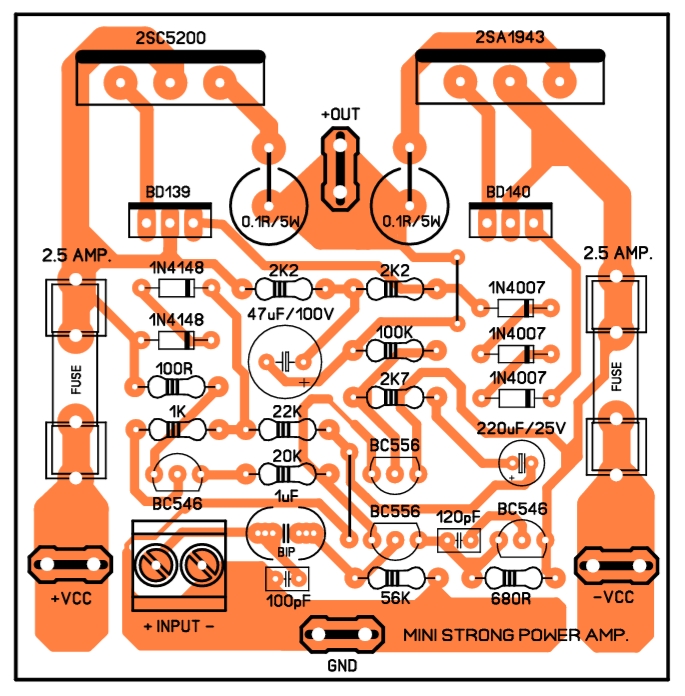

The "mini strong" design also has a terrible PCB layout. Just look at where the + ve rail supply connector is - right next to the input terminals.Simpe amp to diy
Guys, sometimes you have to use some knowledge of electronics and basic electrical theory rather than aim for geometric prettiness or convenience. There are electromagnetic fields around the conductors and the higher the peak currents, the more noise and distortion arises from gross layout errors like this. In fact, it's more important to audio than simulations, PCB software or all your graphic skills.
