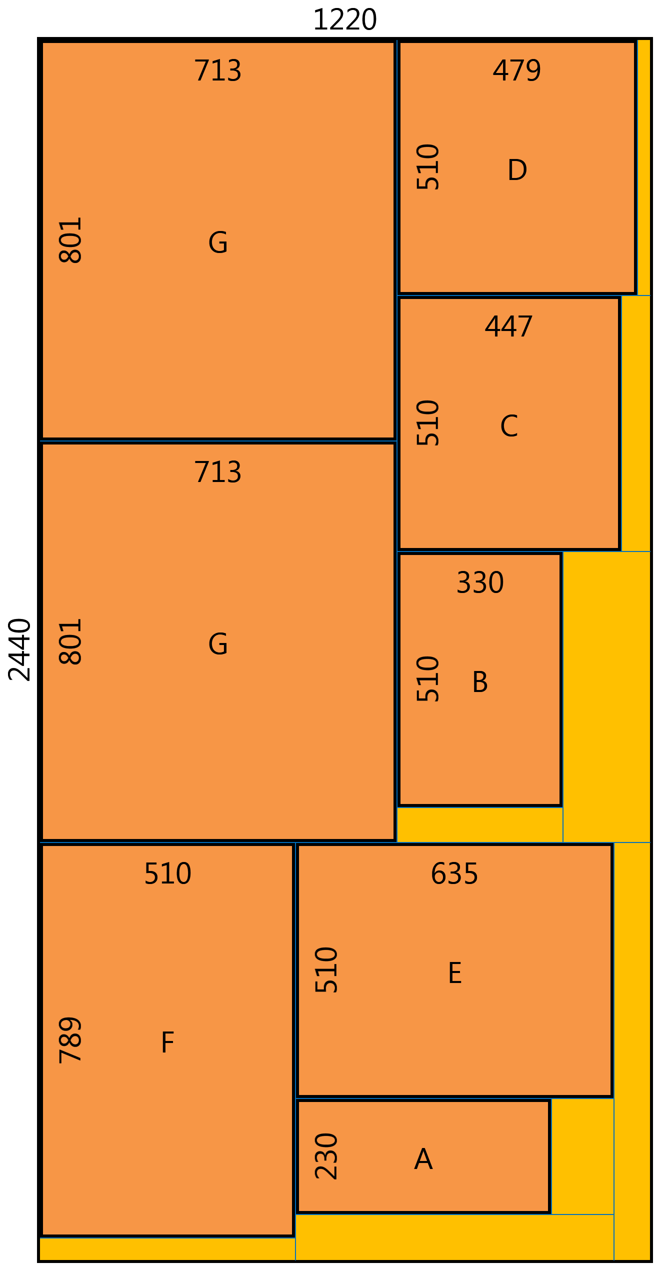

Here are my Hornresp inputs, i have meassured my own set of Thiele-Small data after some break in. (its not that different from the manufacturers data)
My goal was to hit 100dB's @ 40Hz, and i think i have done that.
Black trace, 4cabs - grey trace, one.

That looks great - terrific job!

So the speakerplan for this cab that you previously posted, that´s the one I should follow if I want to build it? There´s no such ''reflectors'' in the corners?
Thinking of actually building it, so I want to be 100 % sure.
Thanks!

They are playing now as per plan in this tread.
I'm not convinced about the effect of reflectors/deflectors, but i dont think they will do any damage.
I do recomend a center bracing throughout the pathway, i'm going to innstall this in the cabinets i have now and in the new cabinets i'm going to build.
With Lab-15 as now i have to say they are impressive, lots of 35-40Hz bass, much more than frontloaded cabinets.

You don’t have to convince yourself because they can not act as 'reflectors' or 'deflectors' 🙂.In case they are applied in a section between bends they can suppress dips and/or peaks that are related to a specific frequency (distance between corner correction and driver and/or distance between corner correction and mouth and/or distance between two bends). This effect is often confused with reflection.
The only functions they have:
- Corner volume correction.
- Suppress flexing of the panels.
- Prevent standing waves between parallel walls.
- Enforcement of the corner construction.
For an object/surface to become acoustic reflective the diameter of the object needs to be 1/4WL of the frequency they are reflecting:

Hi Djim
I agree for the most part.
Standing waves are a very complicated area as you dont get rid of them by putting a 45 degrees bend on oposite walls.
Maybe on short wavelengths, but not in this horns passband.
I have measured with and without corner reflectors in a FLH i build a few years ago, and it did certainly flatten the respons, but only high i frequency.
Perhaps its different in Tapped horns!?
BUT... i guess my best explanation is sheer laziness!🙄

Hi Dag,
For Tapped Horns it’s no different. If you use corner correction in TH’s you can influence the harmonics in the upperband response, depending on their position within the horn (distance versus frequency). You noticed yourself you can’t correct low frequencies with them. If you want to use your TH below 120Hz you don’t have to use them at all. Actually they can make the low en a little worse since they take away valuable Volume of the system.
