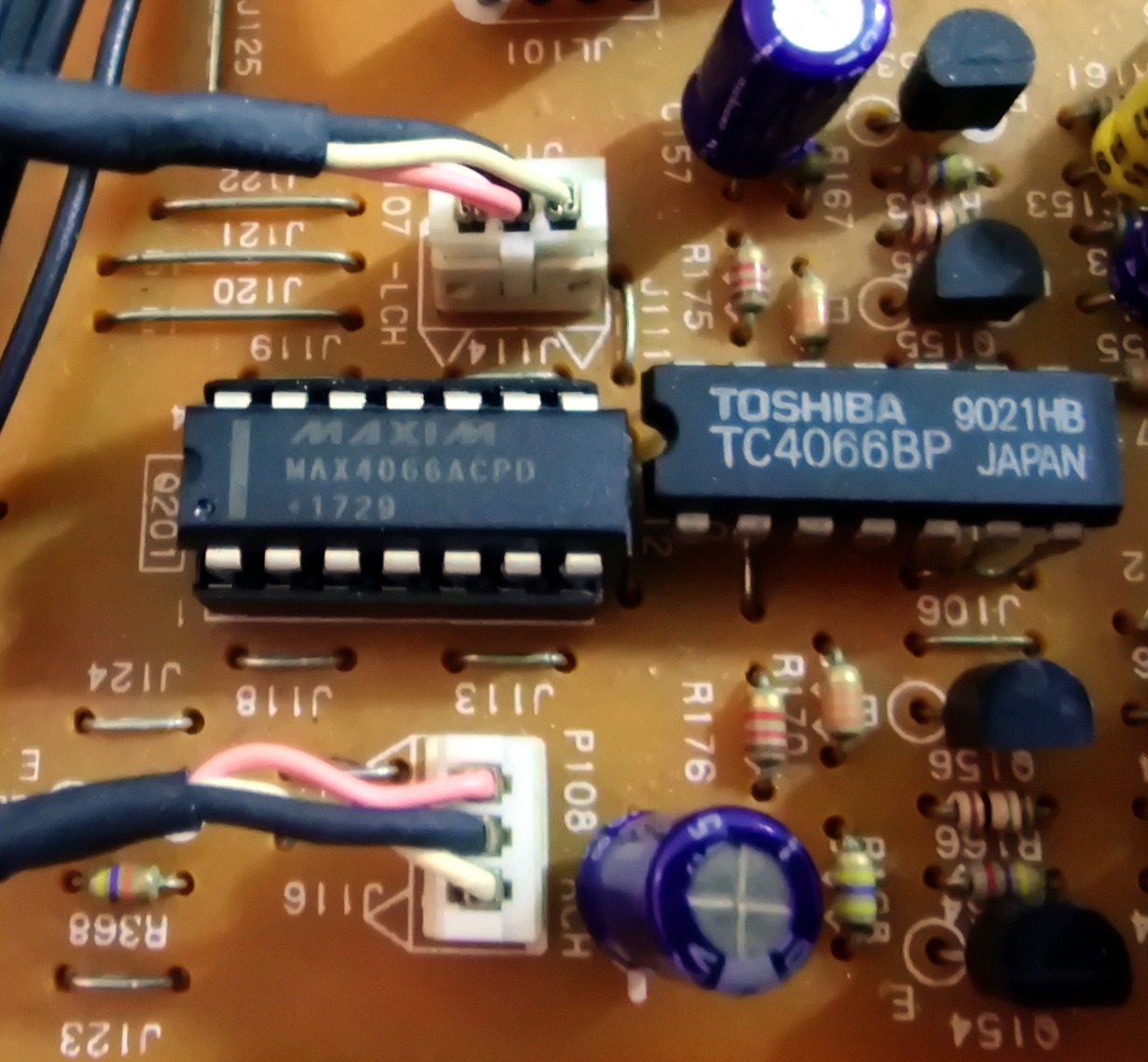

Maybe was this one? The MAX4066? 45Ω 0.03%. I used it to replace the old 4066 in my Onkyo cassette deck and it made a perceptible difference. Runs at 16.75V across rails there.I recall that some years ago someone mentioned a pin compatible chip with lower on resistance, higher off resistance and lower distortions than a 4066. But sadly I don't recall neither the chip designator nor the manufacturer anymore.

@Salas: Yes, MAX4066, that's it. Thank you! The reason for my question was that I'm planning to modify the Great manual of my old Hammond C-2 organ to have either the stock 8´ tones in the lowest octave or true 16´ ones when the 16´drawbar is pulled. The tonewheel generator's output signals are lowish, in the few millivolts range, and the tones are mixed by a low impedance »matching transformer«. Hence the switches need to handle very small signals, without adding significant impedances into the signal chain.

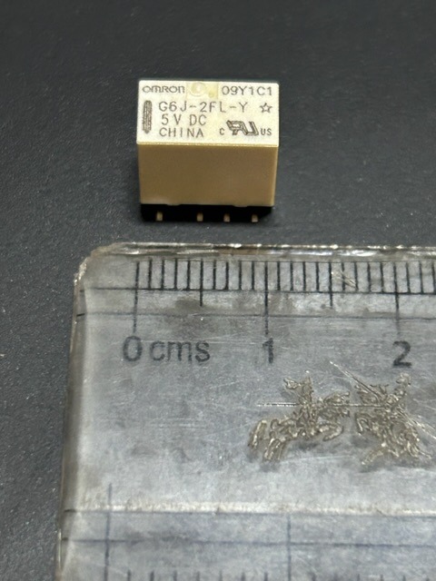

Anyday 👍Try micro relays. Nothing wins from good mechanical contacts. 4066 based devices sound mediocre at best. A simple test can quickly reveal this.
Sure that some relays can fail even as source switches but at least they don’t put such a large footprint on audio quality.
