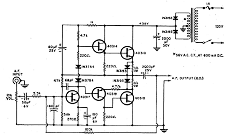

The 40310 is very similar, and RCA had published an app-note for a plain-vanilla 10W amplifier. It sounded OK at the time (>50 yrs ago).
I probably have a schematic somewhere, if you are interested.

Well found: that's exactly the one. By today's standards, it's lacking everything, but it did work quite well, and when I retired it for an upgrade, I passed it to my cousins, and they too enjoyed it for a few more years

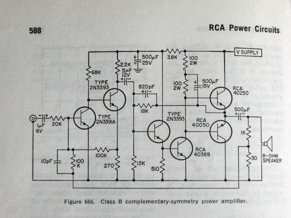

From the "RCA Solid-State Power Circuits Designer's Handbook" (1971), here is a class B amplifier with the crossover notch "fixed" by negative feedback. This is the amplifier that gave early solid-state a bad reputation.
It is a do-not-build. 😉

The RCA book says 1% THD... but it has every odd harmonic. I suspect this amplifier was used along with old speakers that lacked tweeters.
