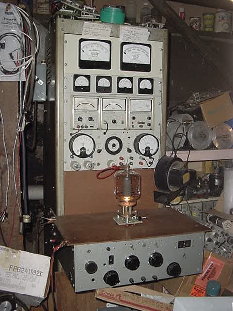

I took them to a broadcast/industrial tube place in Northern NJ around 1980 and he had a Franken-tester he built for large tubes. He did what he called an 'emission test' (?), and rated the 3 Amperex tubes at "95% emission", and the Siemens at "80%".

That would be JFF Research in Nutley which was run by the late John Fikus who was a good friend of mine. Two of the custom rack testers now reside in my basement after being rebuilt by myself. The one shown is a universal class A tester capable of 1500 watts dissipation. All elements are monitored and transconductance is measured at 1000 hertz. Sockets are interchangable plug-ins. Shown is the 5868, big brother of your 5867s

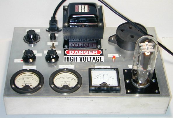

I initially was going to do a RF project, then thought about audio, but it just doesn't seem practical to me...but I don't always try to be practical.
I also have 4 of these tubes with two sockets. I have been saving them for a project that will never happen. I have several 833A's also. I found out when I decided to try an 833A SE amp that the OPT is the hard part not the tubes. There is also a little matter of about 1KW of heat energy that must be disposed of. This is a real problem in south Florida. I could be open to interesting trades for either tubes.
Now I need to whip up something similar to test some 211 with..
I thought that this was easy, just use my amp. Transconductance could be measured by varying the bias voltage and watching the current meter. Everything worked fine until I found an extremely gassy 211. The purple lightning bolt shot through the tube slapping the current meter needle all the way over (300 mA) and zapping the life out of the mosfet driver.
Hi George,
Yeah, I haven't built the amplifier yet - still scrounging around for the parts required. I'm going to use my isco 494 to provide plate voltage and either the lambda or a heath supply to provide the bias. I have enough meters to measure plate voltage and current along with the bias voltage. (May also measure grid current.) Hopefully I will not have the lightening bolt experience... I have a couple of VT4C and will be getting more in return for testing a whole bunch of them.. I just need to find a 10V -3A filament transformer and I'm good to go.. I'll take a couple of measurements and calculate the transconductance.
Definitely use a microammeter in the grid bias circuit to monitor current as this indicates any gas present. I use a 200uA movement with back to back rectifiers across it for protection.
The acid test for general condition is to lower the filament 10% under test and watch plate corrent. A good tube will not move very much at 10% down. Only a few percent. If plate current falls a lot and acts "spongy" as the filament drops, the tube is weak and is near (or at) end of life. There is no fine line regarding plate current fluctuation with this test. It is a judgment call that will become evident through continued testing. You develope a mental and visual curve.
I measure transconductance by amplifing 1000~. I feed the grid with 1 volt rms, and measure AC signal in millivolts across a 10 ohm resistor at the negative side of the plate supply just above ground with an HP 3400A. (1mV=Gm of 1000)
You will need a well filtered supply to avoid measuring hum. In my setup I wanted the plate supply to fall rapidly when I shut it off for volume testing. So I use minimal filtering and bleeders. Because of this, I measure the output across the 10 ohms through a narrow 1000~ bandpass filter. (A UTC BMI-1000) This filter has a very high Q which raises the the voltage at it's output, so I must lower it to the correct level with a 10K 10 turn pot.
Regarding gassy tubes, yes they're out there. I've learned to raise the plate voltage up slowly to avoid whacking everything. This is also why I use simple unregulated supplies.
As a aside, there's a seller on feebay that uses a small tester to help sell tubes. I dont know the particulars, but it looks cute, so food for thought.
